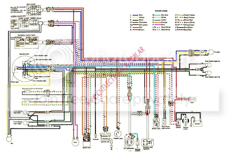

I am working on an 1980 SR250 right now and I cant get any spark out of it. I have tested everything as listed below and it all seems to check out fine.
Here is the brain fart. Without pulling any other bikes out of the shed and buying batteries, testing, etc...
The coil has +12v at the Red/White wire ... but also has +12v at the Orange wire. Both are always +12v. Is that normal? I would think the Orange wire would see pulses from the CDI, not be a constant +12v. Have I found my first officially toasted CDI?
Do the pickups need some sort of voltage fed to them? Usually done by the stator... Which does show DC voltage out of the R/R when cranking the bike so I figured this was all good.
Coil Primary: 3.5 ohms
Coil Secondary: 26,000 ohms
Pickups (G/W to R/W): 700 ohms
Good grounds
CDI has +12v @ Red wire

Wiring diagram is too small for me to see properly. If you have service manual it may have basic CDI tests?

The harness has been chopped to fit the new electrical I am running so its all 100% fused, soldered, and shrink wrapped well. Connections should all be rock solid... key word... SHOULD, I will check this first thing tonight.
Any chance someone has some insight on weather or not I should have +12v on both the "+" and the "-" side of the coil?
