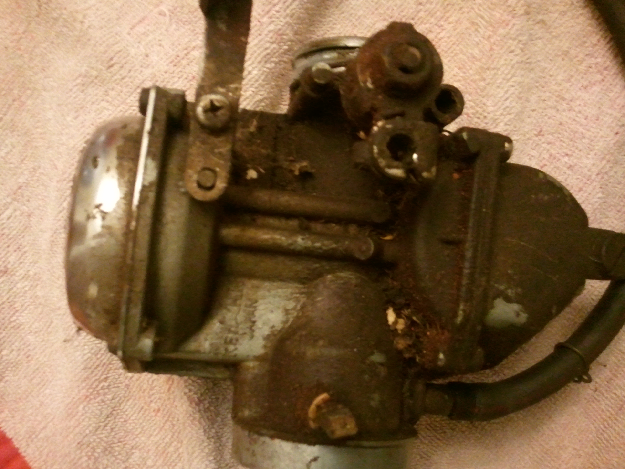

I pretty much only have time to work on the bike on fridays and weekends, but last night I had about 15 spare minutes, so I pulled apart the carbs. I knew they were going to be bad, but the left was worse than I thought. I've never seen one in this poor of condition.
The right side bowl wasn't bad, standard for an old machine, but the slide wouldn't move at all, so I couldn't get much out and apart.
The left was completely encrusted with that white crap that ends up in carbs. Not sure exactly what it is, but I'm guessing it's from water. Nothing would move in this whole carb.
Hopefully, my awesome dip tank will take care of it. Yep, 2 gallons of pine-sol in a five gallon bucket. Luckily I have a lid for it, this stuff is extremely stinky, the wife would kill me otherwise. Of course I'd love to leave it outside if it wasn't 10 freaking degrees here this morning.
So, the carbs will sit in this until Friday. I'll pull them off then and see what I have to work with under the crud.

Those carbs do look rough. If you have any issues and need to replace them let me know. I have a spare set Id get to you for a good price.
Those carbs look like mine did when I looked inside. Mine were actually a little worse, the aluminum oxide was so thick it was actually pushing the bowl off the body. After I cleaned them up I found a pinhole in the bowl so check carefully. I also found that the seats for the brass were too far gone. Into the spare parts bin. I ended up with a new set. I would take up Gijoe on his offer...nothing will make you happier than a clean set of carbs.
Keep us posted on the Pine Sol soak. I have to go buy a jug of it myself to soak my TM34's.
