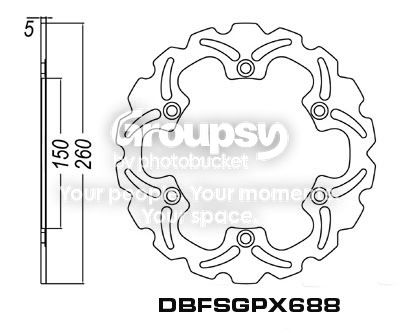

This is an EX disc:
OK - it's an aftermarket wave pattern, but the important thing is that it is a one piece unit that solid mounts to the EX wheel spokes (or outer hub). Your CB disc has a carrier that bolts to the hub. Whether you can take the rivets out of your CB disc and mount this....I don't know.
Just had a look at your build thread - looks like your CB disc carrier has about 10 rivets as opposed to 6 bolts on the EX so it ain't gonna work.

Thanks for the picture as a reference Hill! I think it will mate up, I just need to get one in and see. They are not that expensive, I will get one off ebay tonight and let you guys know..
