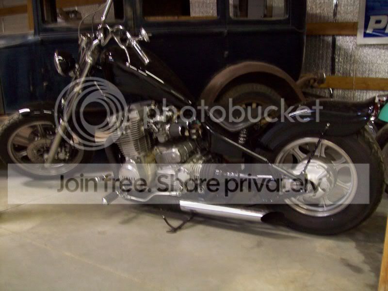

well ill chime in again, as some of you know we build choppers, bobbers, all sorts of stuff...matter of fact a xs1100 chopper/bobber only we did somethin a little different...used the front end and mated the rear shaft of the kawasaki buecause it has a bigger beefy rear end...and let me tell you this freaking thing flies...
we call it the cash bike kuz its all black, or the yamasaki...ill get some pics up tomarrow when i find em or snap a few..
First, that's shit hot.
Second, how'd you mate a kawa drive shaft? Did you have to cut splines?
Third, Is that a sporty fender shoved forward? I like that look.
Forth, did you weld a new backbone, or is that tank cut for two tunnels?
Nuff questions, thanks for posting it. The xs1100 motor is a beast for being 30 years old.
