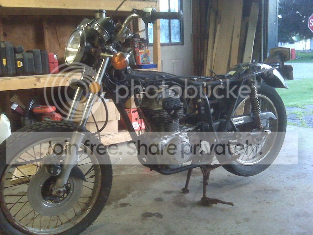

I've used this website for a great resource over the last couple of months as I've done research for my first build. Now that I've got a lot of things worked out on paper, I would like to share my build with the rest of you and hopefully return some of the insight I've taken from here. This will not be a high dollar build, I have no access to cnc's, lathes, or many shop tools I would like to use, just the standard resources most of us have. I also, just relocated from just outside the great Motor City, to the middle of nowhere Kentucky. So, I have even lost a lot of the resources I once had. The main resource being my own garage. Apparently there is not as much of a need for garages in KY as there is in MI, for obvious reasons. So, don't laugh when you see my workshop. It's pretty, but it works.

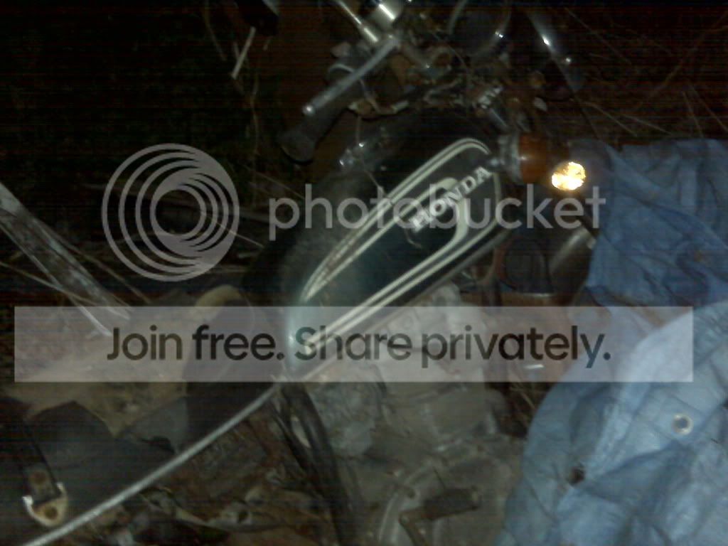

Here's where I pulled the bike from. (Cell pic)

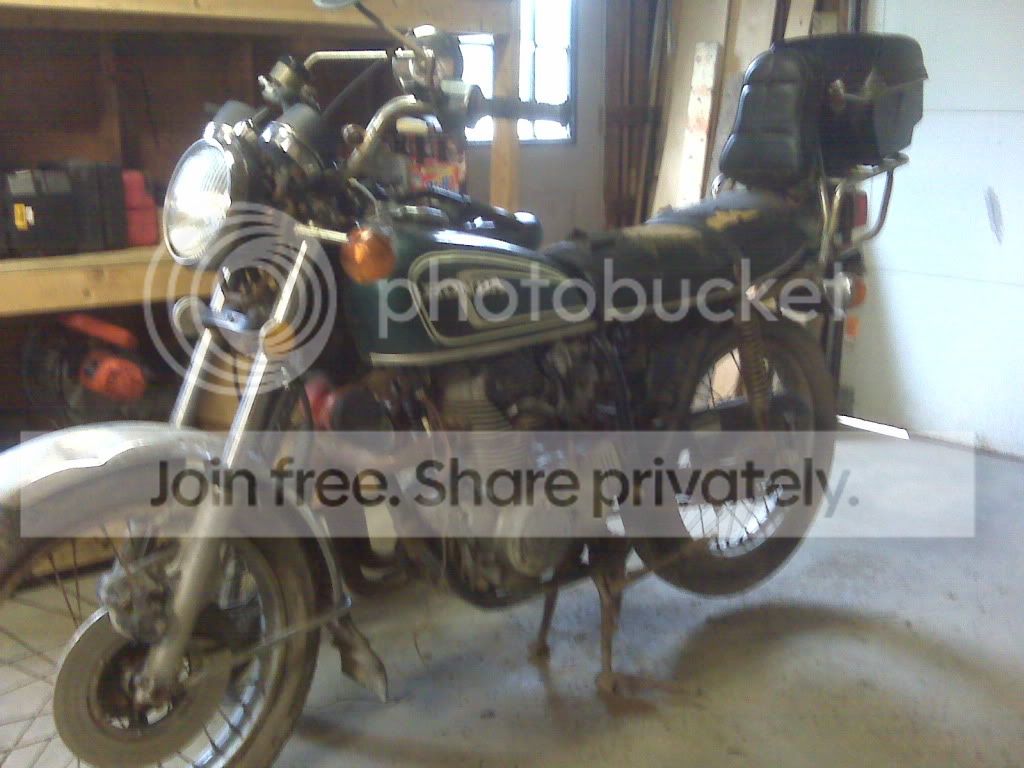

In the MI garage.

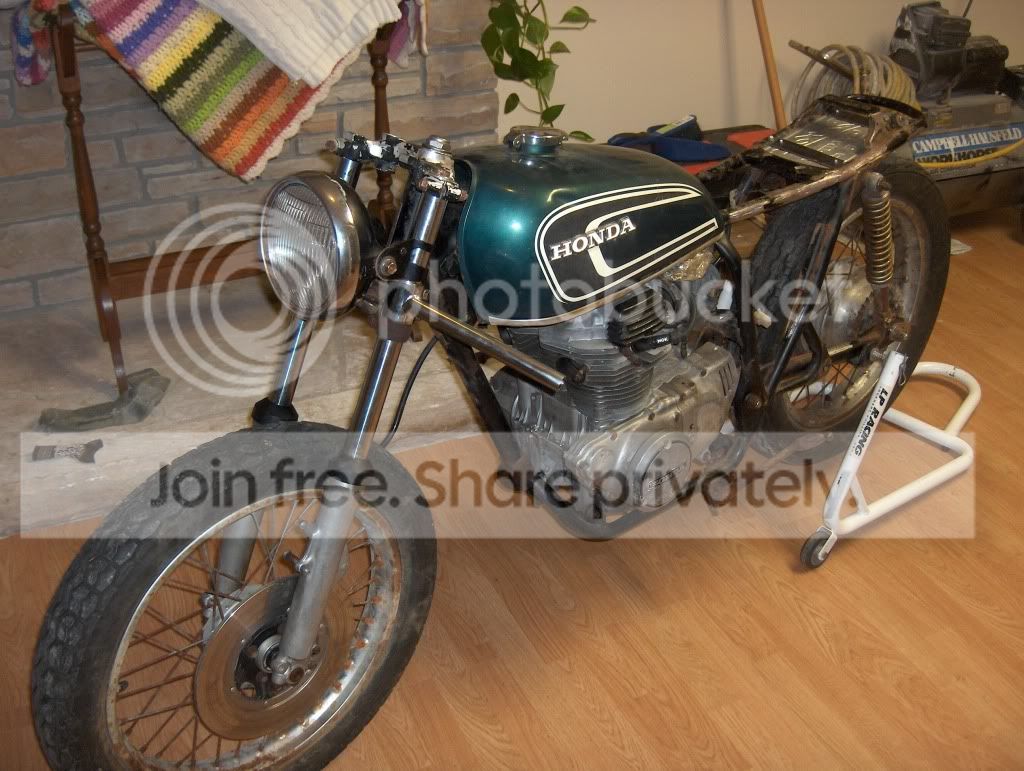

Is that your living room!? ;D My wife would die lol she's such a neat freak. Nice find and start so far. I'm diggin the stance. What are the plans for colors? Keep us posted!
My fiance and I are renting a split level house, so that is the lower level. She has a hard enough with that. Living room.....no way!
As far as colors, I don't want to say, because I haven't thought about it too much yet. Right now just getting the function side of the equation is challenging enough. Word of advice for any youngsters out there....Never get engaged and start a project at the same time. If she loves you, she won't leave you, but that bike is just gonna keep on rustin' away!
I have to say I'm jealous. I wish I could work indoors but all I have is a carport to work under and not enough lighting. With my work schedule now I get about an hour of daylight to work on my bike.
That's quick work house training that beast that fast. I asked my wife if I could move mine into MY office and got the coldest GO TO HELL look evar. :mad: sheesh women :eek:

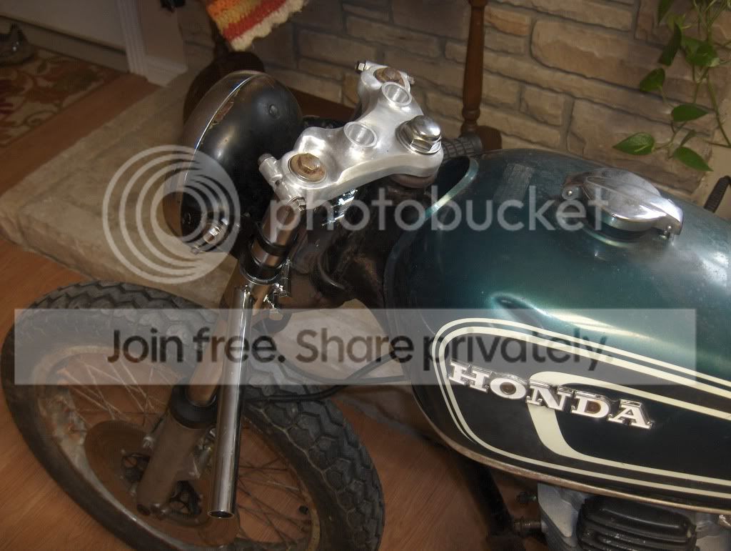

Got some triples in the mail the other day (thanks JustinLonghorn).
Stripped them with aircraft stripper from autozone.
Just went for a brushed look.
Old's and new's.

Haha, your build looks a lot like mine... Done in the house over a fine quality rug! ;)

them sure are some purdy triple trees :D everythings looking good so far. still jealous, it gets cold at night
-Slice
HA! 66replica has some pics of his bike sitting in his living room as well.... deny us not our passions, oh housing gods...
