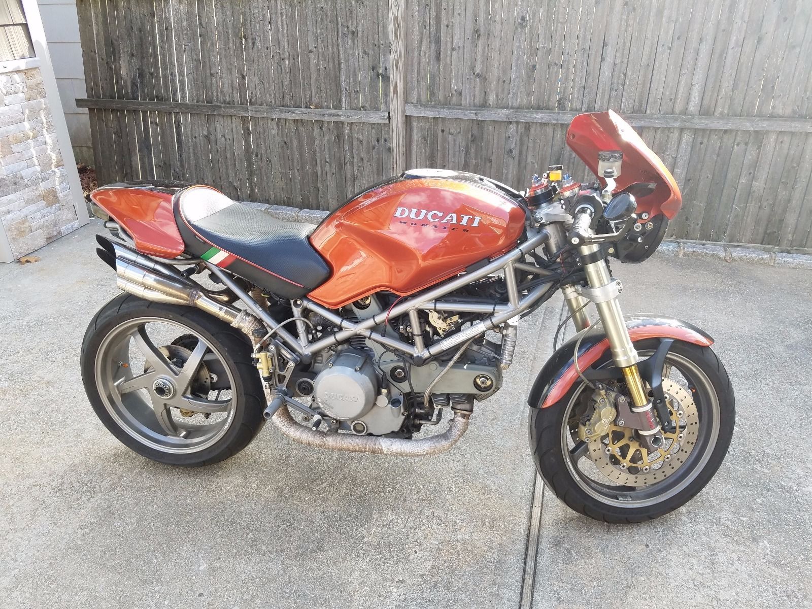

Well, picked up this Mish mash today, and I'm not sure what to do with it. Runs good, operates well, needs a better exhaust, and I don't know what else to do with it yet. I'm open to idears! FYI it's a 2002 monster 750 with a 748 front clip and rear end. So do I call it the 749?

Don't call it that, it is better looking than the Ducati 749

What up with that exhaust? Got any other pics? I have never seen anything like that.

Lol!I didn't know that was a bike. Come up with a name. It's actually nicely done, someone put good work into it at some point.

It's straight pipe and loud as all hell. I was looking for cops the entire ride home makes me nervous I don't like it. I'll take some for you on Monday.

When you've replaced the pipe, plus done something about that headlight and screen, just ride the wheels off it!
