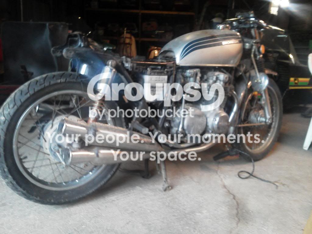

Here is the bike pretty much as i got it. gotta love the good ol king queen seat haha

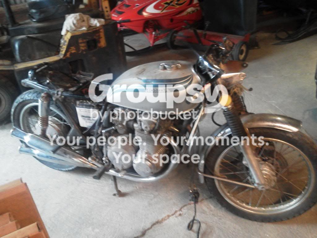

and here are a couple just pulling the seat and bars off and putting a set of clubmans on (clubmans arents staying)

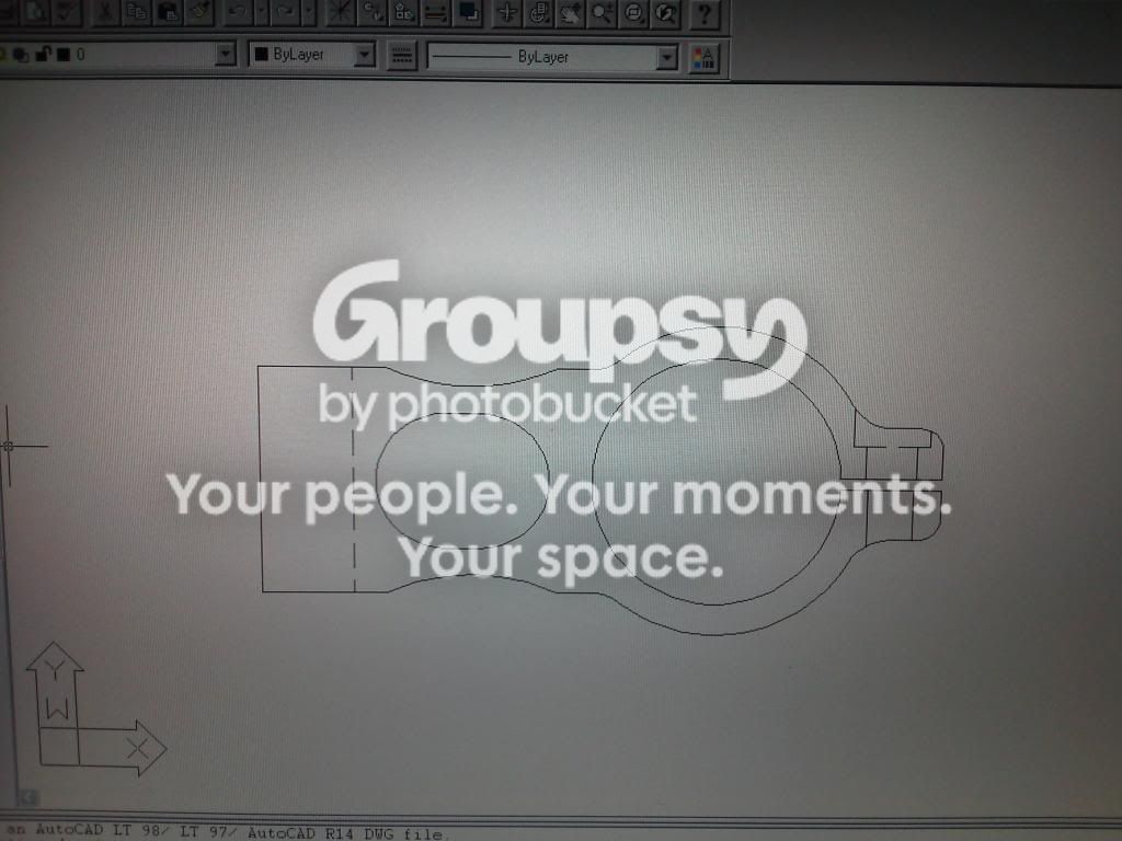

and here is just a pic of the computer screen while i was drawing up a set of clip on clamps on auto cad. should start machining on stuff soon
