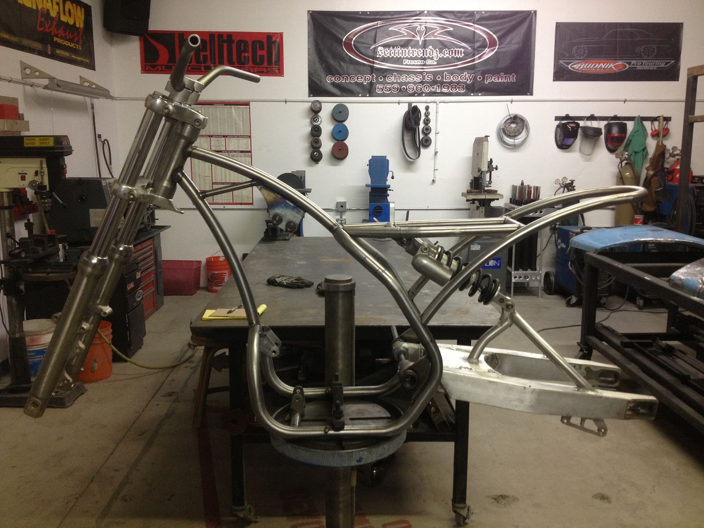

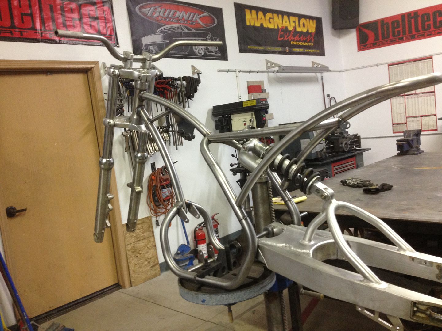

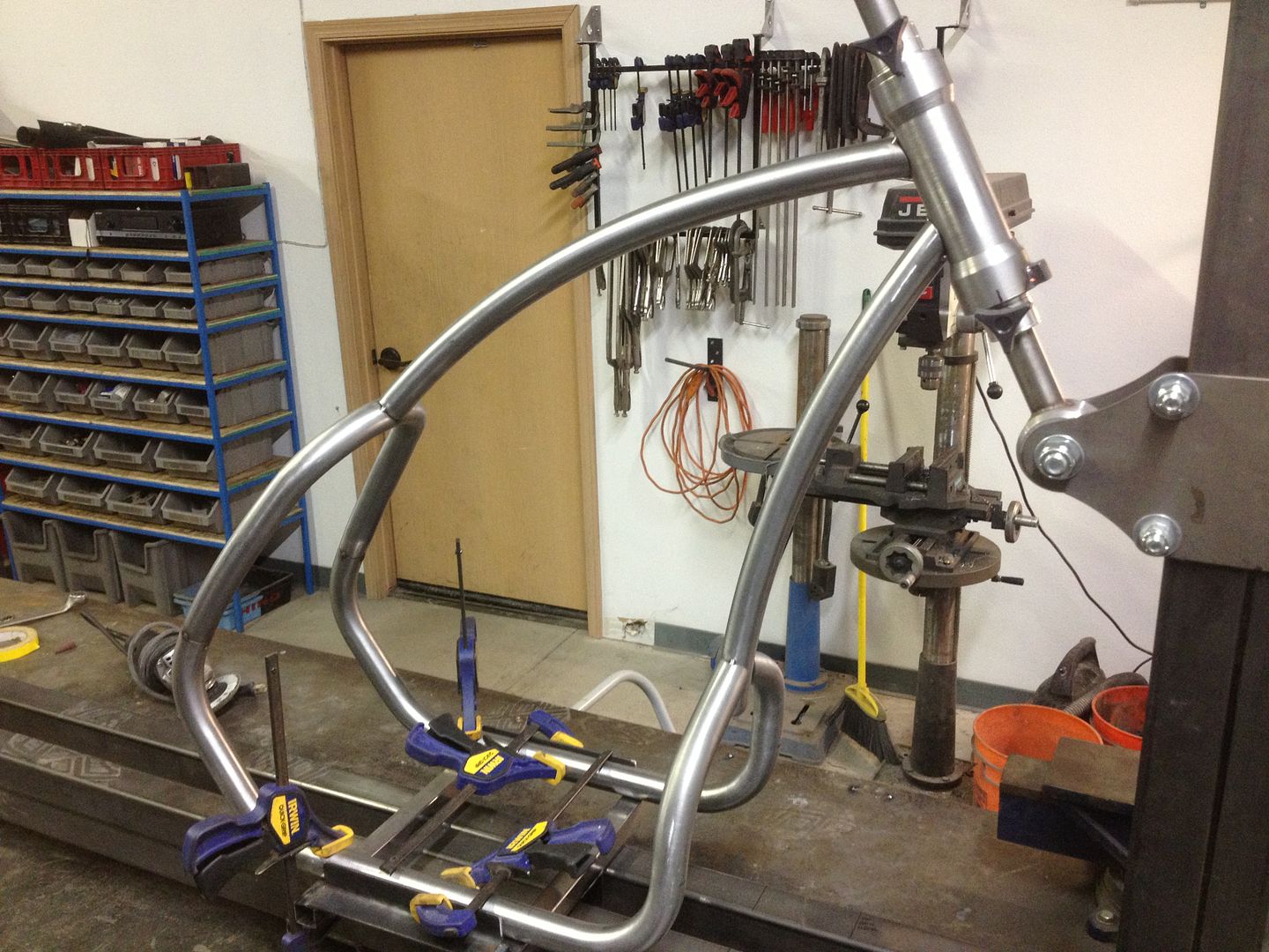

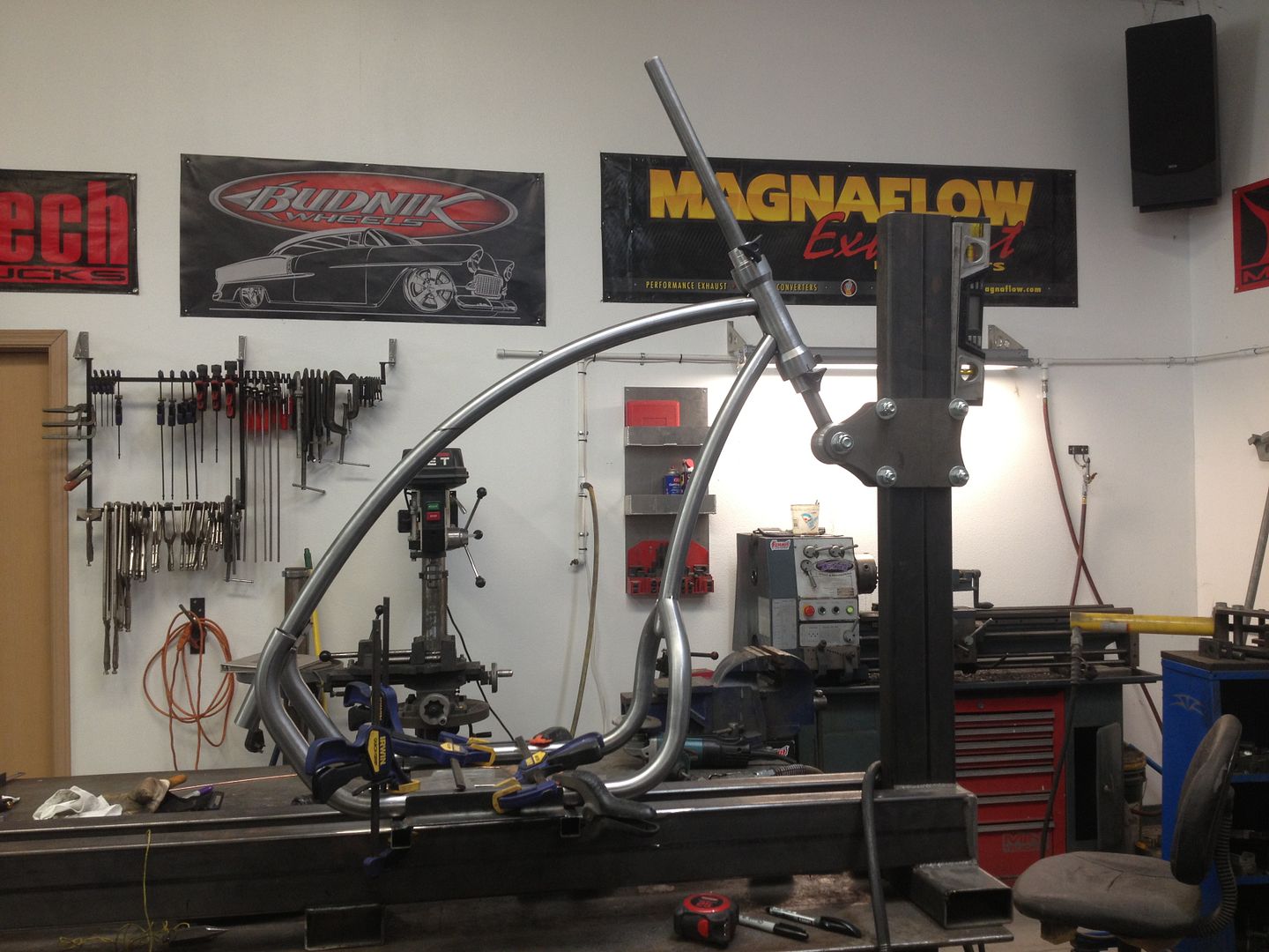

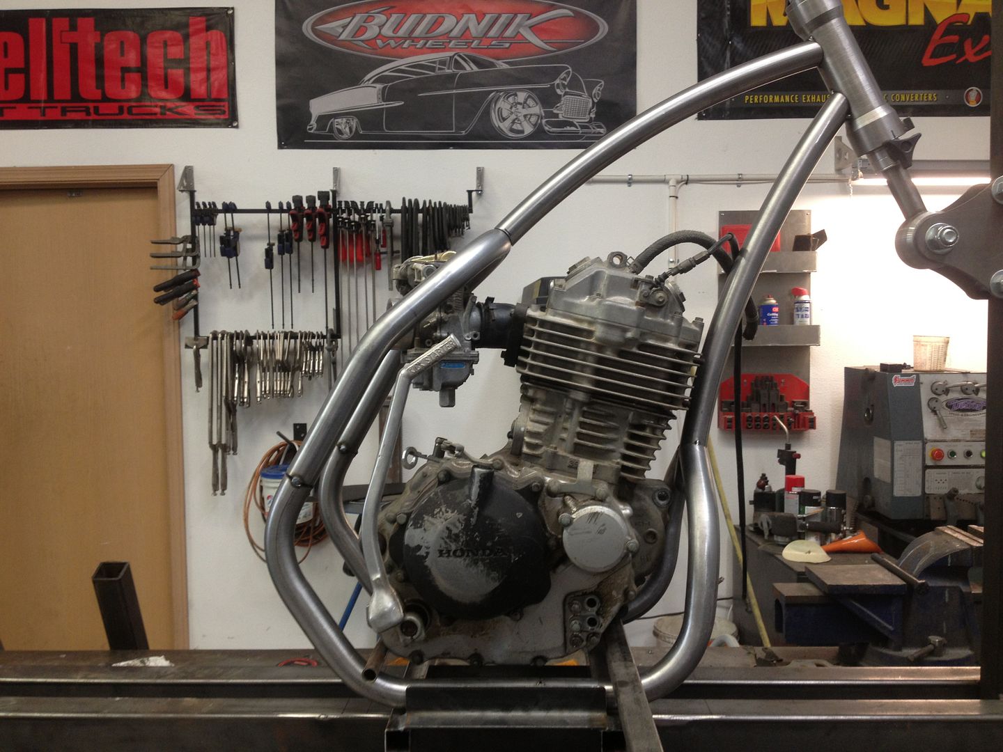

Frame taking shape
Comparing those last 3 pics with the following, you'll notice a couple modifications. 1) I took a couple inches out of the overall length so it fit tighter around the motor. 2) I raised the wishbone/ seat spars where they meet the top tube for better clearance around the carb.

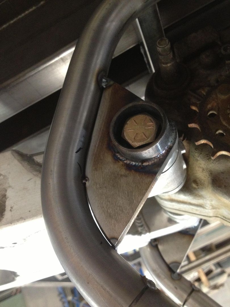

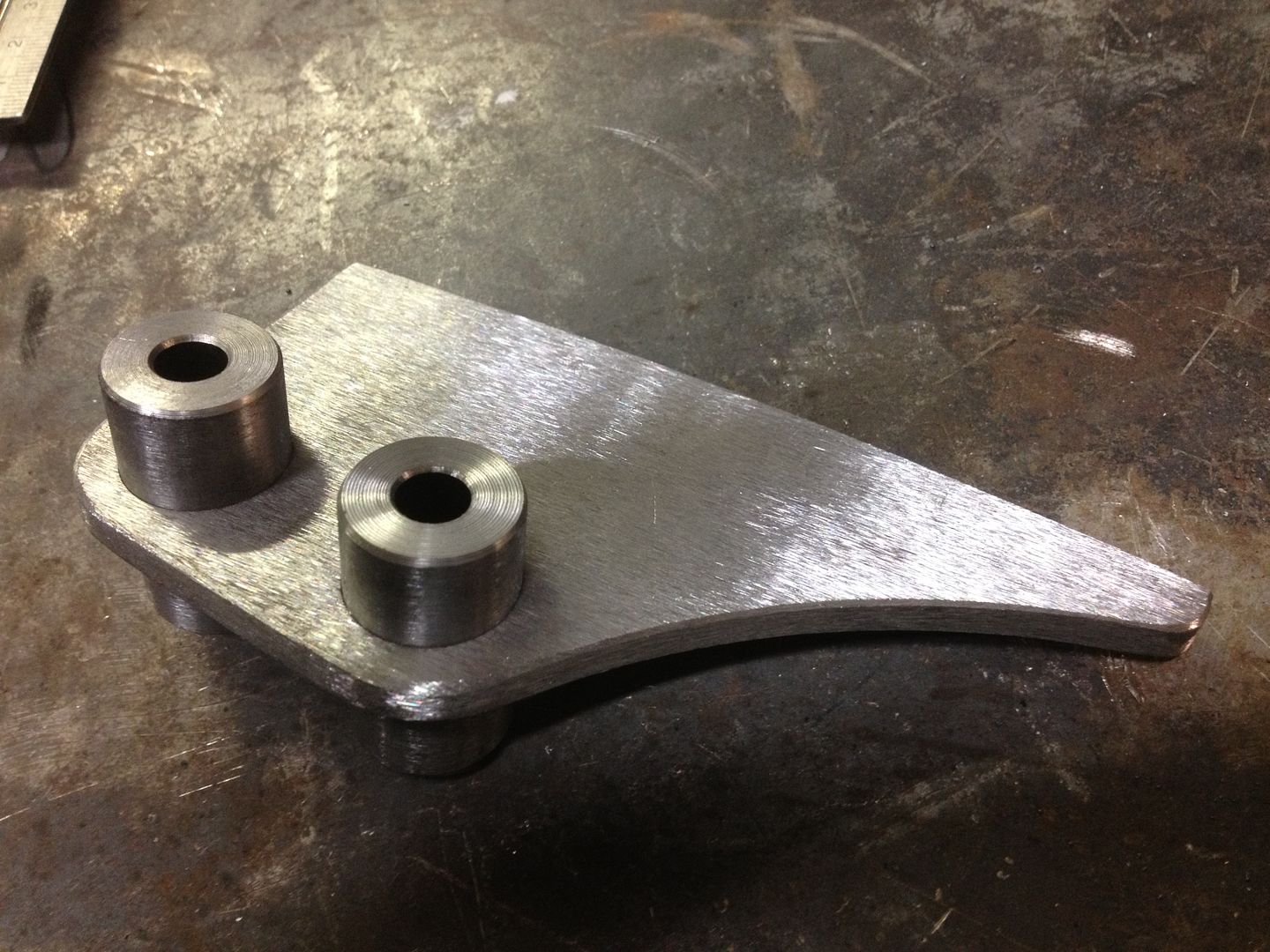

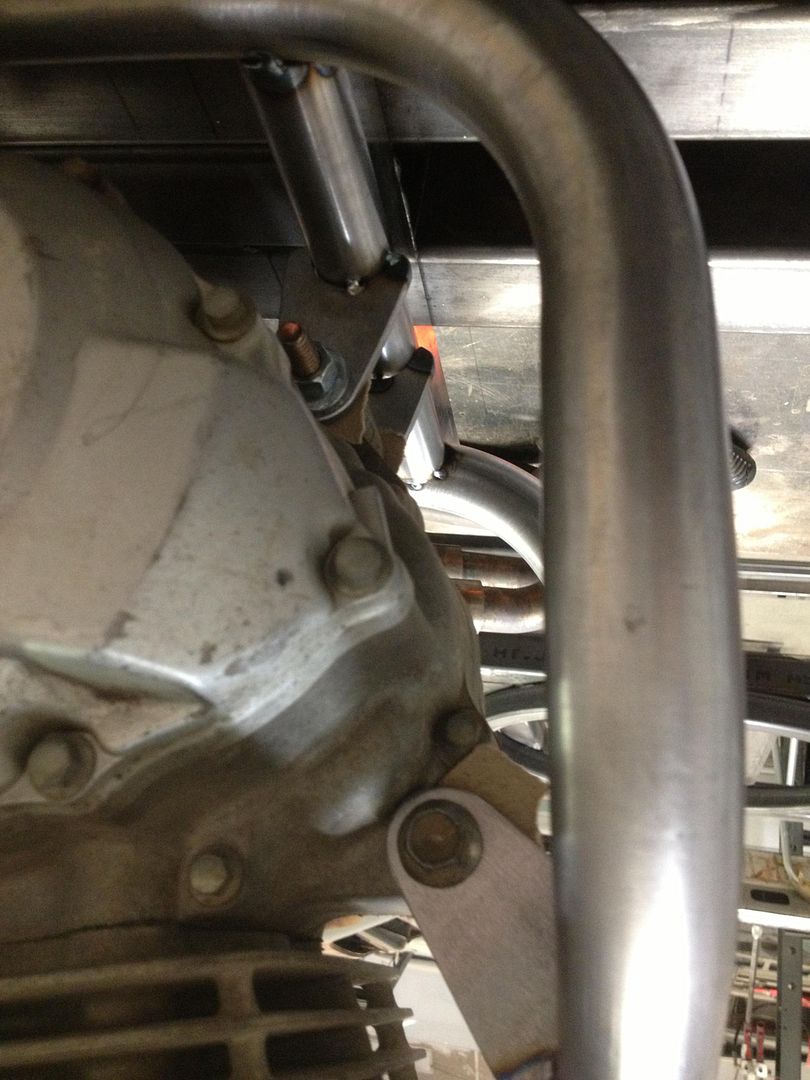

Really like the coincident swinger pivot and engine mount. Any chance we could see how the assembly works? I'm presuming the engine (or at least its mounting bushing) is rigidly bolted to the frame, so I am wondering what sort of bearings/bushings and shimming you are using for the swing arm. Looks like it could be a bit tricky to get it all together and shimmed properly, but its great how close the pivot is to the drive sprocket. Is this the original scheme used for the XR?

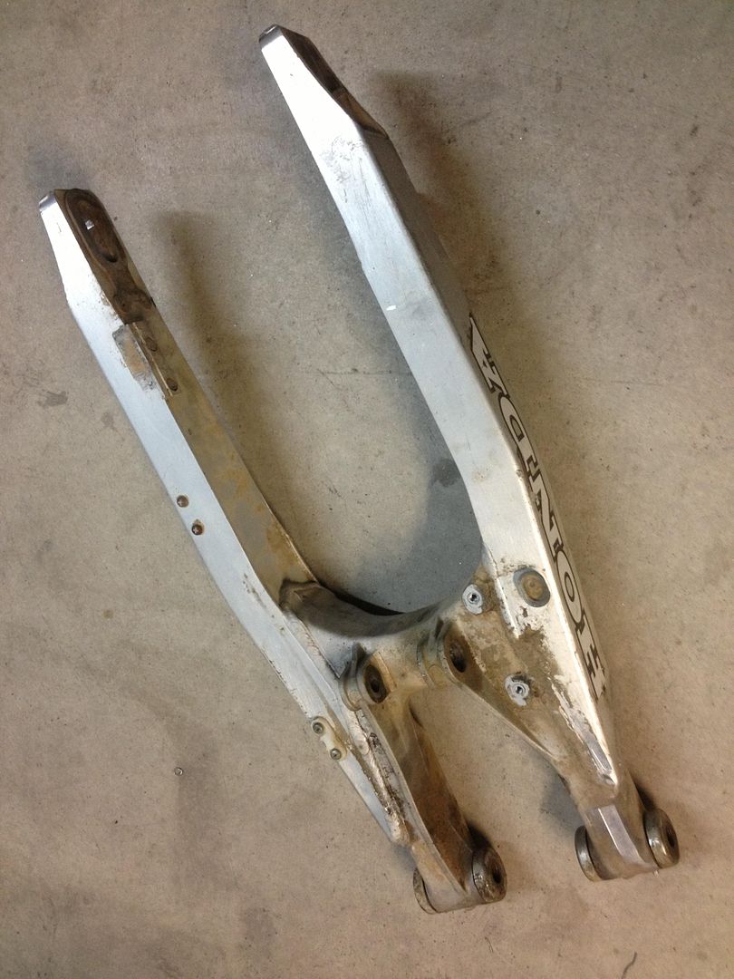

This is the fine specimen of an MX swinger I have chosen. It began life on an 87 CR125.
I started by chopping the linkage mounts off, then widening it by .625". What you see welded here in the center ended up wrapping all the way around the cast section to hold the space while in the fixture.
Then I boxed the entire cast section and added the hoop/shock mount.
Yes, it is the original design of the XR, as it is with most off road/ motocross bikes due to the high travel numbers. And yes, the motor is solid mounted in the three points outlined above. Like you said, sprocket close to swing arm pivot. That of course limits chain slider wear as well as keeping chain tension fluctuation to a minimum, without the use of a tensioner. And although the swingarm I used is not an XR unit, it works the same way. Ill take a close up pic of the bearings/ sleeves/ seals the next time I have it off.

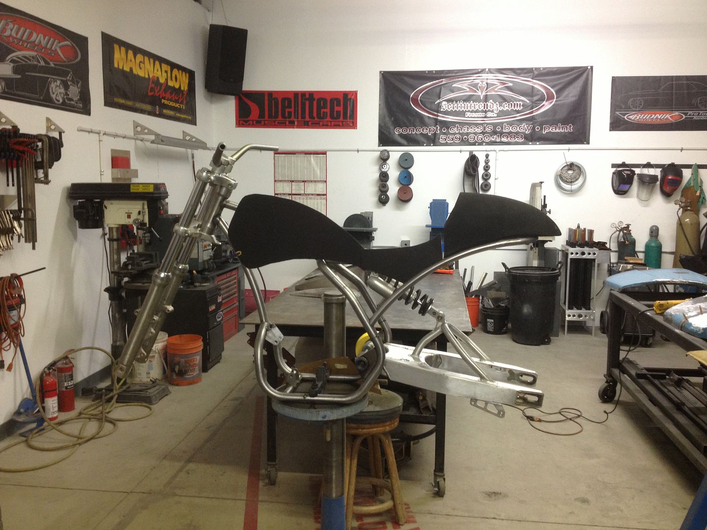

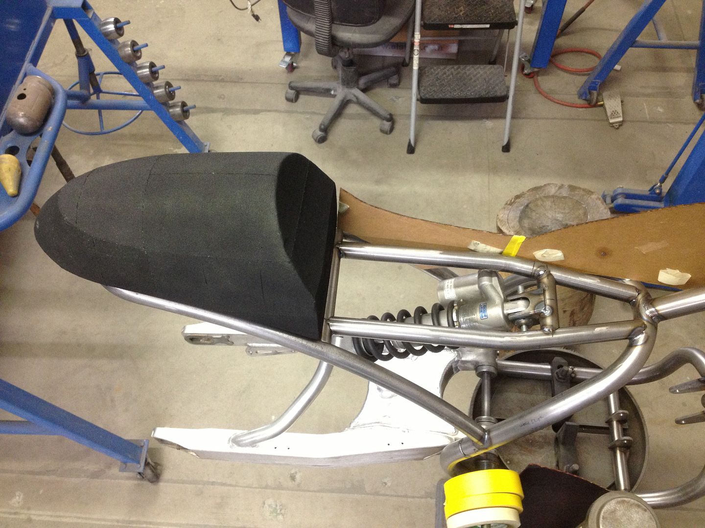

Need to start the bodywork so I can get my control placement nailed
Some chipboard cut-outs to get an idea of what I want. And a little shaped foam for dimension on the tail.
Ive been tossing around two different ideas for the bodywork.
If you look at the original quick sketch you'll see that theres a lot of shape to the bottom lines of the tank and tail. For quite some time, I thought this is what I wanted.
Ive gone back and forth on the subject, but now, seeing it in three dimension, I really think it needs to go on a diet.
A straight line from the bottom front of the tank to the back of the tail is what I was trying to get away from. Im now really warming up to it.

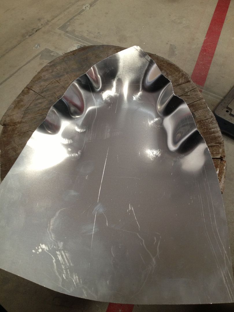

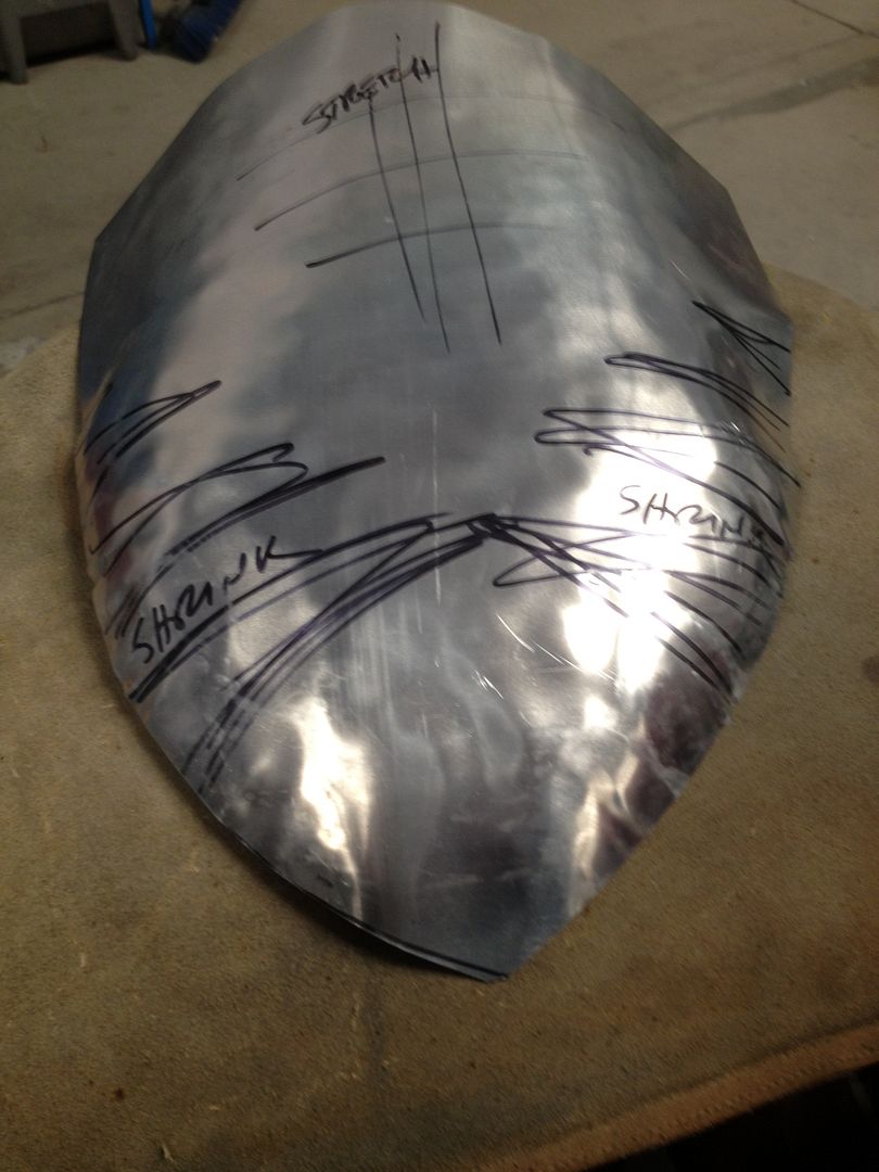

Starting to tuck-shrink the top of the tail section on the stump
