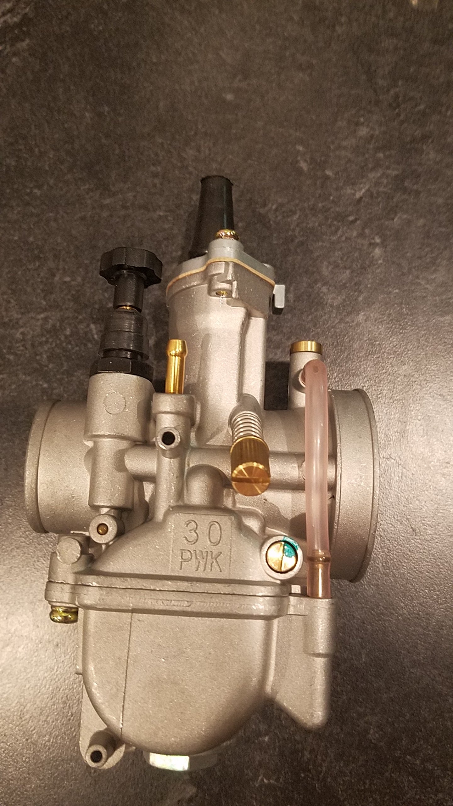

i hate to even ask but are these new?
if so can you post a picture
mikuni does not make a tm or tmx 30 mm carb unless this is for some proprietary install worked out with mikuni for oem

Yes they're new. I hope they're not copies for the price. They are still in the shipping box in the shop. I'll go out and take some pics
im no keihin expert but they dont list that either and i dont have any jetting info for it in my keihin guides
so unless its a oem propriety its not to be had to aftermarket? so please post a pic so i can see?? or maybe someone will set me straight

if they are not genuine then i would move to return them
if they are knock offs they are a big pain both for parts and function

What do you think? Fake?

Is it possible those are JRC carbs? Chopper places offer those as Amal alternatives

how long ago did you get them if within 6 months you should be able to return them as they are not genuine
and you cannot use them they are cheap knock offs both ebay and paypal are good about that
like these
https://www.amazon.com/Maple-Carburetor-applied-scooter-replacement/dp/B07G2R4Q41
you can use the keihin catalouge as further proof
then get a set of 28 from mikuni if you have any trouble finding them or are worried contact me
