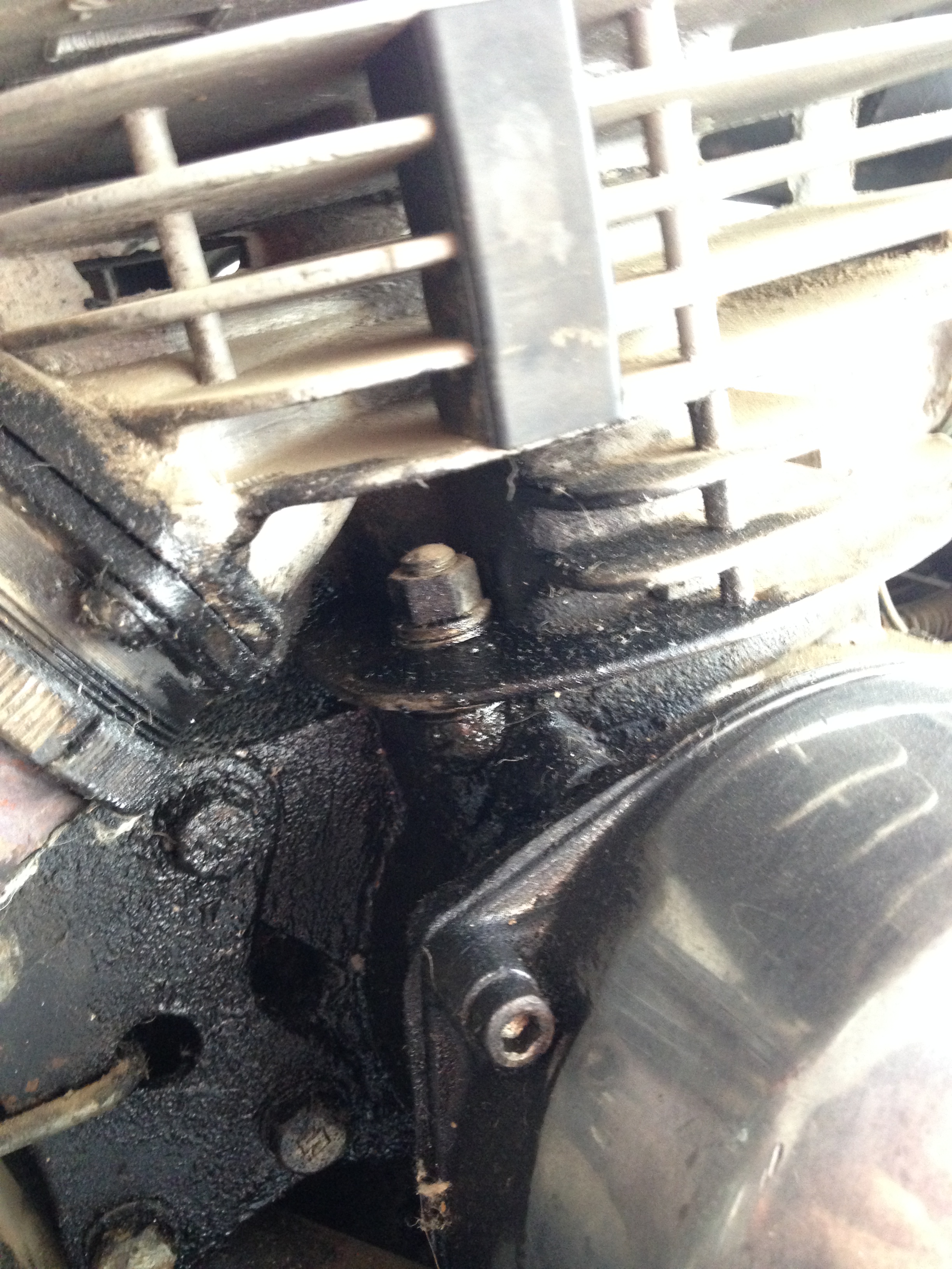

Hello DTT! I am new here so you're going to have to bear with me. I just picked up a 1969 TS250 with 18,000 miles on it an I'm planning on turning it into a brat tracker of sorts. The previous owner said the bike is not running (kick starter isn't working) and it is hotwired....so I have a little bit of work cut out for me. Another thing I noticed is that there appears to be an oil leak around the base gasket, so I think I'm going to order a gasket set and replace the gaskets when I drop the engine to look at the kick starter.

so you are going to modify a bike and you don't even know how the engine works ?
there is really no oil in the crankcase only in the grearbox that mess is simply from exhaust leakage and being a 2 stroke the exhaust is oily
that is a first year model savage and worth a lot more unmolested than it will be after you ruin it
18,000 miles is amazing though :D a full engine rebuild at considerable cost will likely be in order for it to be street worthy
