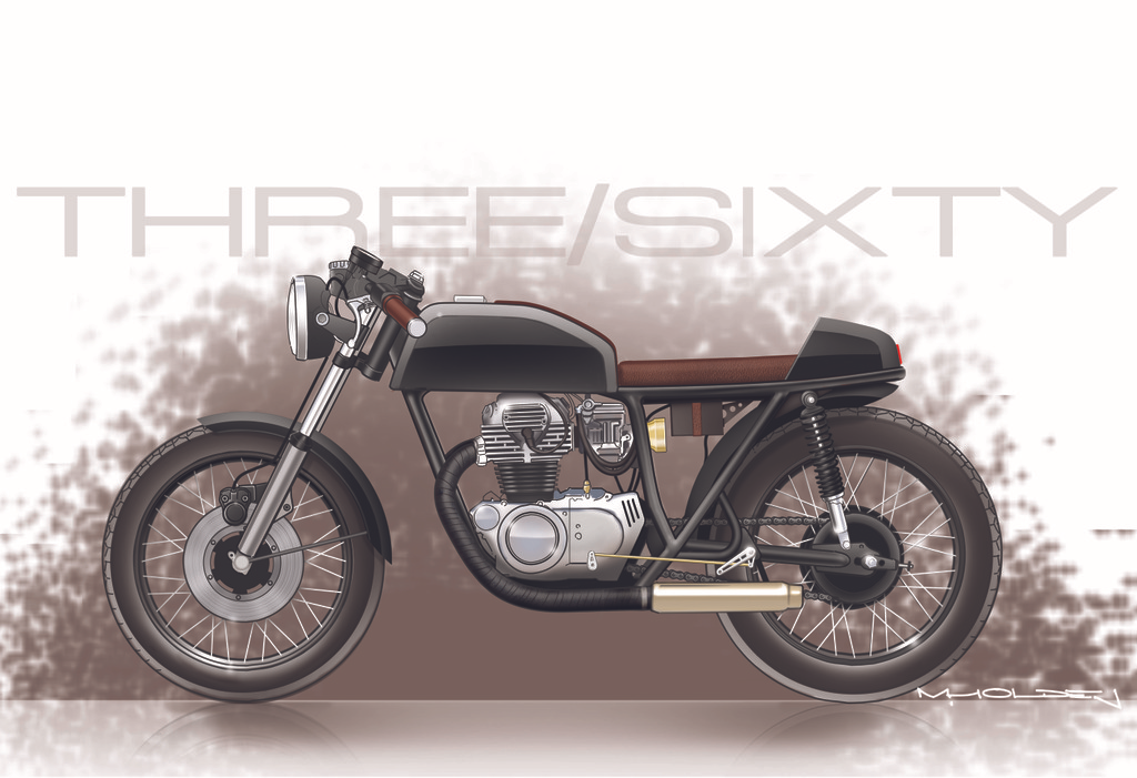

My plan is to go through the whole bike and do a cafe build, a la my rendering below:
I'm an Industrial Designer, so I'll plan to put that skill set to good use, using CAD and my fabrication resources to build misc. brackets, the seat and seat pan, etc. So, the build will be DIY, but some of the one-off stuff will be outsourced to a fab shop that can laser cut, machine, etc. I'll plan to also rely on you good folks for information and the knowledge that I lack :)

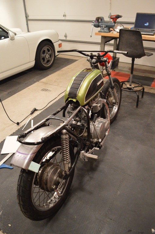

Here's the bike as it stands now:
My game plan is to get everything mocked up how I want it so that I can identify clearance issues, where the battery goes, mounting for the seat, etc., before final tear-down.
So far I've removed the wiring harness, and (almost) everything but the essentials, started cutting off unwanted tabs, mounted a new rear fender (still need to cut the back end off), installed rearsets, got a CB200 tank off of ebay, and have begun the design of the seat / seat pan. I'm still awaiting backordered clubman bars from DCC, but they should arrive this week. In the mean time I'm still working out what I plan to run for a battery (lithium?), signals (LED?), and everything else related to the electrical system, so I can plan for these items.

jungalist said:
almost a waste, the bike looked very clean to start with!
Everything looks better in pictures. The red "paint job" was done very poorly by the PO with a rattle can and not enough masking tape, the controls were hacked up so that when the aftermarket bars were added, the PO wouldn't have to run wiring inside, he hacked way too much metal off of the front fender, used residential wirenuts for a number of "repars" to the electrical, cut the seat foam in half (poorly) to lower the profile of the seat, and did a number of other "modifications" using bubble-gum and paper clips.
I bought the bike because underneath, it was a solid, running bike with no known mechanical issues, but was very "tired" and needed a lot of TLC, but thanks for the encouragement. :D

I struggled with how best to mount a CB200 tank to a 360 and came up with a solution. I used the factory forward-battery-mount for the rear of the tank via a combination of a 4", 3/8" bolt, cut to the proper length and some steel spacers, stainless washers, and rubber washers to dampen things. This required drilling out the factory weld-nut where the battery would normally mount. The rubber mounts up front are rubber "plugs" drilled and cut to the proper size.
The end result is a really solid mounting system. The only down side of using factory mounting points is that the tank sits farther back than I envisioned:
I could have moved the tank forward a bit, but the CB200 petcock interferes with the motor otherwise. I think I'm ok with this, given that the frame and tank will both be gloss black, helping to disguise the "set-back look" to a degree.

I agree that the tank is too far back. The stock tank was just held in by a rubber mount. i bet you can fab up something to move the mount forward. One positive result of moving the tank forward may be that if the tank is forward enough, you'll be able to sync the carbs without taking the tank off the bike.
I've seen another 360 online with this tank, and the builder described welding a new rod through the frame farther forward for the front mounting points, which seems simple, but this results in interference between the cb200 petcock and the top of the motor.
Other clearance issues are the coils, which I plan to relocate a bit lower to clear the tunnel, but the petcock is really the issue that prevents moving the tank forward (unless I move the petcock, which I don't have the ability to do myself). I've thought a lot about this and have ultimately decided that if I want to run the 200 tank, my current solution is the best solution for my build.
I think I can live with it. Anyone else think this is just too ugly to pursue? (Note: I'll probably go this route either way...)
