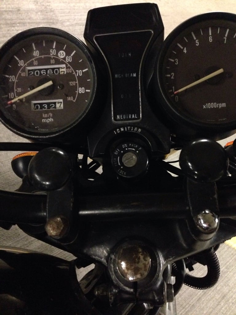

I got some goodies in the mail yesterday,

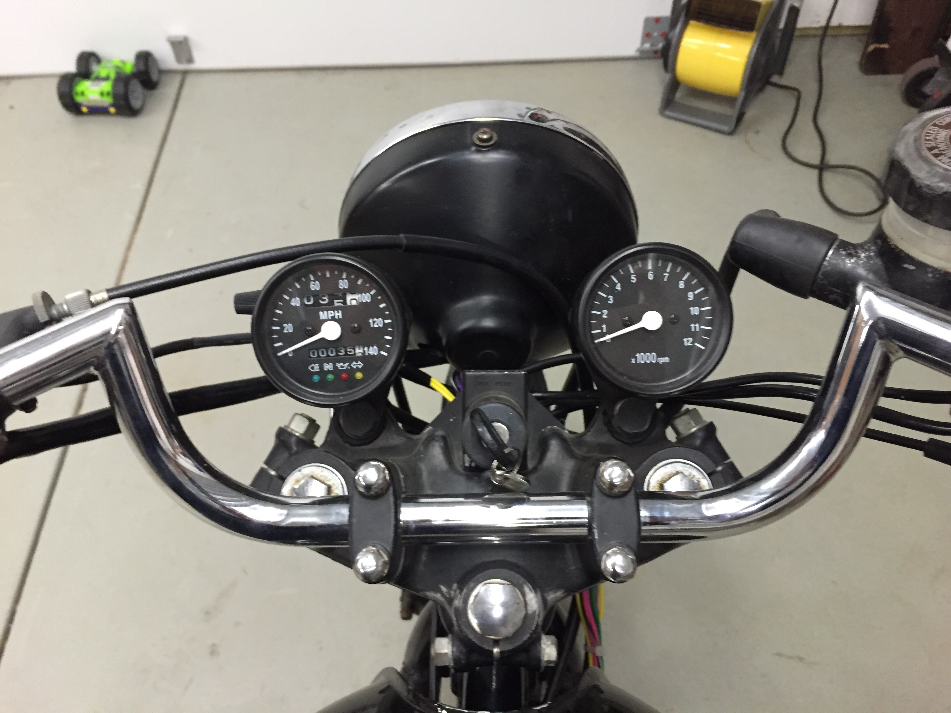

Picked up some super small indicator lights from drag specialties.
My only concern is that they're both two solid black wires and I'm not sure how to connect does I probably have to disassemble the idiot light housing and see what's going on in there,
And then figure out how to mount them, part of me, since they're so small ones to drill them into the headlight bucket then there's a part of me that says that they are so small just double-sided tape behind the center of my handlebars
]No need to disassemble. The indicator lights are grounded by the switch that runs them, and powered by key on voltage. One wire will connect to the power and one will connect to the switch wire, neutral, oil etc. It does not matter which of the black wires go where.

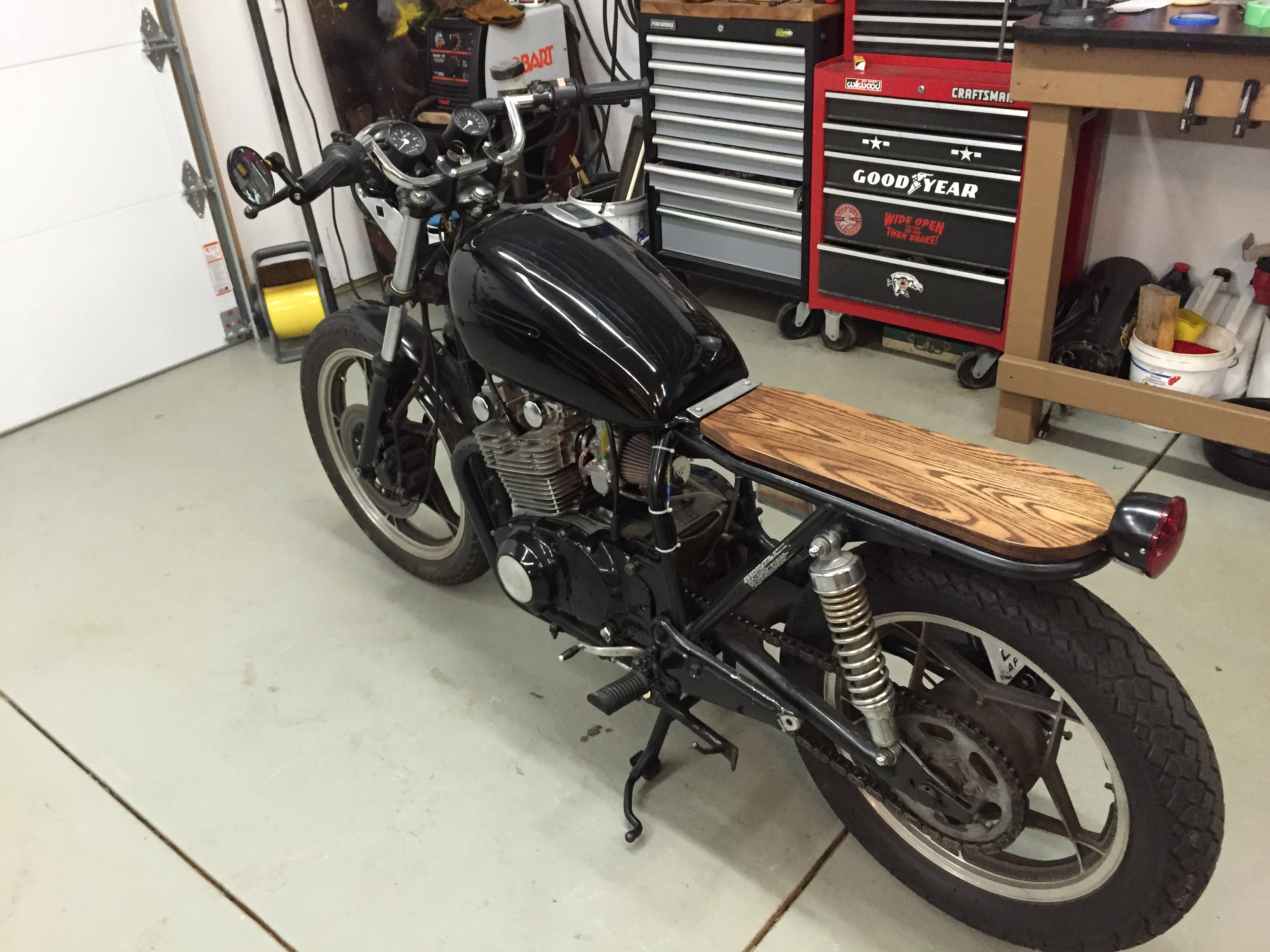

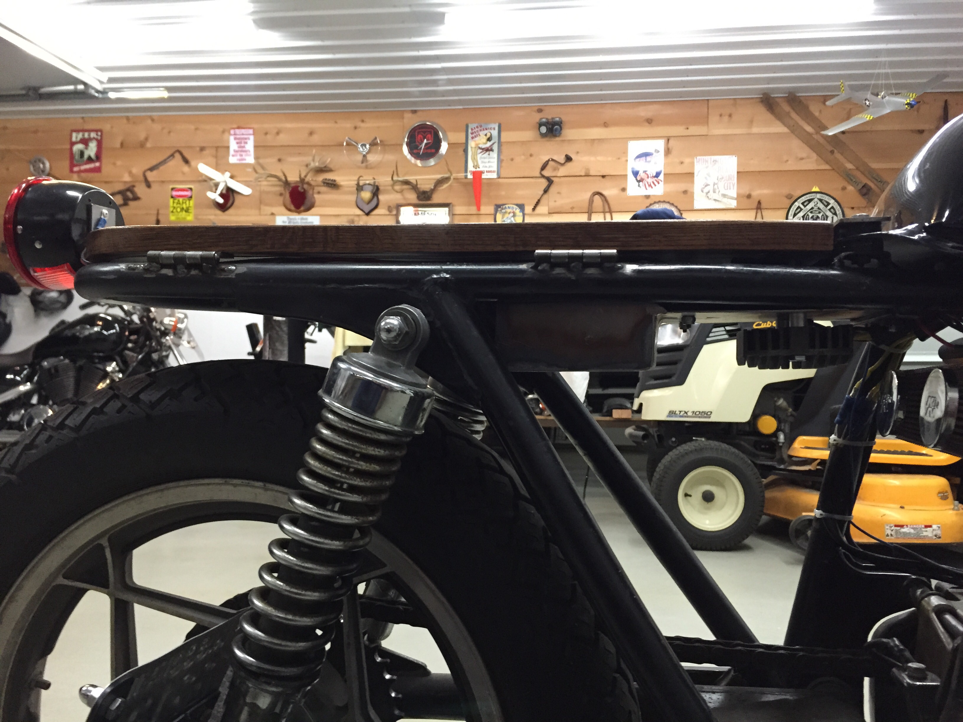

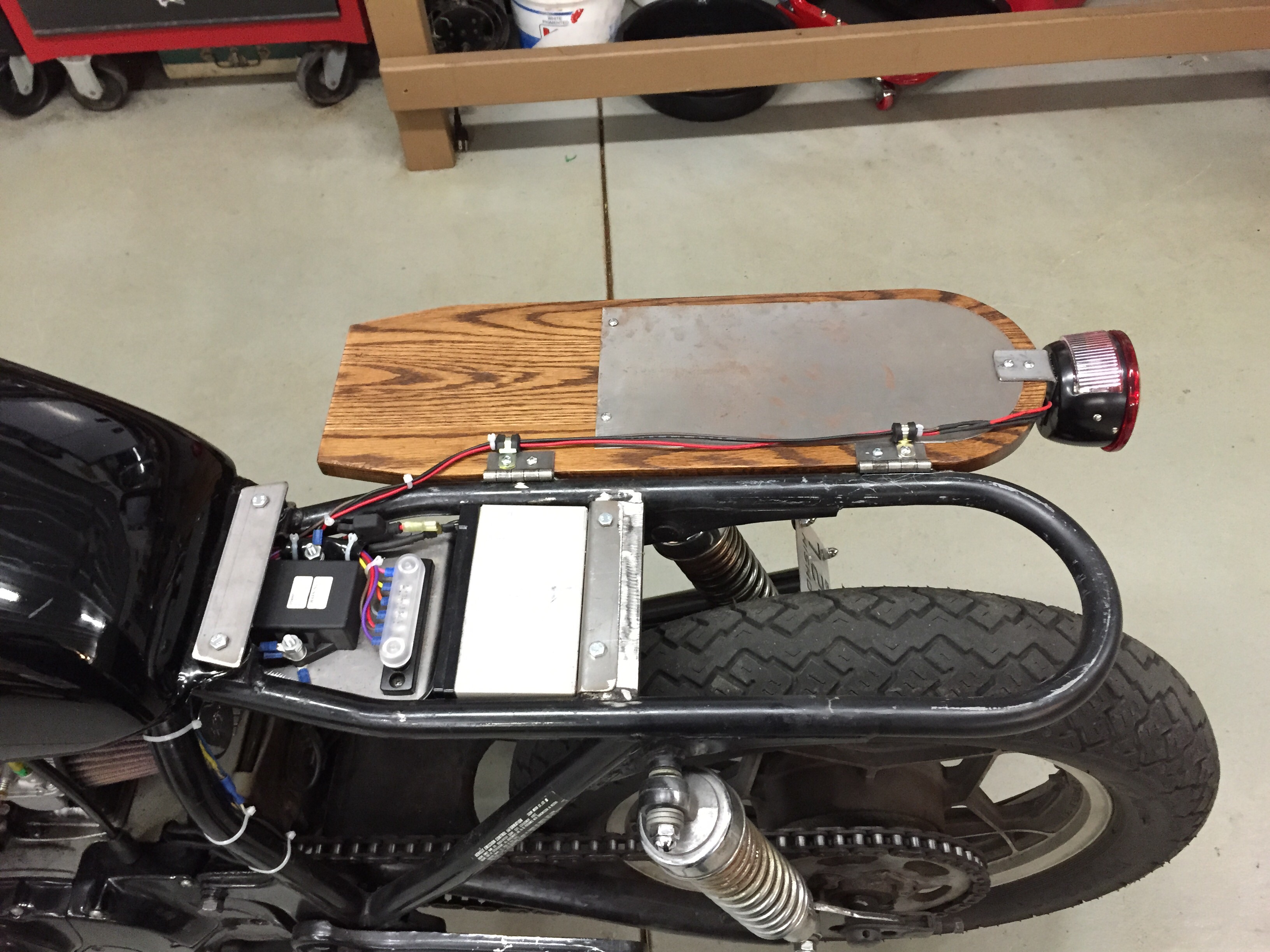

I too have a 81 GS450T. Its Dohcbikes favorite bike on this whole site. Heres a few pics. And no i dont plan on riding on the board. It will get covered.

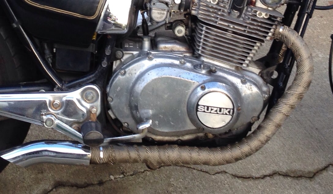

And man I need to get some new header wrap, black for sure this time and I guess the the silicon sealer? What do you guys think? It's a pain wrapping them because of the cross bar underneath

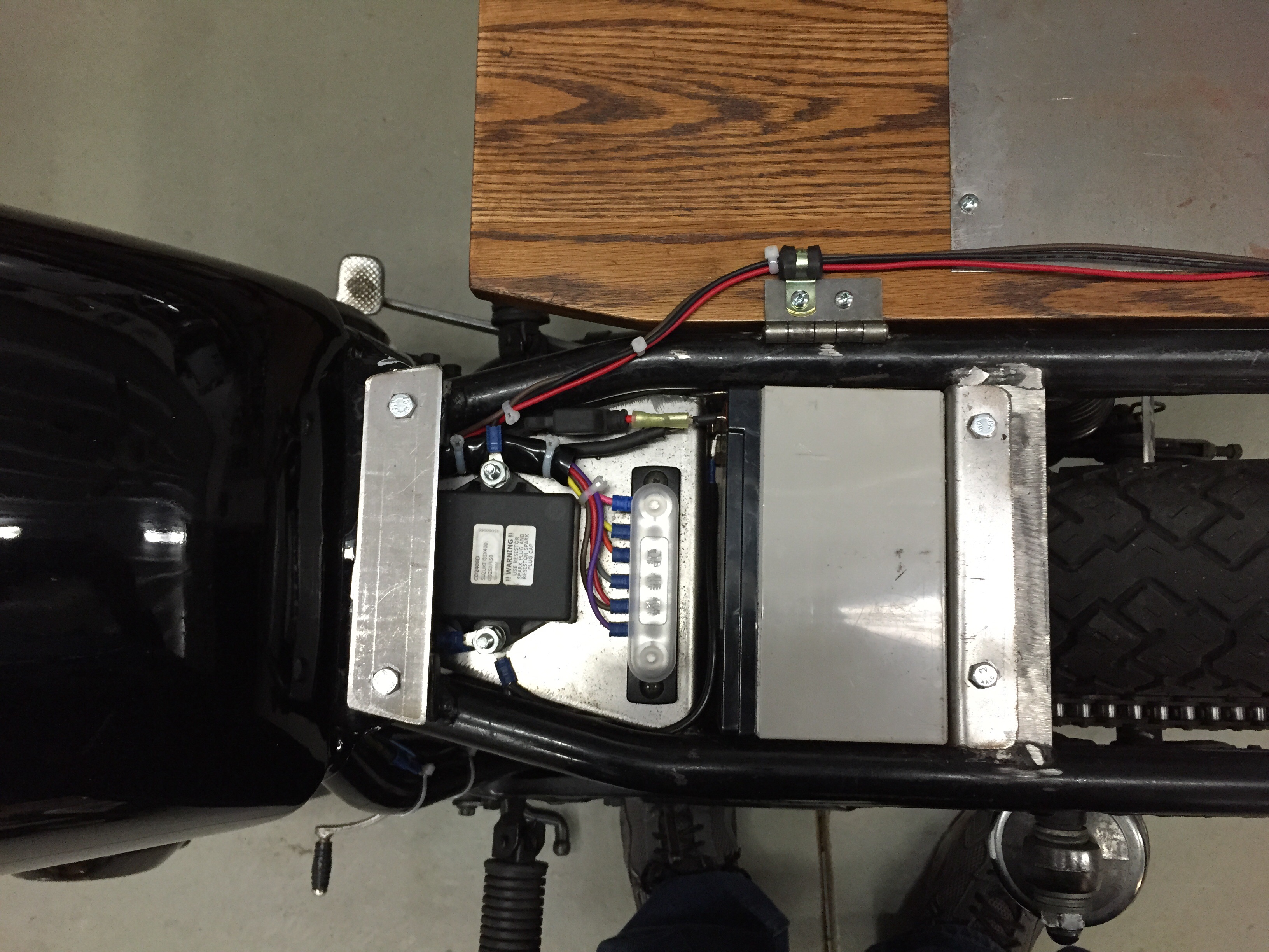

great detail I may have to Pm you or follow that build for the electric, that's right on point, nice ride bro
Your pipes didn't look to be in bad shape before you wrapped them. If you build your bike like minicafe is building his, your rear tire is going to rub. The bright side being that you can store canned goods in the pantry.

BiellaBound: As i said before your build is going well. Why did you wrap the pipes?

thanks for clarifying that I wrapped the pipes 2 part, 1st I hated the gap the PO left when he put those turnouts, so the wrap at the time before fraying looked cleaner and seemed compliment the bikes original color, 2nd I have always wanted a triumph scrambler or Bonny, I know my bike it a far cry from either buts it's a parallel twin. A lot of the inspiration pics I had collected were triumphs and had wrapped pipes, so it just built into my brain as part of the aesthetic I was trying to achieve. However, completely understanding that the scramblers have wrapped pipes because of the high placement.

Sorry Biellabound that Dohcbike ranted on your thread about me. We have history. Like an ole married couple. Let me say one last thing about Dohc so he will calm down, he is right about 98% of what he says he just doesnt have any manners. Other post on here that have been removed have been removed by me because i dont think people want to start reading a post to learn something only to read two ole ladies bickering. And he will like me saying this.... He is right, my rear tire does rub if i have the springs on soft setting but hasnt ribbed since i tightened it up. The good news is I own a welder and can change anything. And as far as the "pantry door" seat. Ha. Good one. I like it over most seat designs ive seen. Easy access to the electrical and once covered it wount look ant different than 95% of the other Brat seats. But most importantly I Like It. Dohc never understands what that means.
Back to your build, Nice work on the polishing! I understand your issue with getting it done while your familys away. Those are some good times in the garage for me as well. If you PM me sometime id be glad to get you more detailed pics of my bike. I shouldnt post to many of my bike on your thread, people will want to see your bike not mine. Have fun.

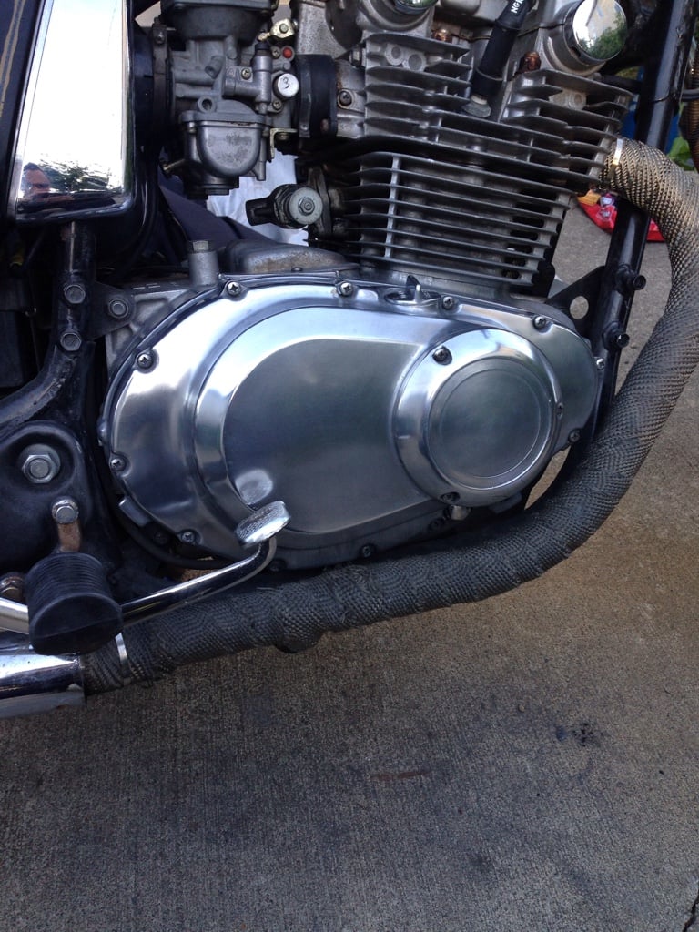

Looks good. It's a lot of work huh. I can see your fingers in the chrome cover. Dirty work too. I wish mine looked that good. Mine were painted by the previous owner. I like the polished look.
Skipped breakfast, change of heart and motivation took over my hunger. The other cover is as done as it's going to get for now.
