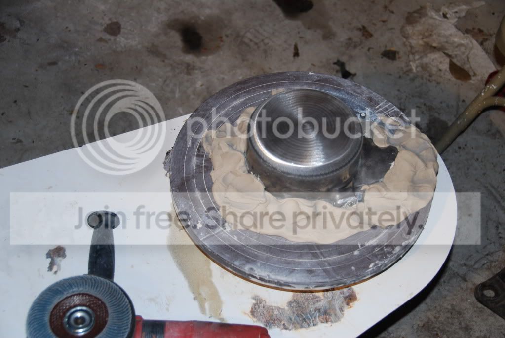

first i cut the bucket down to the mounting ring.

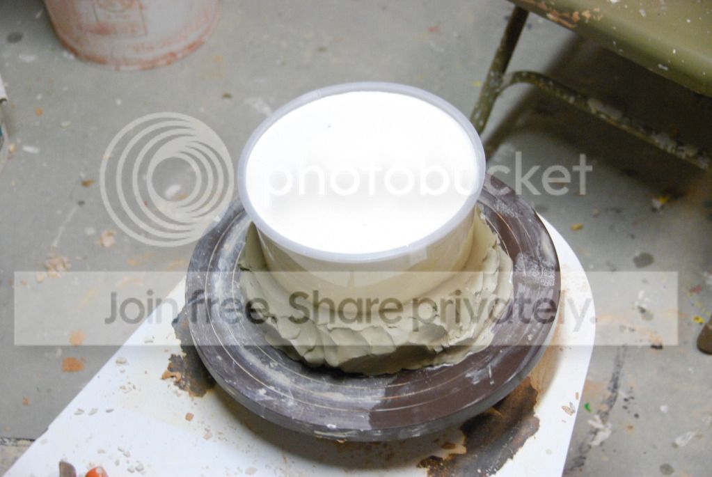

then i taped up the bottom rings, centered it on my potters wheel, and packed a bunch of clay into the inside

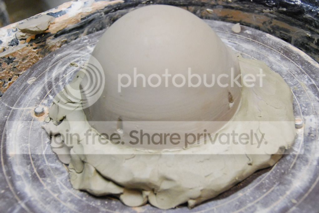

then the profile was refined
then i sculpted some raised parts on either side to have it mount to.
This part was crucial, i cut some registration points into the plug, down to the top of the metal ring.

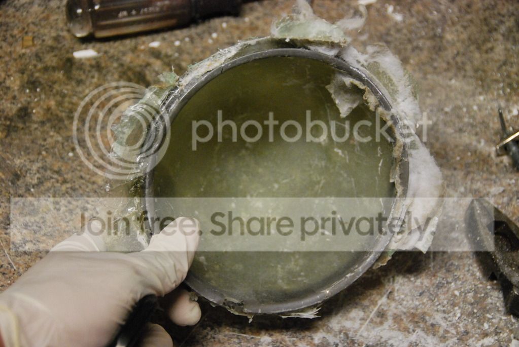

And here is it with the crap trimmed off and the light in.
