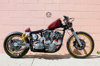

so I tore it down to the frame, pulled the motor and i'm going to go with some kind of bobber/brat swingarm style. right now I'm looking here and various chopper blogs for some inspiration.
maybe borrow some Church Of Choppers inspiration...
No rush on this project, I'm still working on my Ironhead sportster chop so I have plenty of headaches to keep me busy ;D
I love the church... I've been following them for about 2 years now religiously. (pun intended).
You have a ton of work ahead of you, I will be watching this build waiting to see what you do about the swing arm....
Yeh Jeff builds some amazing stuff.
