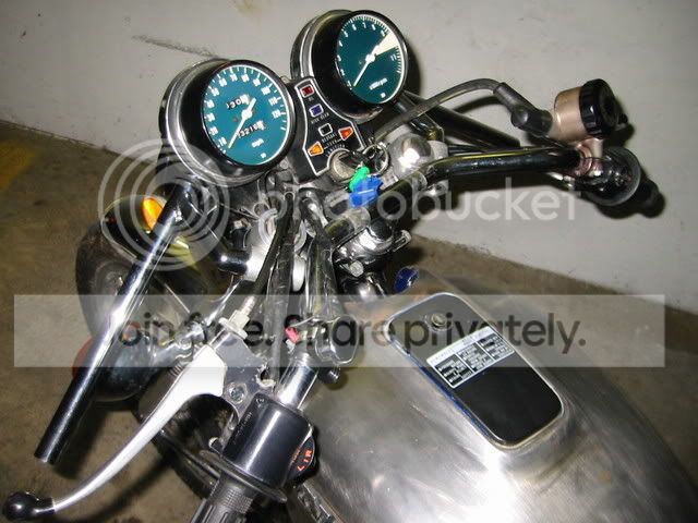

On my 75 cb550f before:
And after:
I lowered the suspension 2 inches past the triple tree and clamped them on top.
I should have clamped them below the triple for a lower riding position....

Here are more pics of the transition:
The Telefix bars clamped on the fork-tubes prior to moving the controls over from the old bars...
Finally done..
