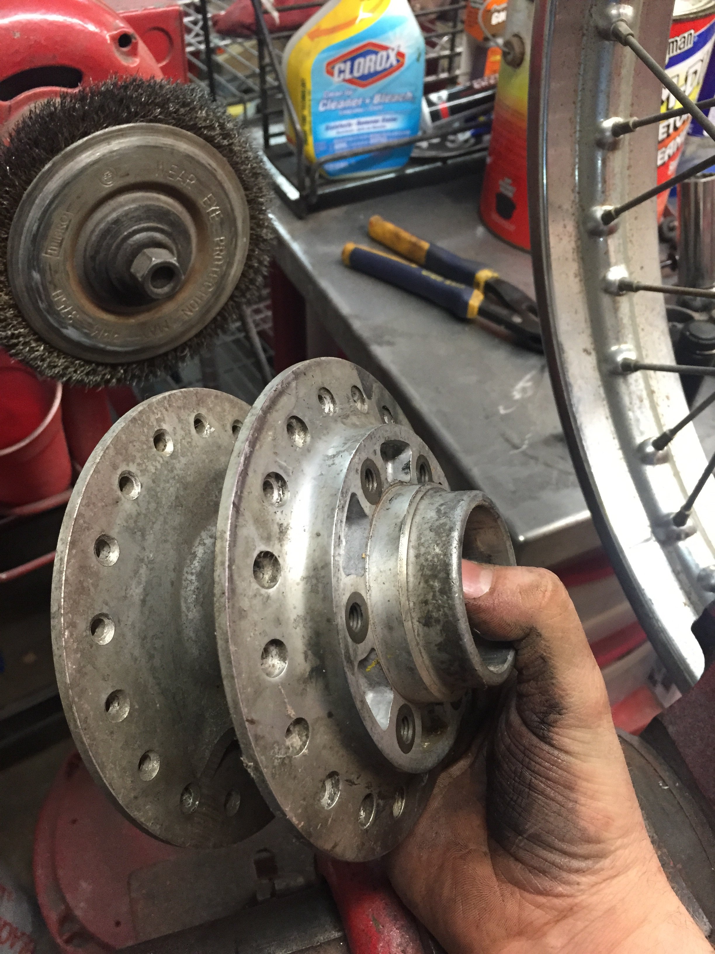

Which one of these is an xs650 hub and which one do I need?
CBPayne
I have two hubs here that I bought off of eBay. I was under the impression that both were xs650 hubs and they still might be. The one I want use has the rotor mounts but I thought it might not work since its older than 76-78. I'm need the correct one for a 920 swap. The other doesn't seem to have away to mount a rotor. It also as an tag on it that says 72 x52. Thanks

Also I could really use some help trying to figure out what parts I'm missing from this hub.

The hub without the rotor mount is in fact as it is labelled - an early XS hub. The earlier design has a rotor that interfaces with those recesses etc. on the side of the hub. It's an odd design and not worth using.
The hub in your hand looks like a more typical XS hub which went unchanged I think for many years - likely the entire run of the XS650.
What is a 920 swap? Can't answer much more without knowing what you're doing. You have the internal spacer for the hub which goes between the bearings, but I don't know what those other bits are for. Clearly you don't have the spacers to center the hub between XS forks, but I assume you're not using XS forks?
Dude I appreciate you chiming in. I have a virago 700 that I'm doing a front end swap to an 82 virago 920. You know the famous virago that everyone copies. Now I was inspired to build my bike by that one, but I'm only copying the front end. Plus I have a second gen virago. On the famous white and red virago he put an xs650 hub on the 920 forks. Which I've heard is common practice for those who race xv920 bikes, I think they also cb750 is common too. What need to know is if there is anything missing that would prevent from rebuilding this hub after it gets powder coated.
I'd think your hub should be fine - but obviously there's going to be some machined spacers etc. between the hub and the forks on both sides that if you want to match the hub, need to be made first and powdered with the hub (assuming you want to hit the powder coaters once).
If you want machined aluminum spacers between your colored hubs and forks, then you're safe I think coating the hub. Just don't coat the bearing surfaces. You'll also need new bearings to match the Virago axle.

you infer that one of those hubs (the one laced to the rim) has no rotor mounts.....well, strangely enough i have a disc that fits that hub, can't for the life of me work out how the hell it attaches but it has a space on the back of the rotor centre that matches the boss on the hub

that is the early first time disc 650 twin lashup , funky indeed
