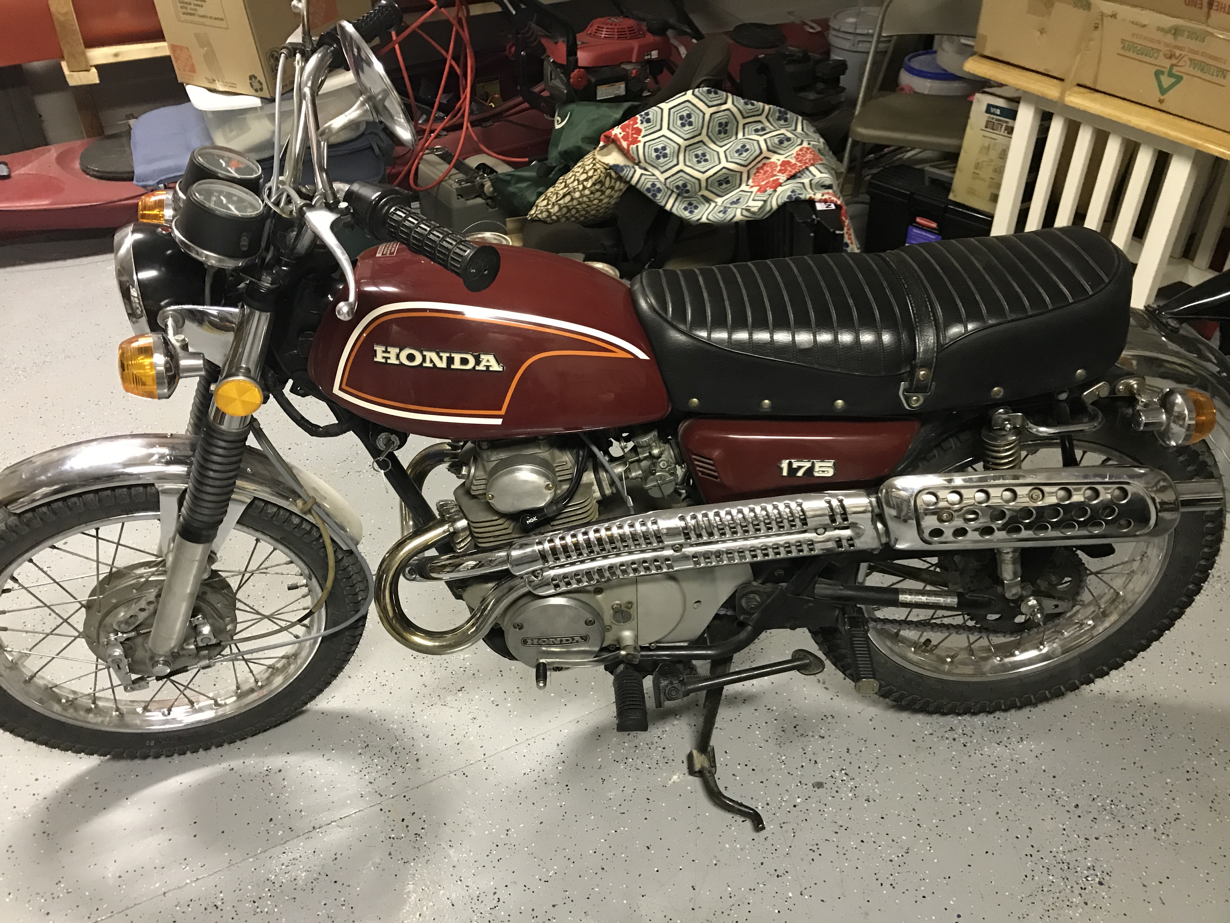

Hi all, I have a CL175 I am working on and I have a problem with getting it to go fast ;D. I should say I am the mechanic's equivalent of a tenderfoot - not a novice but not highly experienced by any means.
The bike revs up nice in first, 2nd and 3rd gears on the flat straighaways, but after I am shifting up to 4th, going maybe 35-40 mph, the engine just seems to bog down and won't rev higher no matter how much throttle I give it. It just makes a hollow sound and won't give me any more power. In fact I can go faster in 3rd than in 4th. 5th is even worse. And even in low gear the bike can barely drag me up the hills.
I tested the compression and it seems pretty low - Left was 114 psi, Right was 129 psi. After adding a little oil to each cylinder through the spark plug holes, the Left was 126 psi and the right was 150 psi. But I don't see how the low compression would not allow the engine to rev in high gear, I would think it would just reduce the power of each rev.
I have checked valve tappet clearance and made adjustments (no change in compression). I have checked the main jets and they are clean. The carbs look in great shape upon inspection. No obvious leaks. I adjusted the air screw and idle screw per the manual.
What do you guys think is going on? Oh I should mention I am a big guy for this bike (230 lbs) but I would think that's a minor contributing factor.

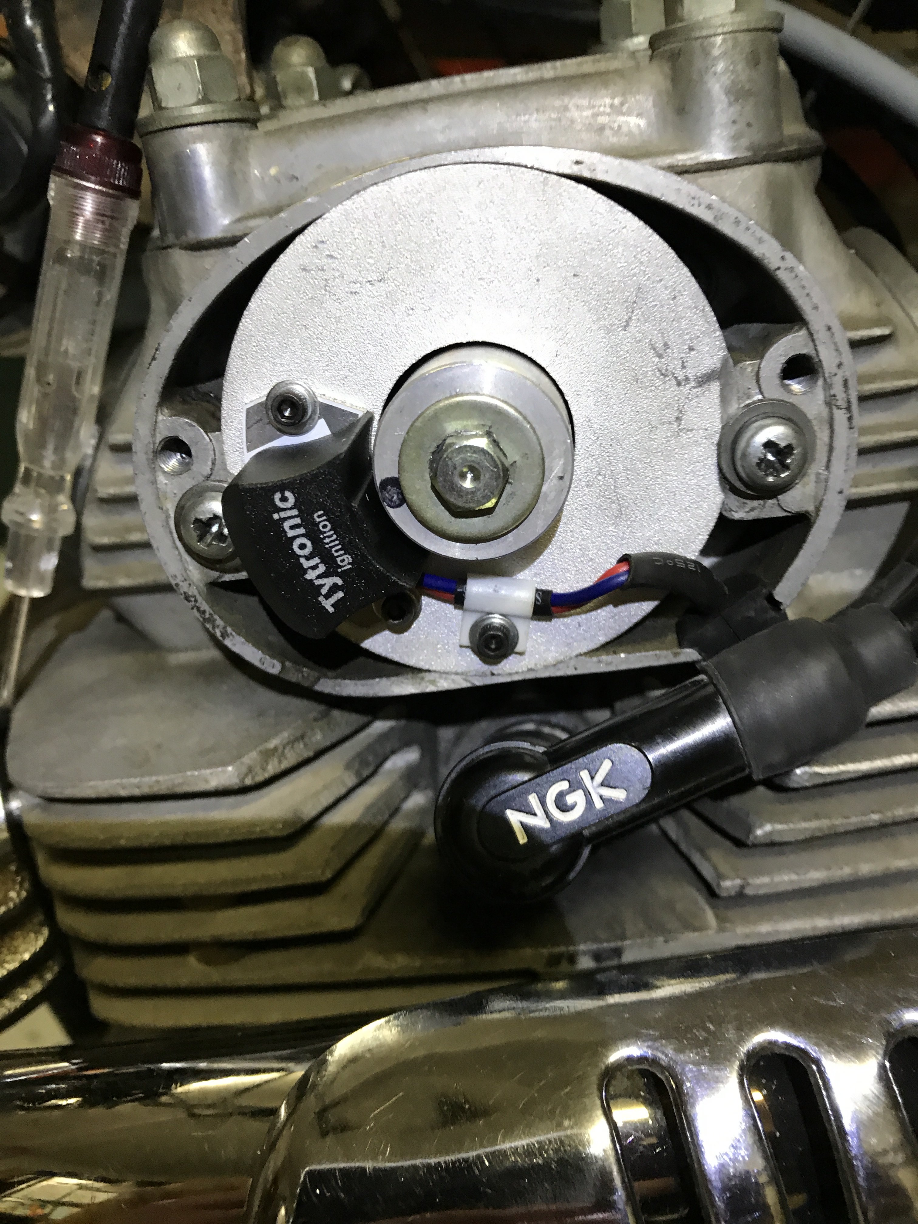

CXman thanks for your suggestions. It has an electronic ignition upgrade (from previous owner). Don't know much about those ... are they maintenance free? I did adjust tappets and cam chain tension. I may double check the tappets. I agree, next step is check the petcock. Also I am gonna look at the plugs and will post a photo if I have trouble reading them. Other folks mentioned jet needle height could possibly help. I guess my remaining question is- For folks familiar with this bike, with the compression test results I posted and my rider weight, are those factors the "obvious" culprit? Or should I sniff around at some other things before a full-on top end job? Thank you

Last night I checked timing, valve clearance and the petcock.
Timing was a couple degrees early. I rotated the plate very slightly so the test light comes on just as the F mark lines up with the index mark on the case.

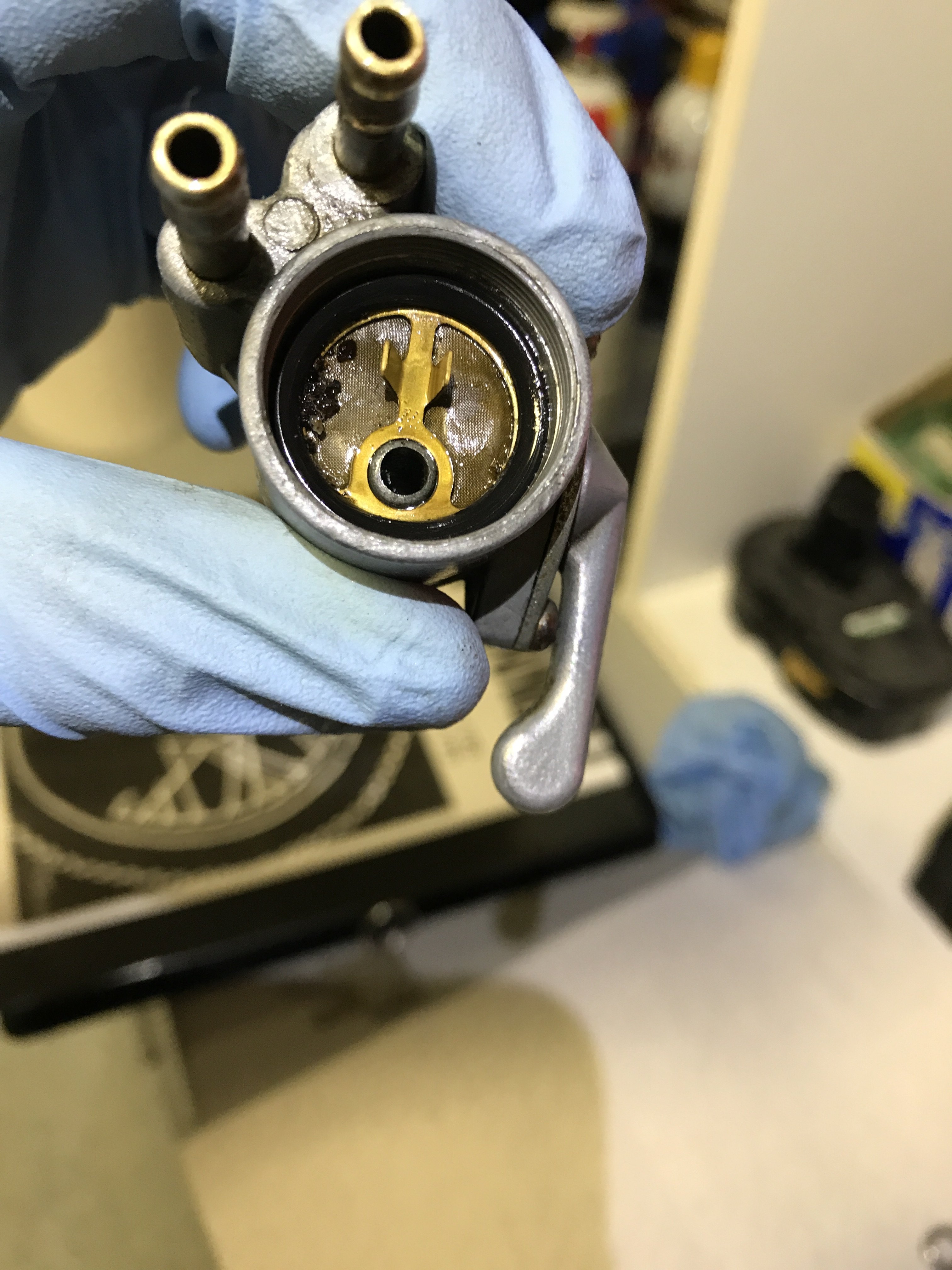

The petcock screen wasn't clogged, but there were some nasties in there that needed to come out. When I put it back together it leaked, so I need to see what the issue is tonight. Maybe a pinched o ring or something.
