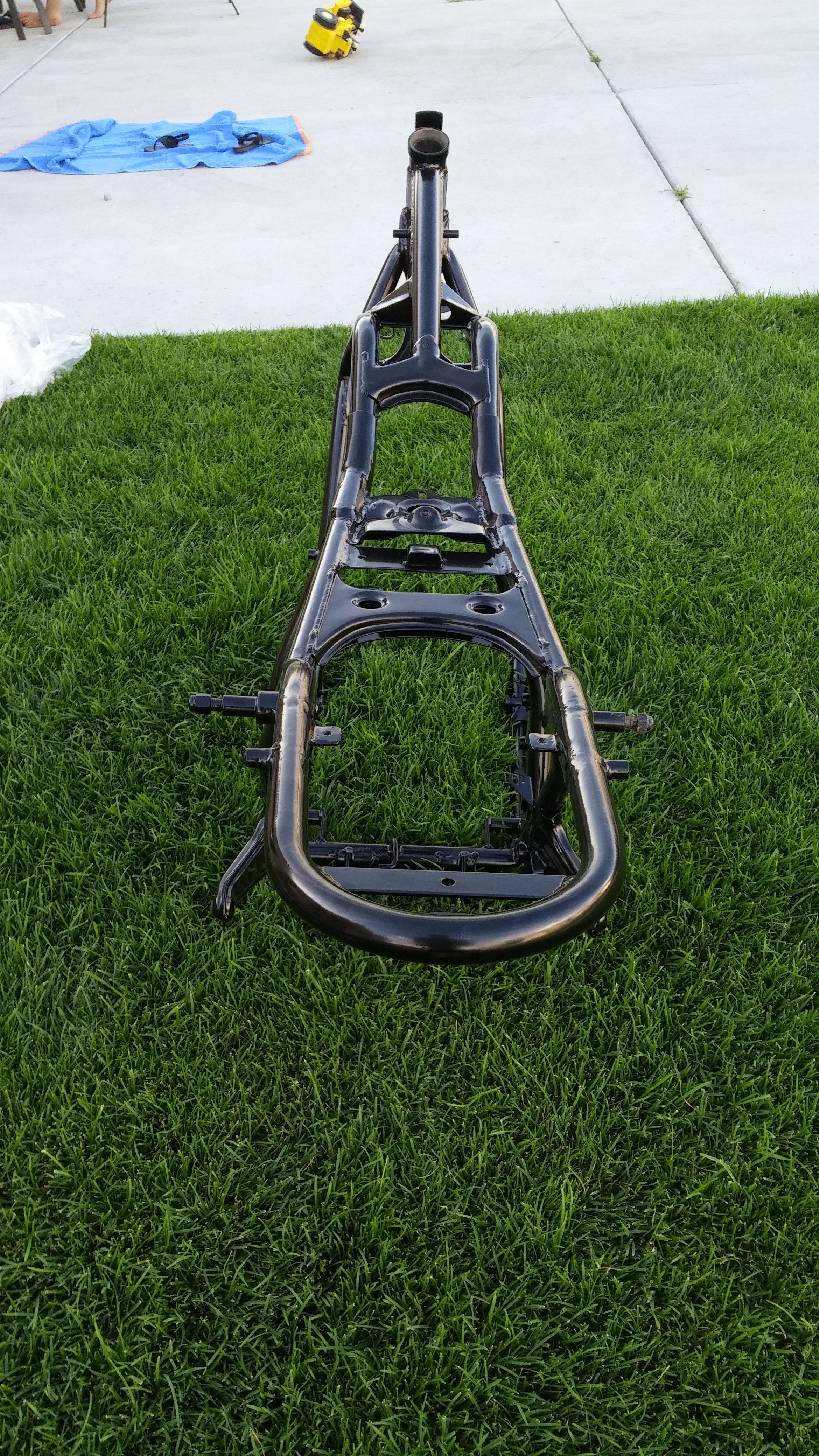

I ordered a loop and seat from Benji. Detabbed the frame and welded the loop.
I found a 82 super sport at a vintage cycle yard in Boise ID. Ended up getting the tank mount and some 37mm forks.
I was going to mount my turn signals directly behind the shock mounts.
Luckily my grinding skills are better than my welding skills. I was happy with my result. My recently acquired forks are in the background.

I was concerned that i had removed too much metal when i cut out the old,tank mount. I decided to use reinforce those areas with some 1.25" tubing.
The turn signal i ordered were too large to fit behind the shocks. I used some round rod to move them a little further back. Tapped it and bolted them up.

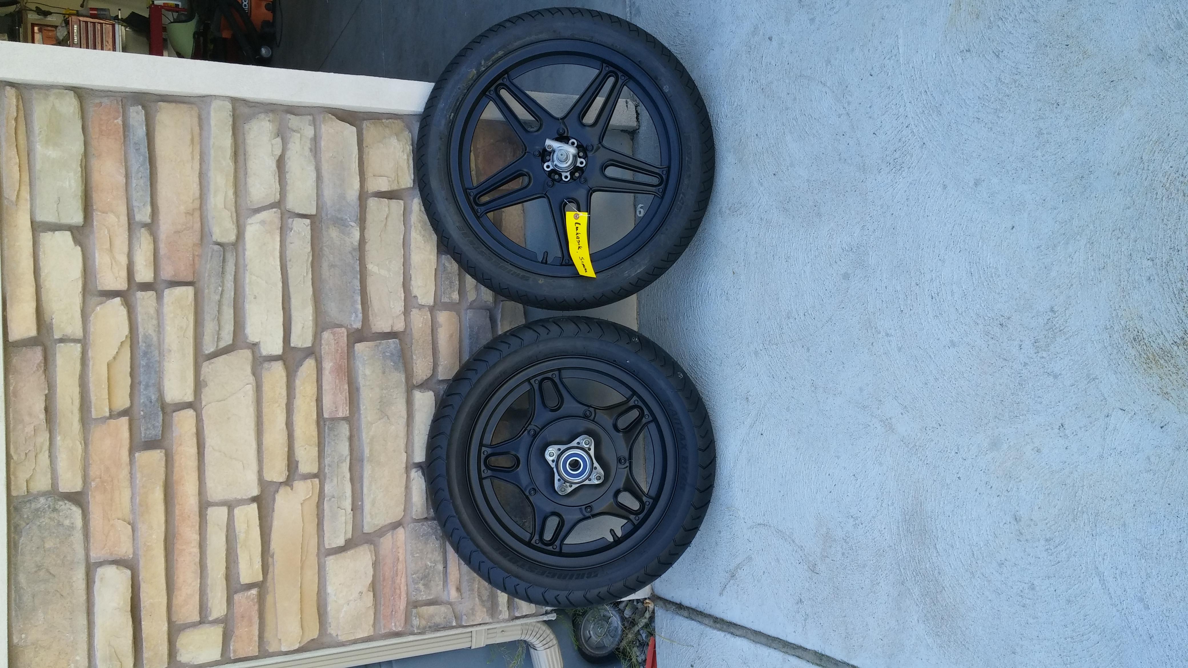

Commies after powdercoat wrapped in new Bridgestone tires.
Sent from my VS985 4G using Tapatalk

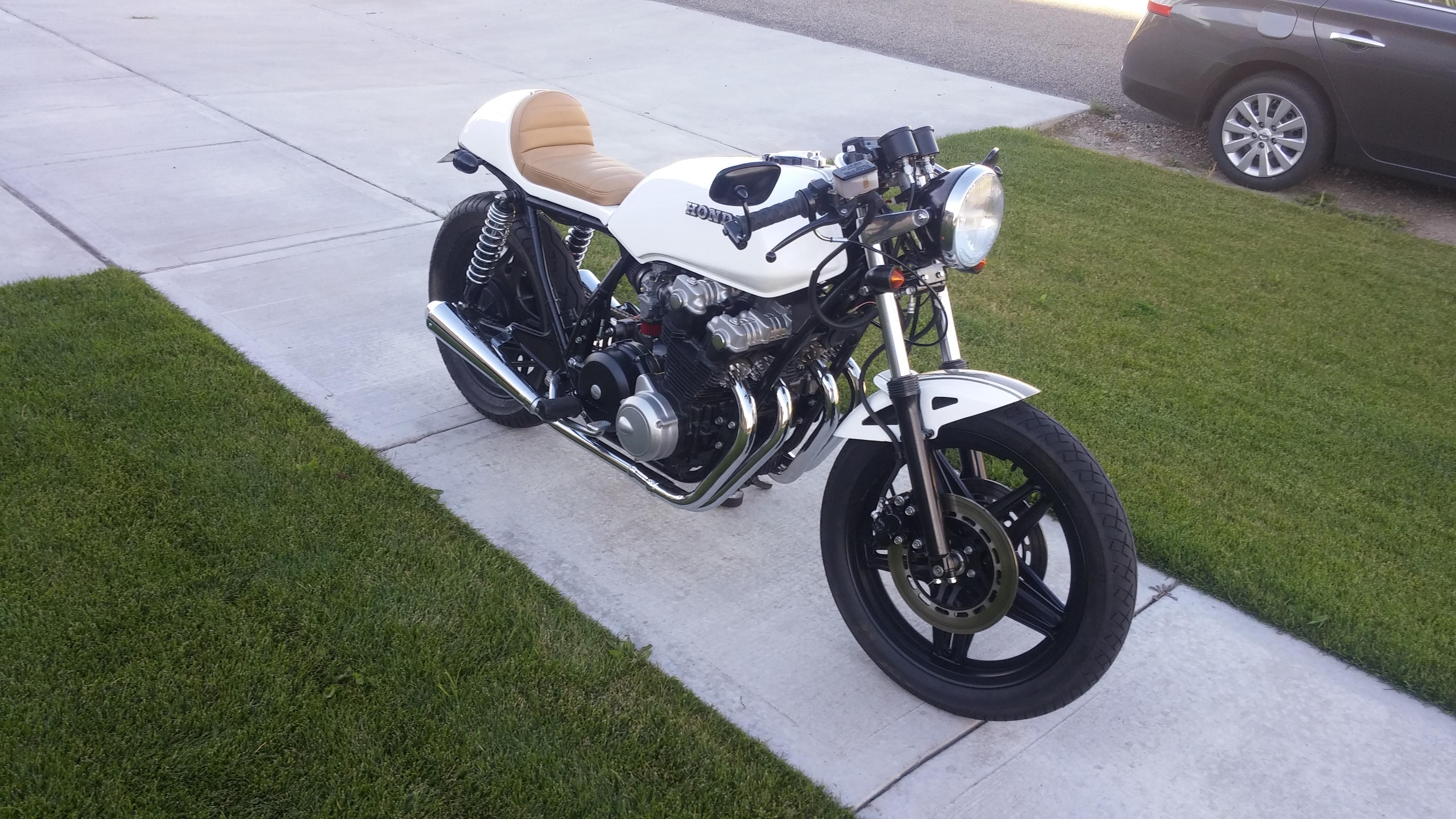

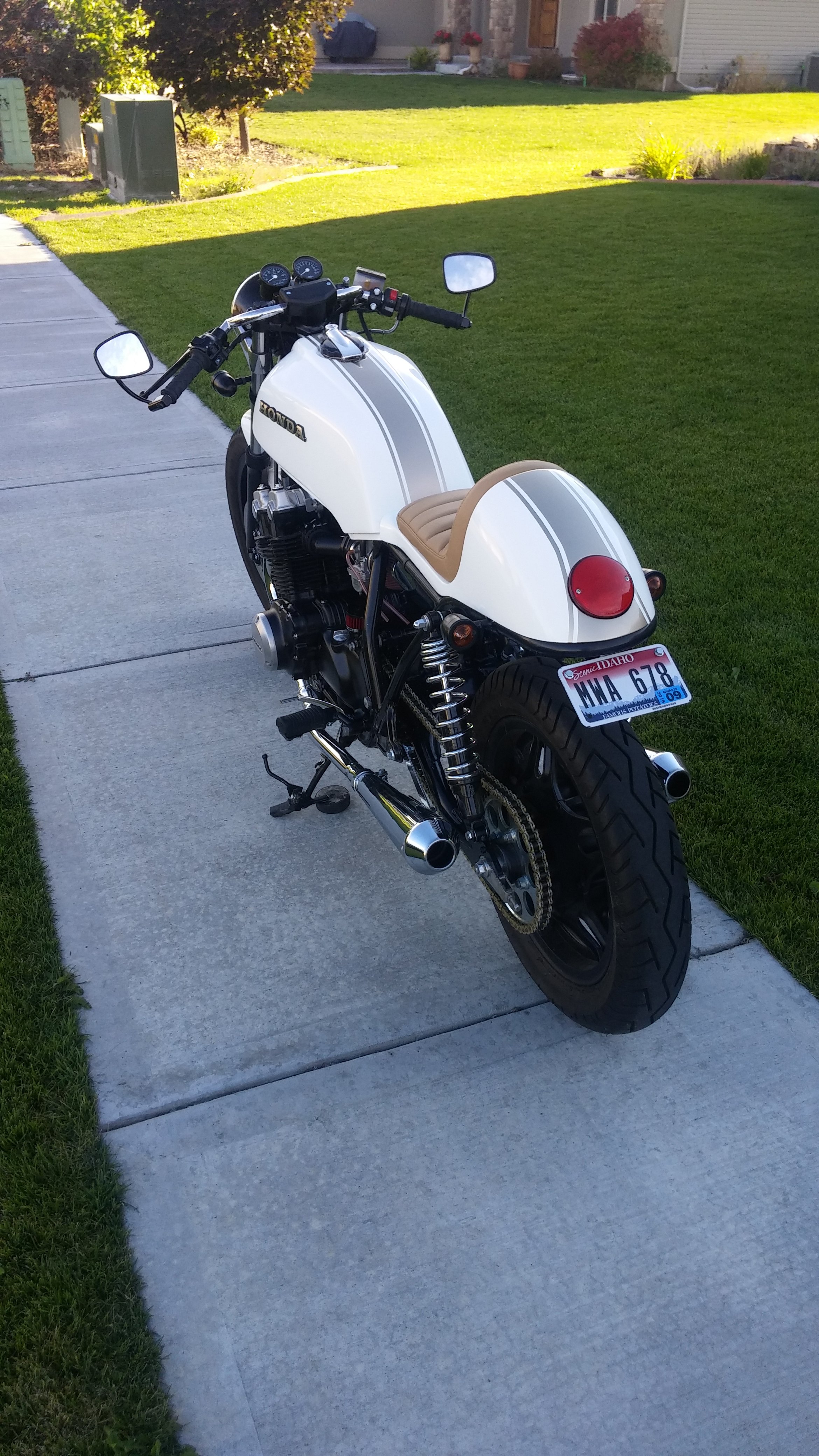

Here is the mostly finished product. Its been a while but teardown to rebuild took me 1.5 years. All I have left is to design and cnc my rearset mounts and tweak with the carbs.
