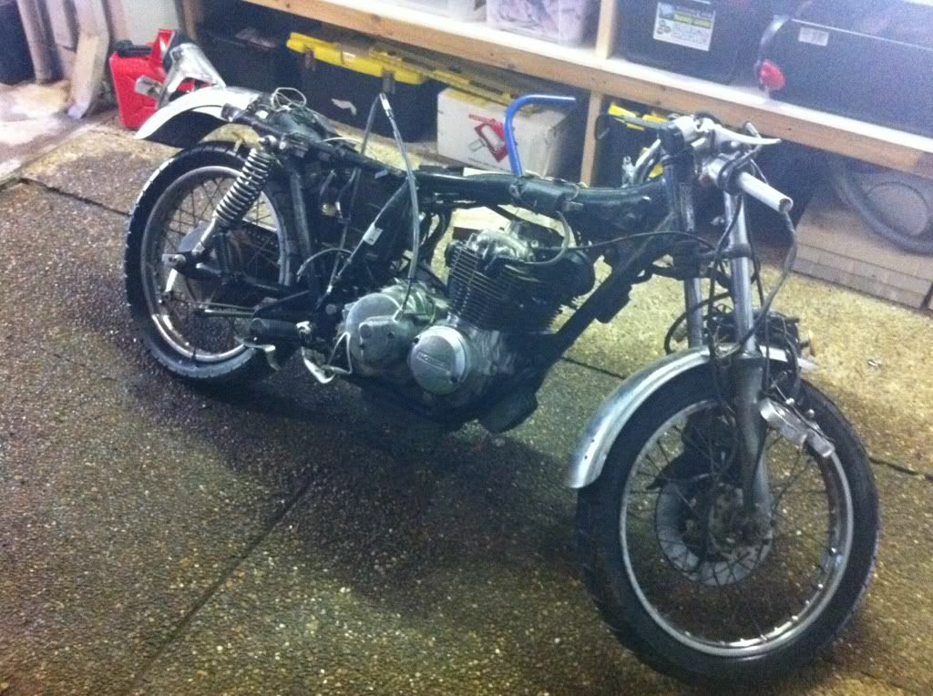

Here she is back at home:

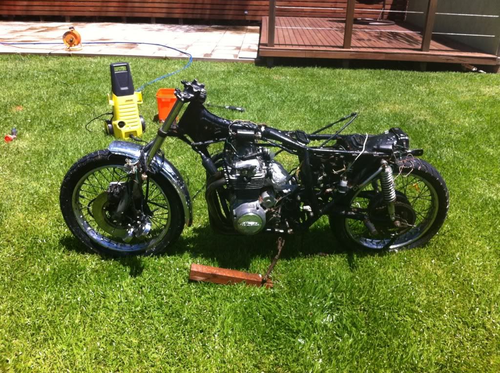

First up was to give it a good clean, crack out a couple of cans of degreaser and the trusty Karcher and hit it hard. It scrubbed up well and cleaned off the caked on crud and crap:

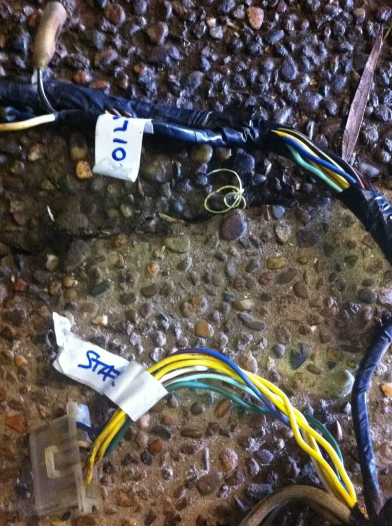

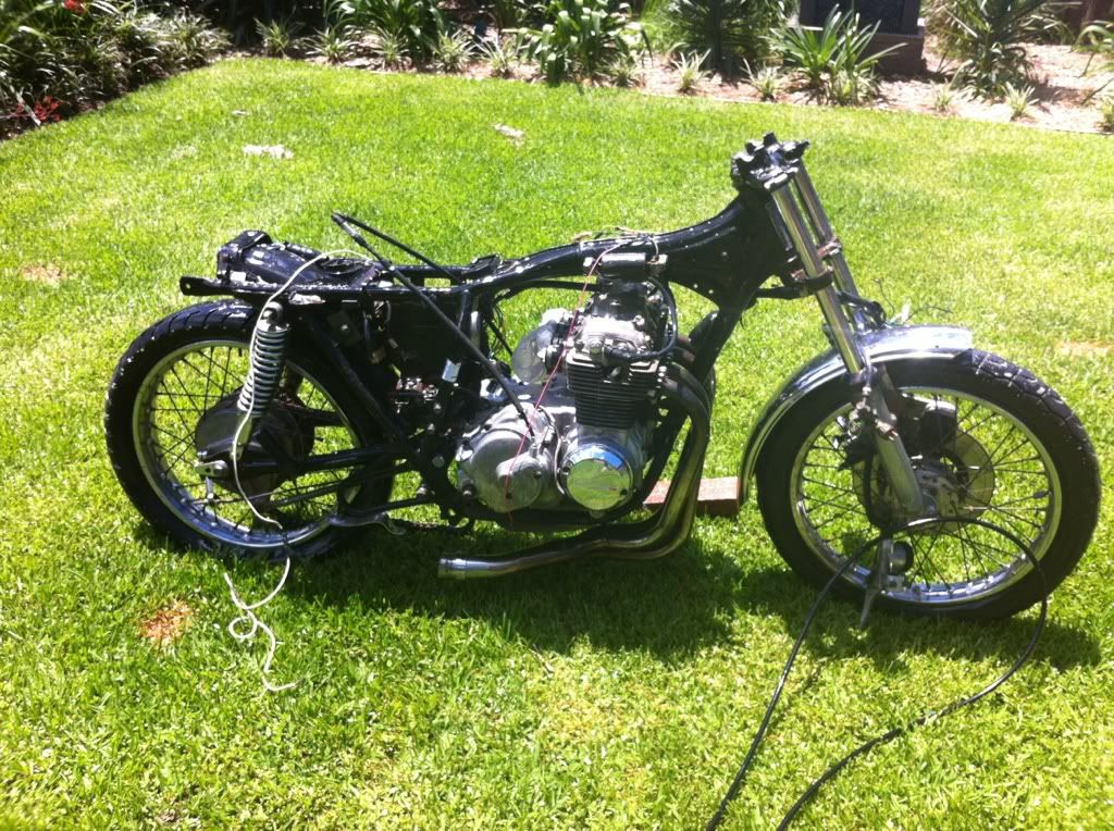

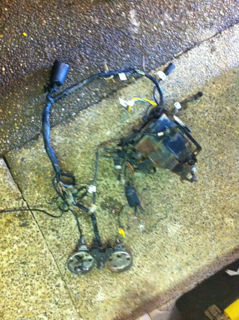

Was planning on running the bike before I stripped it down but still haven't got some carbs yet, that can wait. Time to strip it down, first off came the loom:
Made sure to label all the loom well, as I have no idea where this stull should plug in:

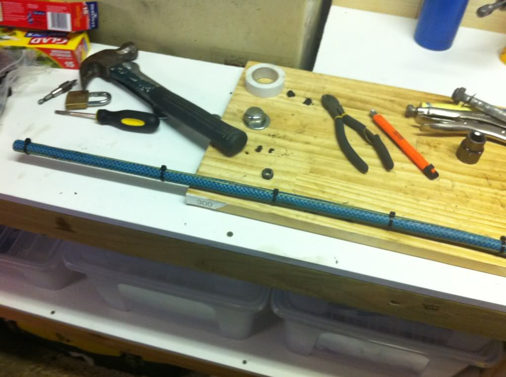

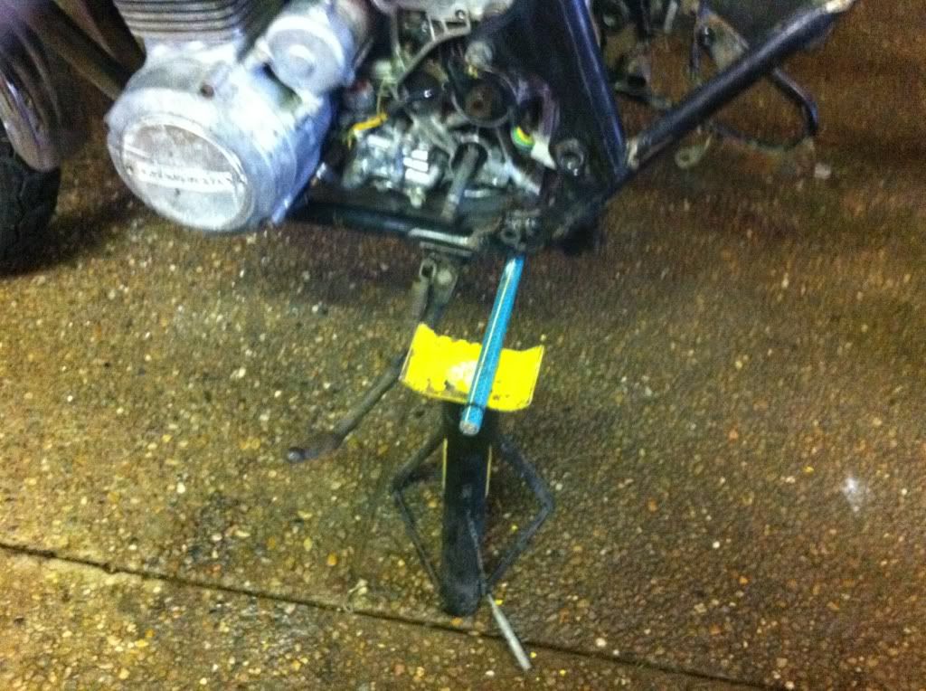

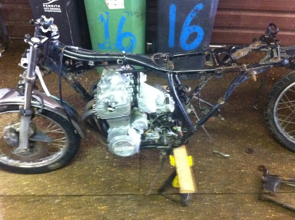

With the bike nice and light... or should I say slightly lighter, I rigged up a way to get the bike off the ground so I could strip the swingarm off:
The plank of wood wasn't really doing the job. so I got some steel reinforcement sticks, covered it in hose and used that instead:

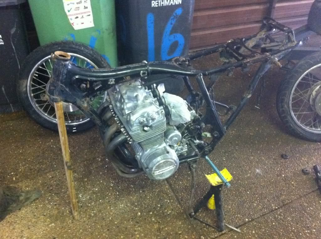

Got into stripping the bike well and truely. Fork bottoms were a bit of a pain:
Made sure all parts were clearly labeled before being stored:
Made a high tech front end holder upper:

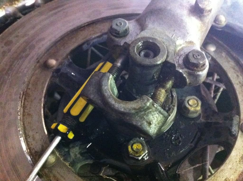

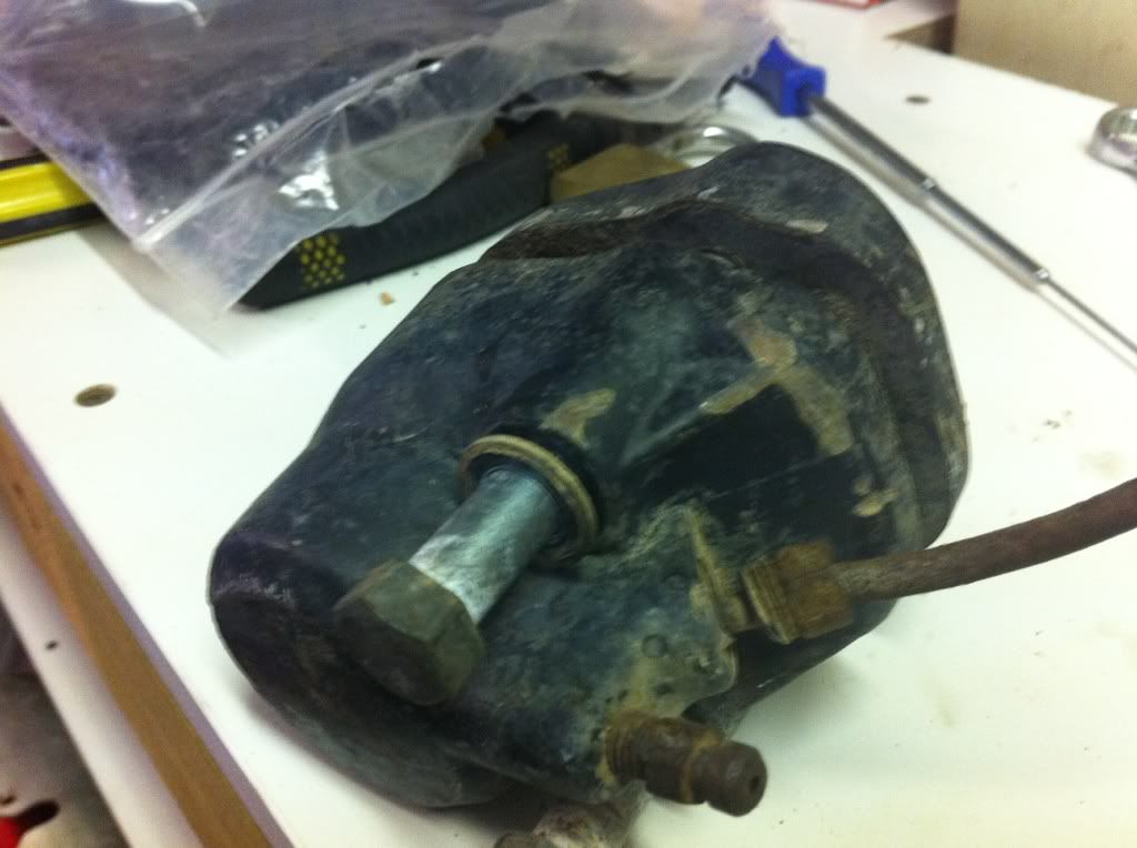

The font caliper has a metal tube running into it, this has a thread which has broken off, can anyone advise the best way of getting this out?

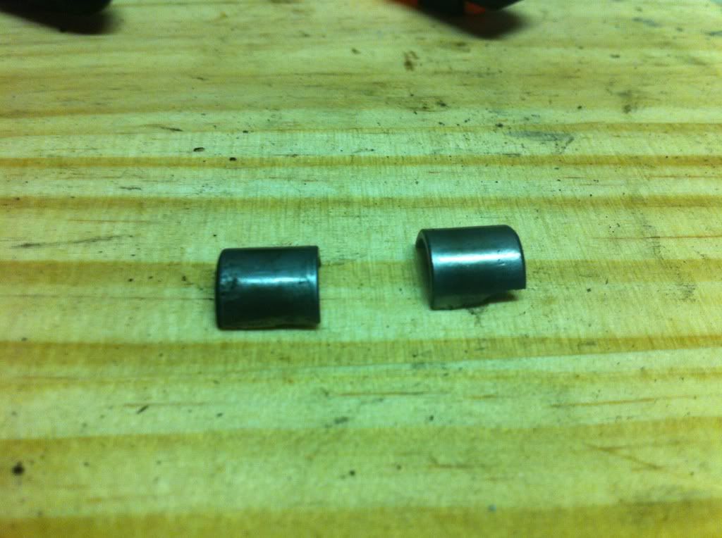

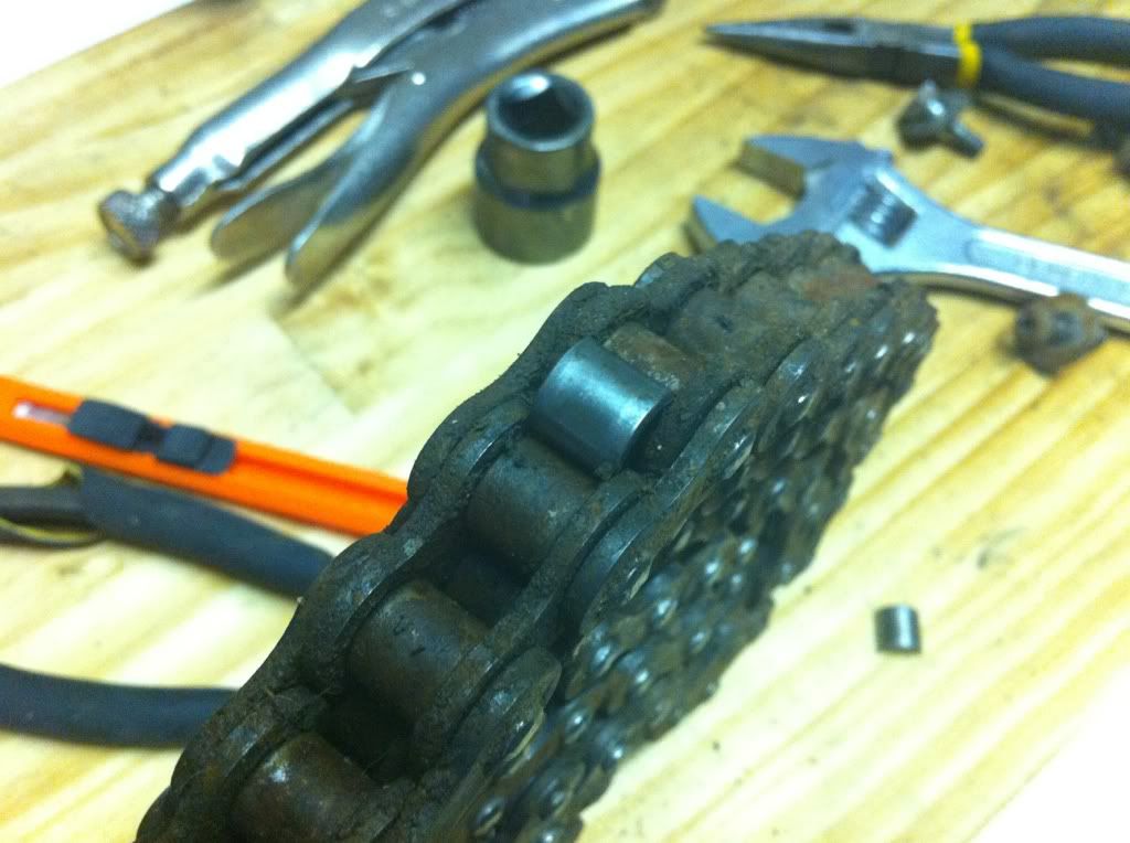

On removal of the front sprocket cover I found a few of these worrying items of metal:
I suspect it may be a broken chain link caught up in the gunk, anyone else got any thoughts? Here it is on a chain:

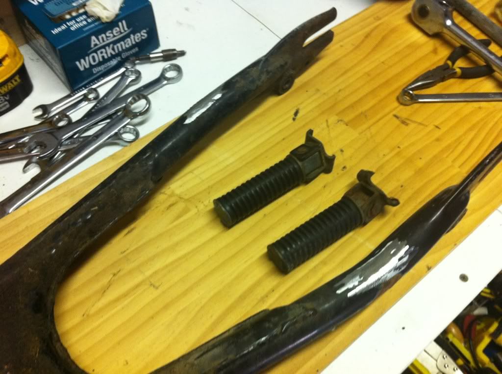

I was going to leave it there, but got the grinder out to start trimming some unwanted tabs. First up the passenger peg mounts, then some of the brackets where the airbox was:

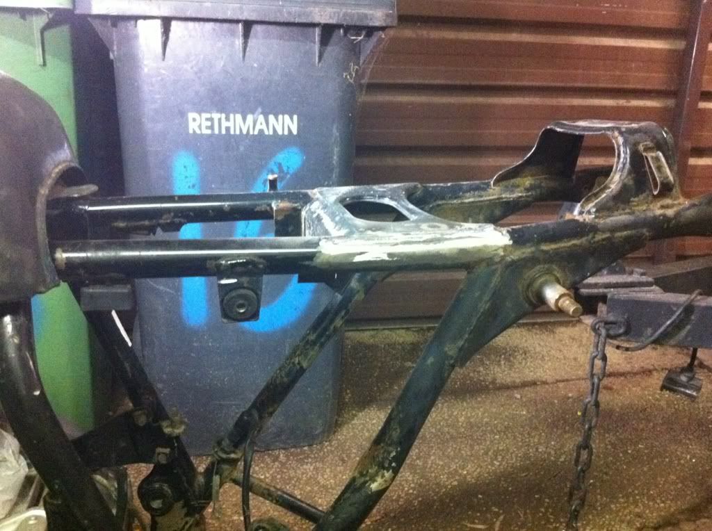

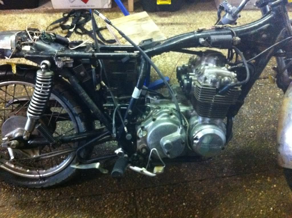

Just a little observation, but as well as a busted shock, there seems to be a bend in that rear sub-frame rail?
ian
Yep and yep. I did know about it before I bought it. Shock is easy, was going to buy new ones.
Frame I need some pointers with. There are 2 damaged sections, the one you pointed out, which has tweaked the back end, plus the section where the side stand is. It has taken a hit by a forklift and on pulling it back has crushed the frame and peeled open when pulling it back.
Luckily it's on straight sections for both. I was going to buy some same dimension tube to replace the sections along with tube that fits inside the frame tube, so that I can brace the joint when I weld it.
What do people think?

WELCOME! 400F's are a great little bike, you'll have some fun! Bugger about the forklift damage... I think you did good, but have your work cut out for you so I'm tagging along out of "Morbid Curiosity" ;)

 You can try to remove the broken threads from the caliper, but you may want to start looking for a replacement... or at a very minimum a rebuild kit.
So I assume that metal pipe is stock? And I should be able to back it out?
Will give it a go. Worst case I get a replacement.
