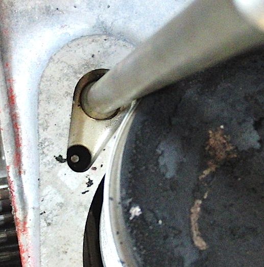

I’ll dremel the bypass as per your photo Minatureninja.

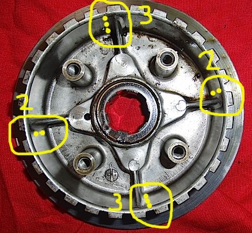

Irk, what size holes are you suggesting i drill in the clutch basket?
And what sise is ‘opening out by 1/32’ , do i drill that or file it bigger??

They're the oil passages bringing oil to the top end.  I can't remember exactly what size the holes are now, but you're just making them slightly bigger- 1mm or 1/32" bigger.
Thanks again
Steve
I drilled the headbolt oil holes out to 3/32 and used either a 9/64 or 5/32 bit for the clutch basket (basically just what fit between the splines)

Whats the point of the clutch basket drillings?
The pther two mods allow more oil flow to the head, but i dont see what the clutch basket holes do?

That and the HD clutch springs help clutch performance, especially with the bore.

as Irk said, it improves performance
it does this because it allows the oil in the clutch to flow out of the plates at RPM when the clutch is disengaged and run much cooler. cooler oil = better performance overall

It makes clutch run cooler. Oil flows through the plates all the time engine is running, (it's a 'wet' clutch) this mod directs more.  oil through the center plates so they are less likely to overheat. When you pull clutch in plates disengage and oil flushes any 'dust' It's used on 200+bhp bikes so it must do some good  ;D (although I've been doing mod since 1970's, kinda sucked trying to explain it to 'experienced' mechanics)
