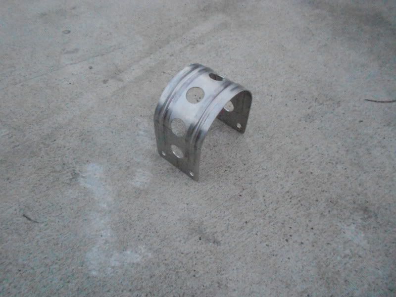

i saw the post on how someone made velo stacks from a brass goblet. got me thinking.
pressed the strainer out of the top. punched a hole in the bottom and riveted the top to the bottom. eventually ill weld a flange to the bottom of the shaker for a clamp to get a better seal
What provides the muffler effect in that shaken but not stirred creation? I love the ingenuity, but suspect it might be a touch noisy.
its not super super loud, but i was also running around for a few days with nothing. i can make a baffle for it pretty easy. just perf some tube and wrap it with fiberglass and rivet everything together.
