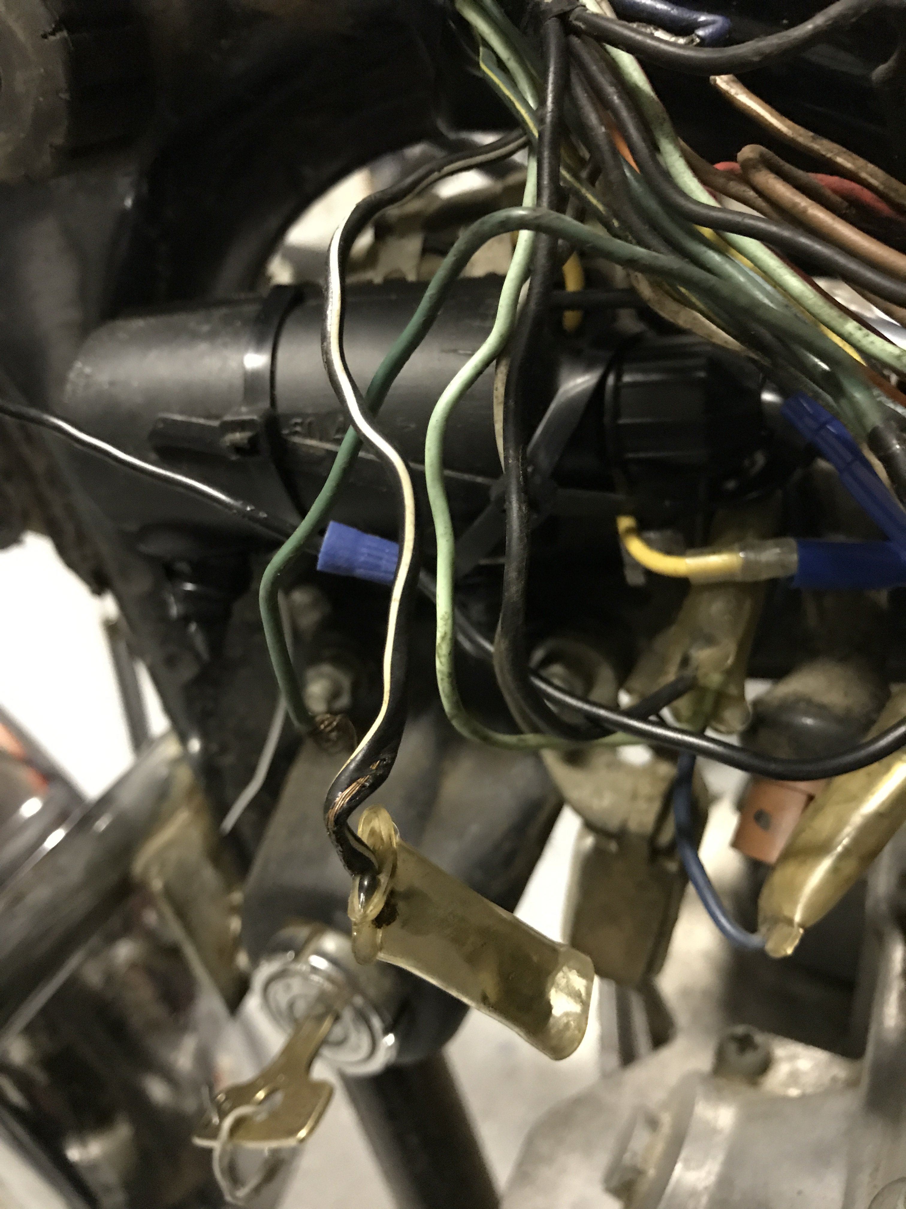

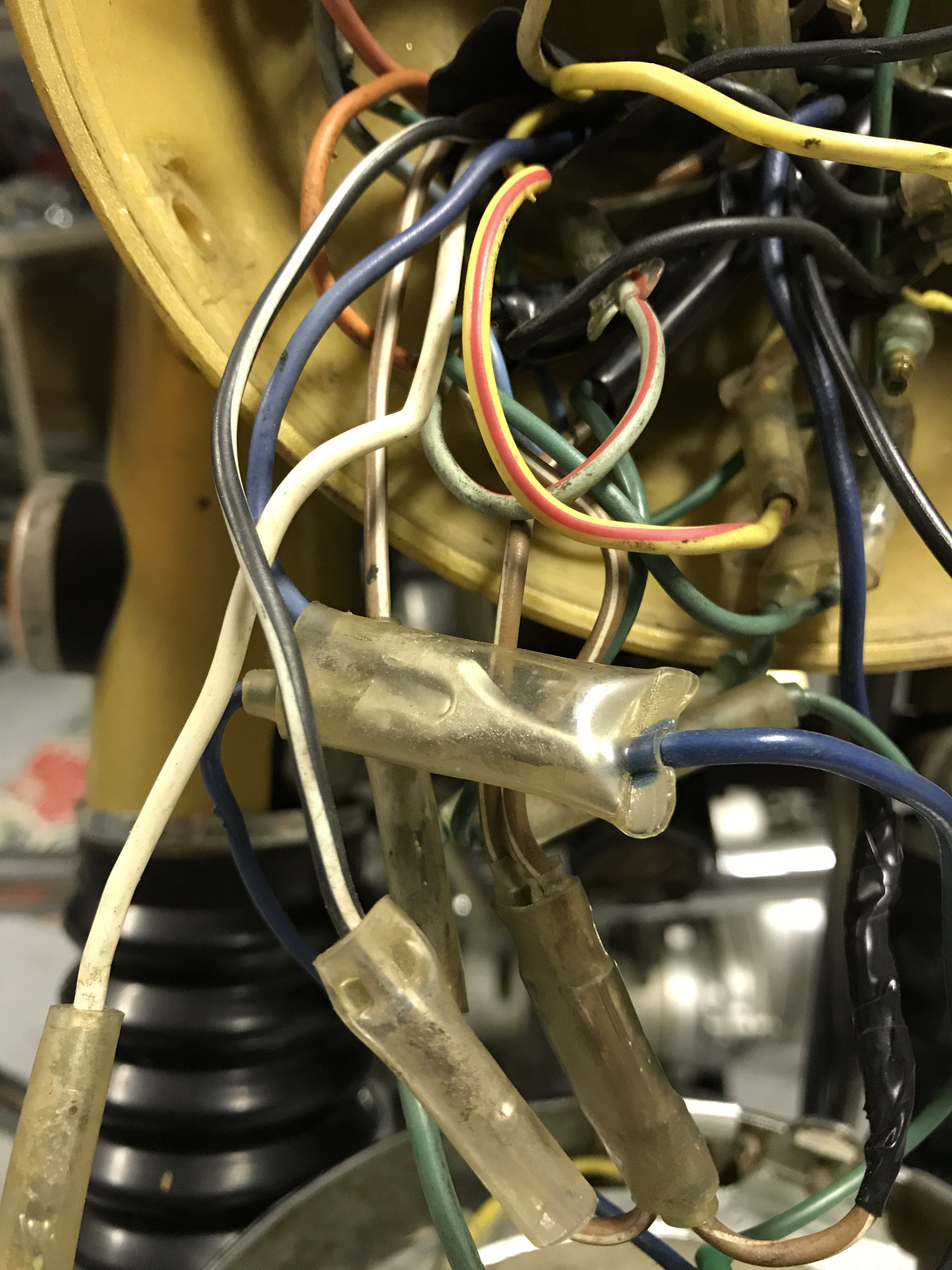

Hi Friends, I could use some help. I am trying to re make the connections and sort out the wiring on a '71 CL350 which I had to replace the handlebars. There is a black wire with white stripe coming into the headlight from the right side switches (kill switch side) and also one coming from the harness into the headlight. On the other side of the harness the bk/w ends at a double female, but nothing was connected to it. The shop manual wiring diagrams show no bk/w wire AT ALL. Does anybody know what the deal is with it? Hope I'm not just colorblind...

Ok never mind I think I may have figured this out. Looks like it runs from the kill switch to the coils. Maybe the shop manual I have covers the older CB/CL 350, but I was able to find another wiring diagram online with the bk/w.
I know this is a quite a few months late . But maybe it can still be of some use to you or others on the forum.
Cheers.
