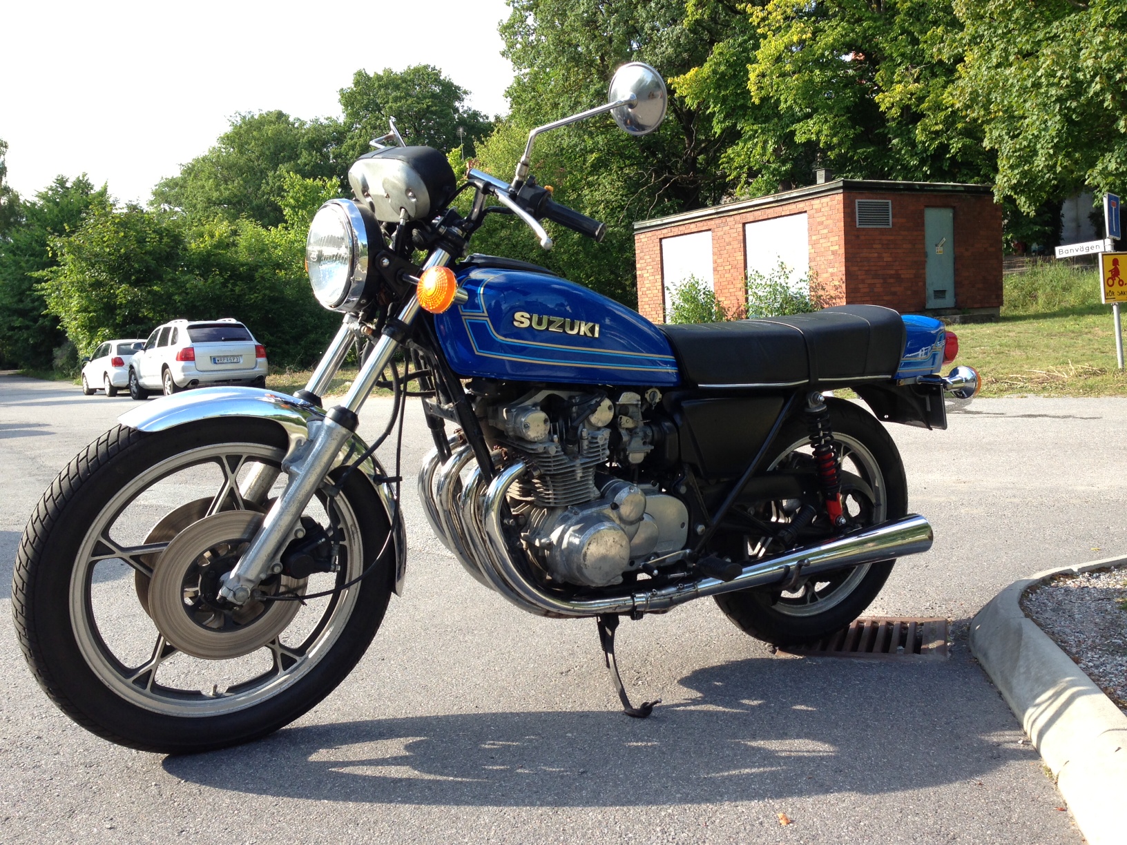

Attached a picture of my Suzuki from 1979. Bought it for 600$ and it has run 40000 kilometers.
That's a great looking GS! The 4-inline 500 was never available in the US, AFAIK. It's probably a European-only model and is basically a GS550 with a 3mm smaller bore. I'm not sure how common they are in Sweden, but over here it's a rare find. I'd refrain from being too overzealous with a grinder on such a clean example. As for the gauges, remove the plastic cover from the gauge panel and take a look at how the factory gauges are mounted. You might be able to use the existing mount or come up with an easy solution from some sheet metal.

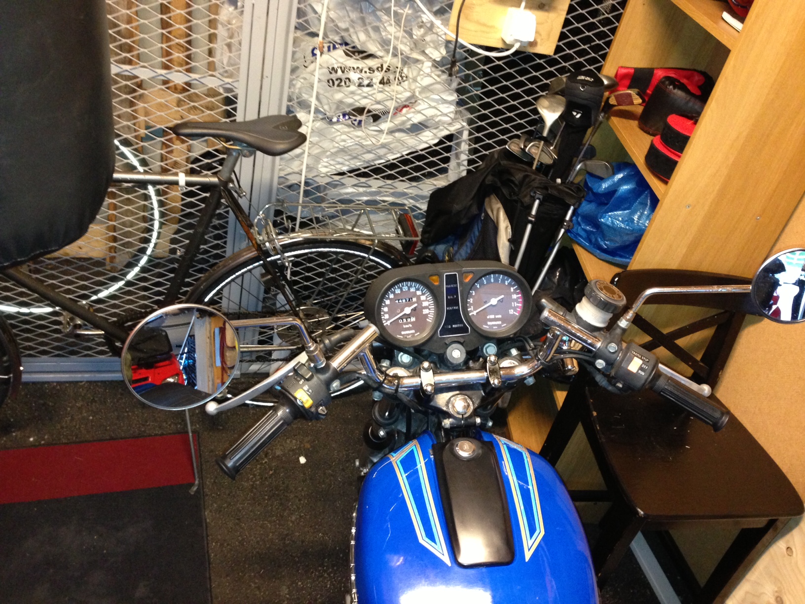

Got some stuff home from DCC and started the work on my bike. Started with stripping the seat and the gauges and mounted the new Handlebar, grips and speedometer and tachometer. Work in progress.
Take a look.

Great choice with the superbike bars. They work very well with the stock footpeg positions but can also support some rearsets if you feel like you need them. The tach and speedo mount came out well, but I'd try and rotate them closer to the center, if possible. Also, the wiring diagram for a GS550 is easily available on the web. I can't imagine the GS500-four would be much different. What kind of electrical problems are you having?

Maybe the gauges should be a little closer, i will have to make a bracket so they want be leaning. I will try to post some pictures soon when the fork-boots and the fenders are fixed. I have some work to do with the wiring of the new gauges (link) which takes a while and doesn´t show in the pictures. The step after that are the seat + rear frame. Should it be round like the rest of the guys do it or should keep the original frame and not cut into it?

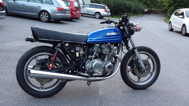

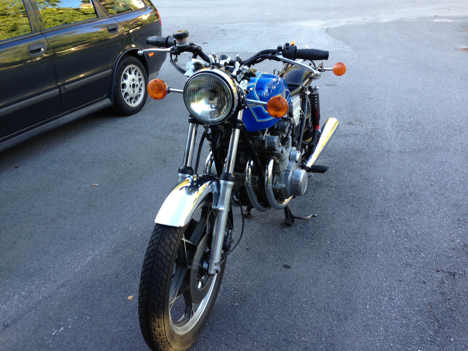

Cool! This weekend i took away the front fender, i managed to connect all the wires correctly so now the gauges work. I also cut my rare fender and mounted the back-light and license plate. You have to tell me if it dos not look OK.
I put the original seat back so you can see the whole picture.
Things left:
Spray the side covers black.
Change the tires (fatter with different tire tread)
Mount the Fork boots (if it collects water i will cut them off)
New seat. Can i use the original seat frame? If i take it to a custom shop that makes leather and seats?
New exhaust?
Exhaust heat-wrappers?

Running without a front fender is not really practical (you'll find out the first time you ride on a wet road) but if you must go without it, you should add a fork brace:
The stock fender has an internal fork brace and if you remove it without replacing the brace, your handling will suffer.
New tires are definitely a good idea, just be aware that the stock forks, swingarms and wheels on your bike were not designed to fit wide rubber and the stock power output doesn't require them. Find out if you can go wider than what's on there now (usually only a size larger than stock) and get some the best tires available in that size. You will see a big improvement.
