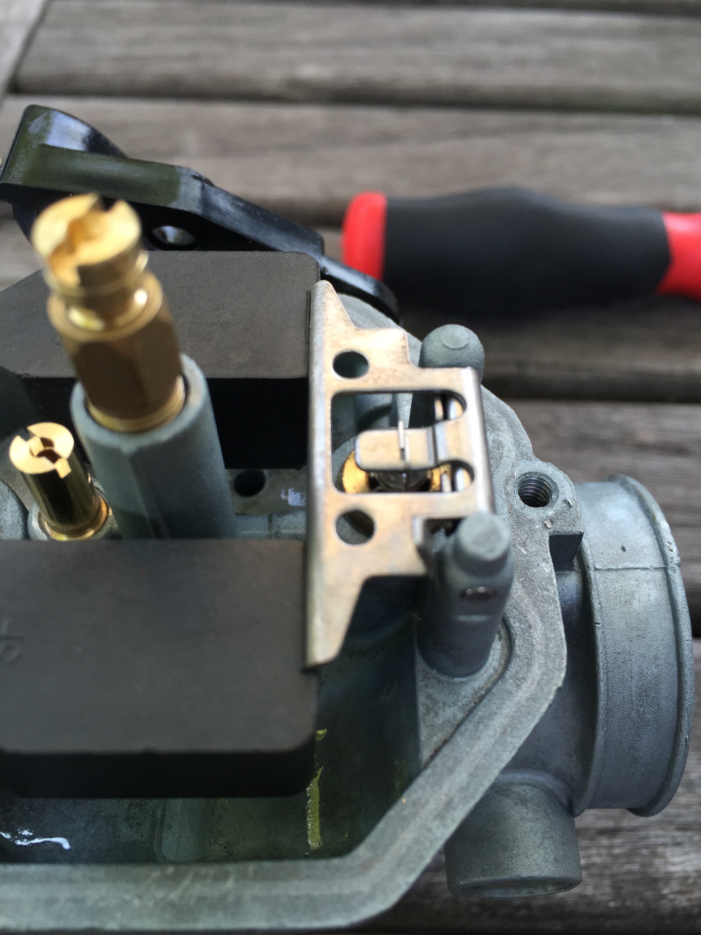

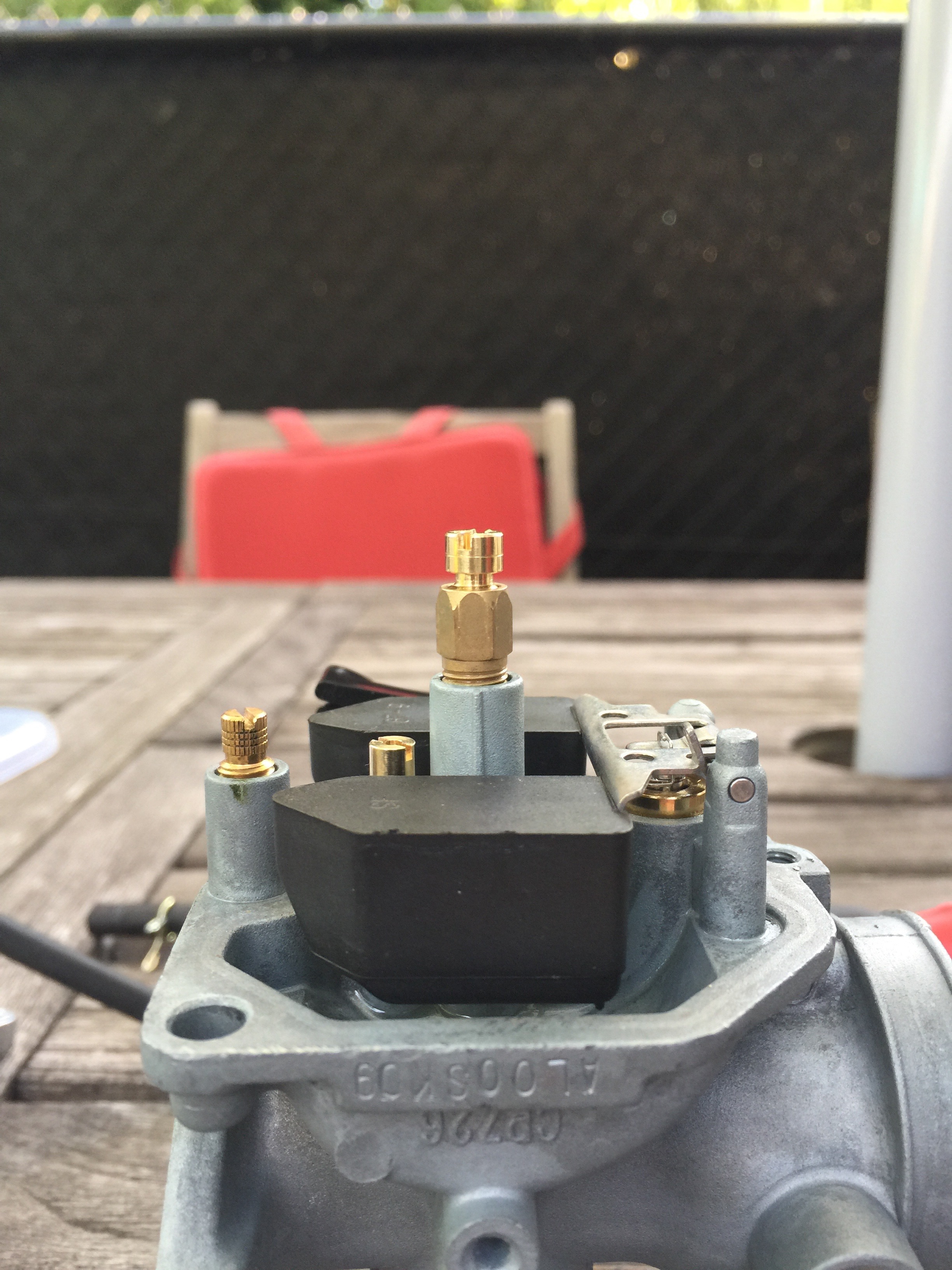

First of all, i completely miss-installed the pilot Jet. The stock was also the 3-peice, and I fitted the OOracing one, in the middle part and screwed that one in.. Took everything out again and fitted the OOracing pilot jet one as a single piece as it should. Startups are back even with warm engines!
I do seem to have an issue with the main jet: The stock one was labeled 90D (although it might also be a B). and the OOracing one is also a 90. But i couldn't screw the OOracing one al the way in. it kept sticking out for a couple of mm's. (See my pics below) Also the OORacing one is thicker then the stock one. As i didn't want to mess those things up I refitted the stock one and decided to take it from there.
I will be replacing the main jet after i fit the new exhaust and when i have ran some more miles.

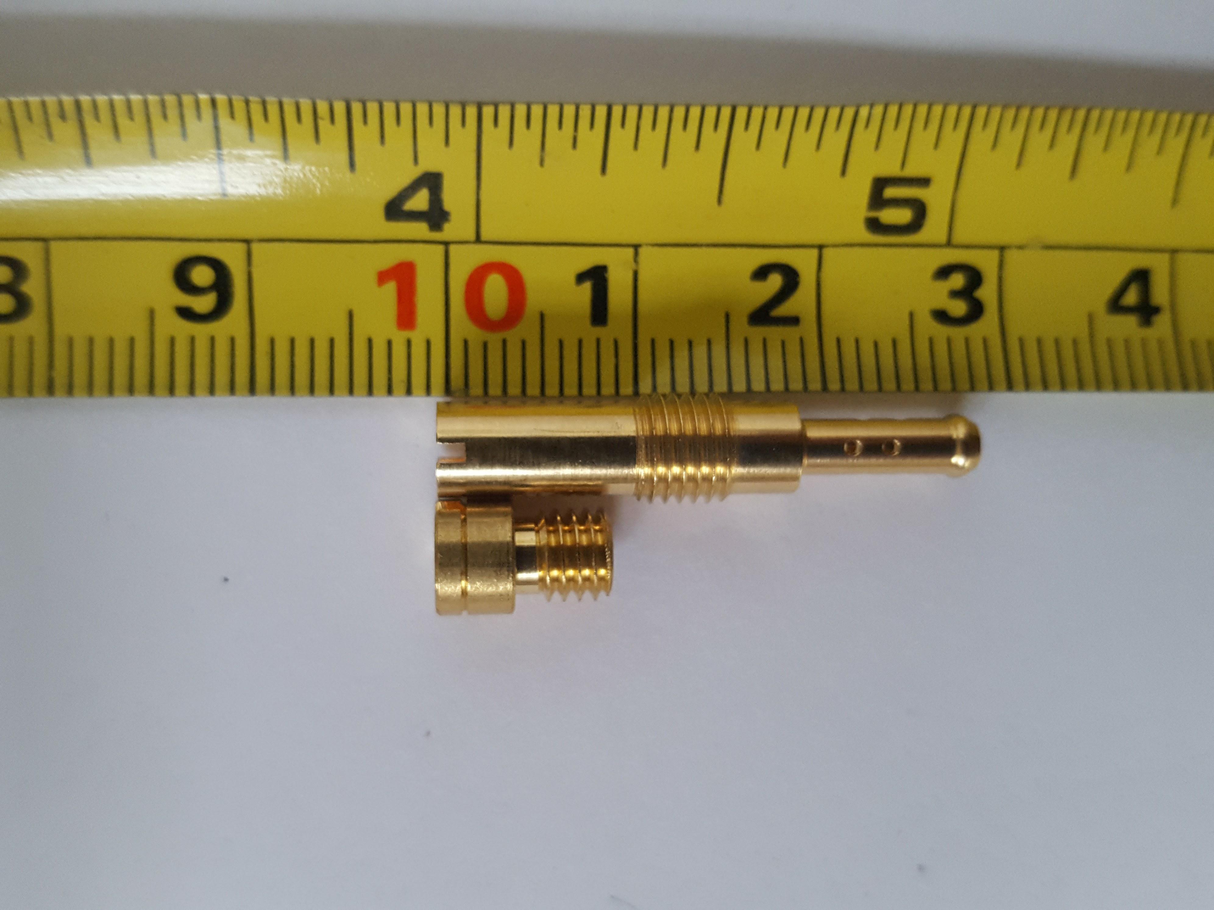

Hi Guys
after my rear axle was destroyed and I ordered some things macigly the tune up kit 303 was in my Shopping cart. ;)
last week i rejettet my engine but because there was no Manual at all (and i dont know anything about motors) i really didnt know what to do....
and after reading everything here about rrejetting im quite unsure if i did it right
These are the Jets i removed, the longer Jet is now much shorter is this OK?
or do i have to do it again
i dident try it out yet because i dont want do damege my ace again
Thanks for your help, and sorry for my bad english
Cheers Mike
Oops
Long one is shorter and one piece. Really short one is the center one , main jet, and looks similar to what was taken out. Should be fine.. You may need to adjust the idle screw for really good idle. This is the hardest bit.
It is under the carb on the edge of the bowl.
You need a short tiny screwdriver to adjust. ( to make this easier , take a short bit off breather hose on carb or fuel hose or vacuum hose, 6 to 7 mm , and slip over head of screw. Stops screwdriver from slipping off screw. Turn idle up on warm running motor by a few hundred revs with the idle set screw on side of carb. Then adjust the screw under carb till revs drop in both directions. Set it in the middle of these two points. Return to normal idle. Leave bit of tube on screw. Won't harm anything. This will give the best tune . Hardest part is finding a little scewdriver

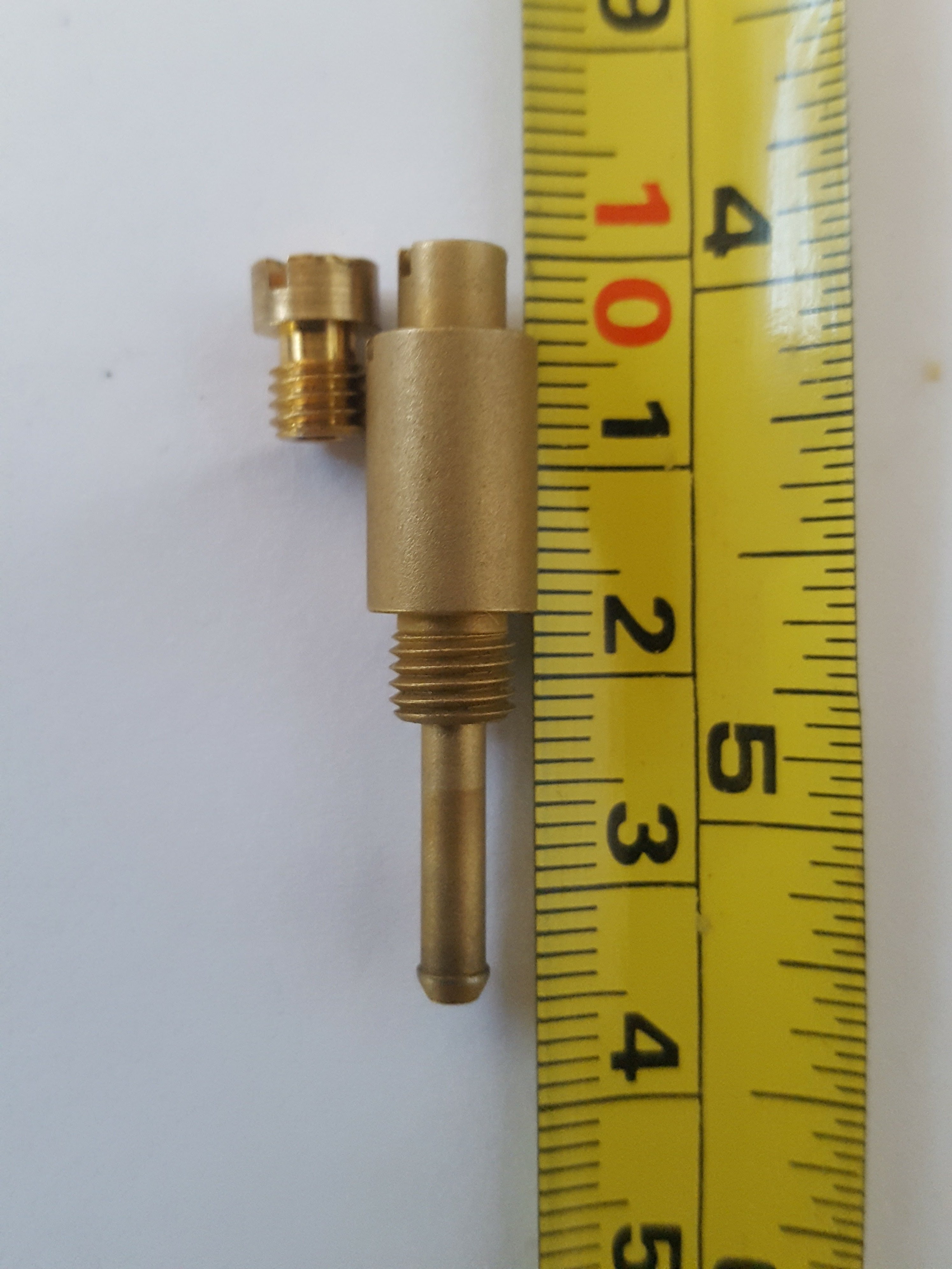

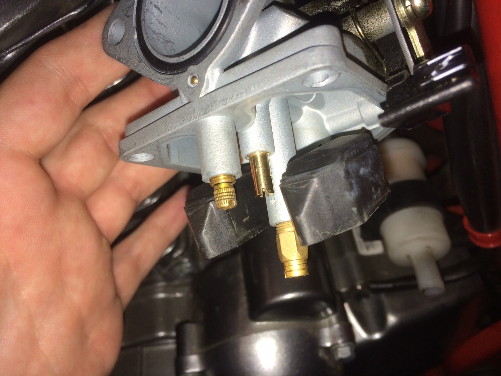

Hi guys
its me, again ;D
I was no able to get my motor to run smooth so i thout i did something wrong so i reopend the Carb to ask you again if i did it right$
with phots now.
thanks for your help
The top jet in photo should be just the be the new part. Not two bits??
if you haven't already, have a read here
https://docs.google.com/spreadsheets/d/1USvziYIyzfyxfZA1YYpQf9eP4djb0GLWbvWcmME88Gk/edit#gid=1
Unsure from your photos and description but...
"Not sure if the pilot in mine was standard when I got it, but it was a 3 piece construction. The OO racing pilot that I received was a 1 piece construction. The three piece unit needed to be discarded, I then screwed the one piece unit directly in to the carb."
Ok i orderd the kit für the standard Air Filter
and i only can fit this thing with the bigger one on the underside
if I`m right you got this jet?
but is this Jet maybe just for upgraded airfilter (Pod filter)?
whats should i do now?
i just installed all the other things from the 303 tuning kit :-[
Cheers Mike
OMFG ^^
I`m so dumb
mabye i hat one or two Beers to much as i installed the kit
i just had to remove the fat tiny part and put the pilot with a bit force in
Now i can go on :D

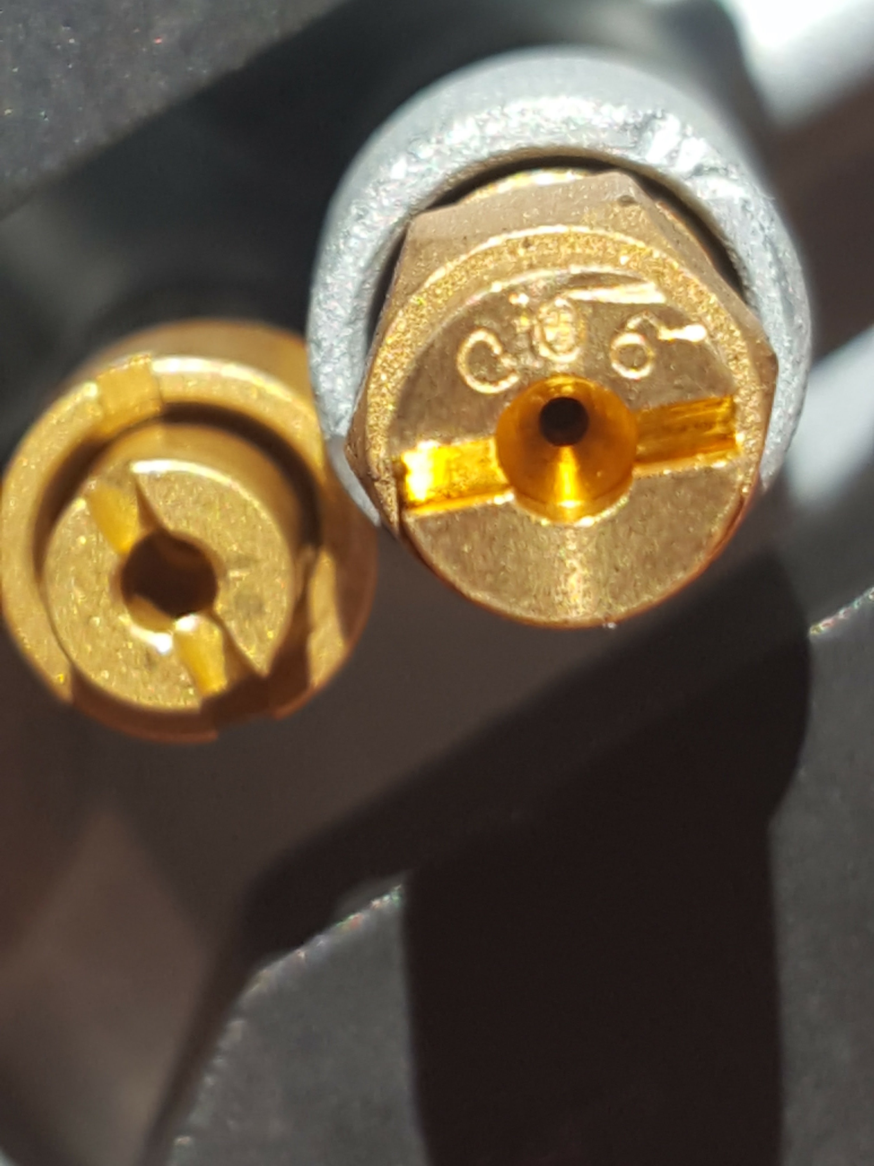

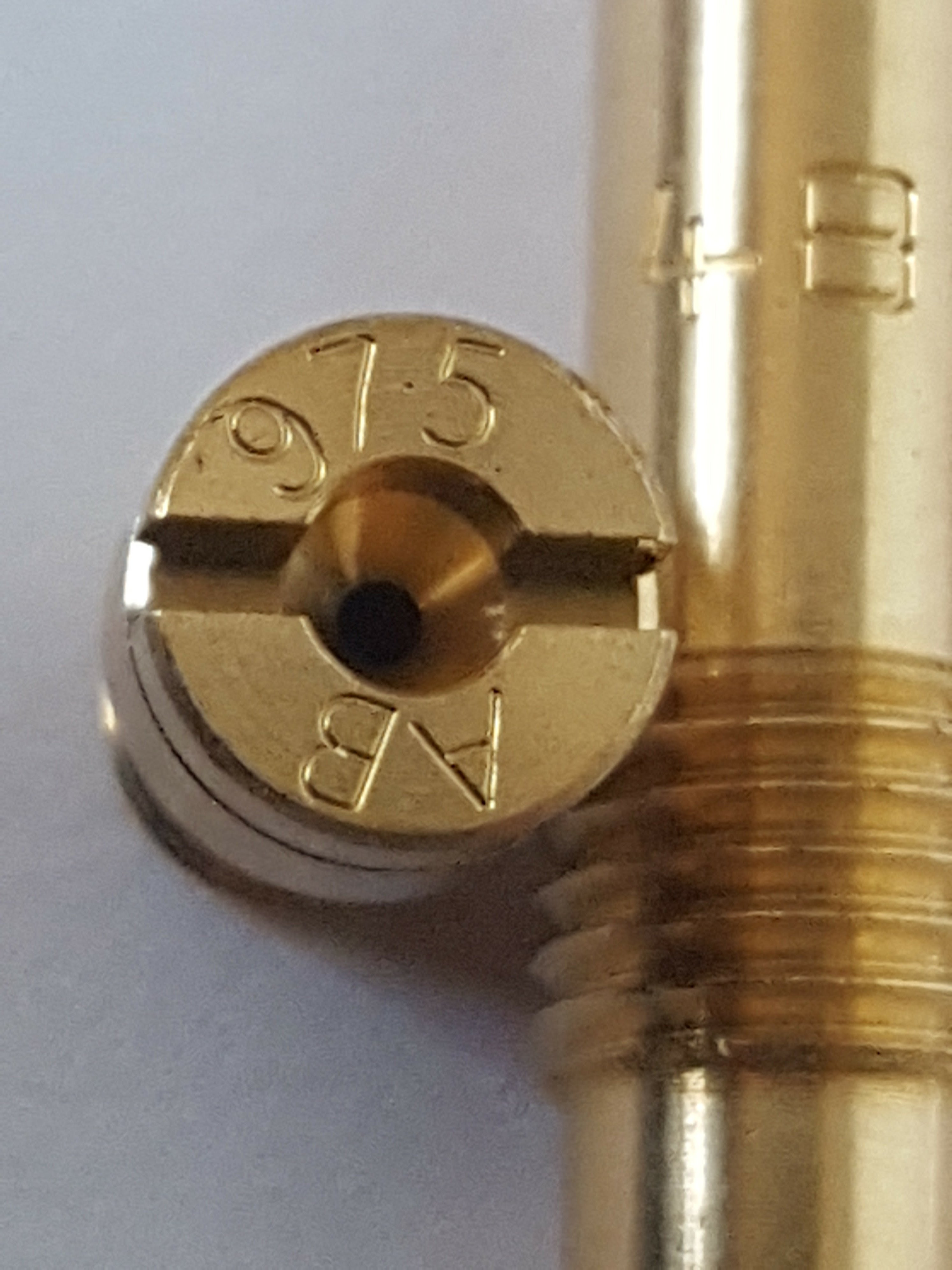

Saturday's job is a rejet. Removing stock jets and replacing with 48 and 97.5.

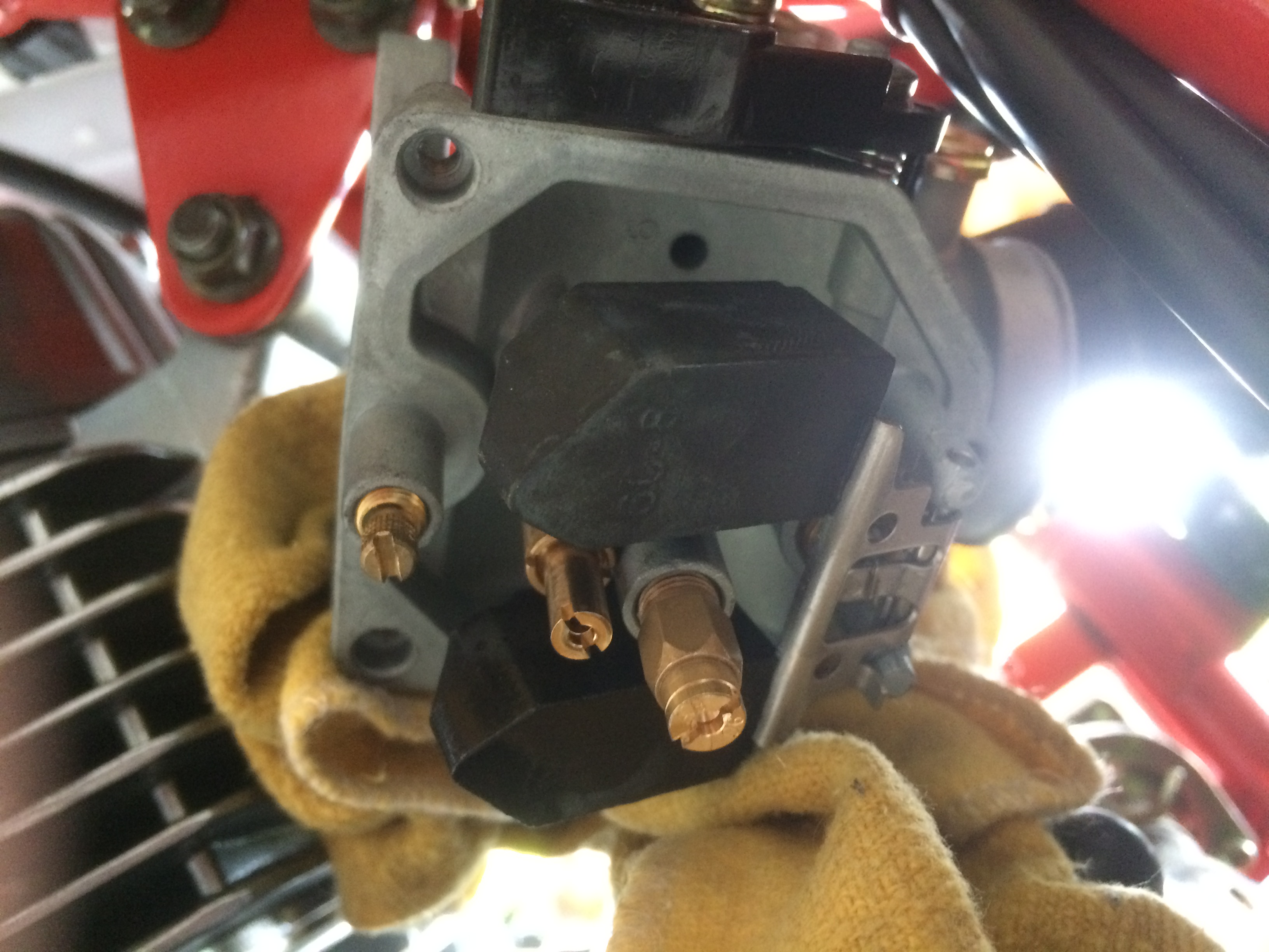

Rejetting stock Carb on Ace 125
OK, job done. 20 minutes including 5 to find tools. Too easy.
The fact that I'd already stripped the centre and was already running a pod filter made the job easier.
Removed fuel line and the choke mount and did not touch the throttle cable. Drained carbie, unbolted the double locks (10mm) on the carbie/manifold and tilted the carbie out to the RH side.
Three phillips screws drops the float bowl. Watch that the float pin doesn't fall out if you have the carbie on a horizontal plane. Also note 2b's warning regarding the retainer clip on the float valve.
Unscrew the two jets and replace. Reattach bowl, remount carbie on manifold, reattach choke mount. Put fuel line on, turn on fuel and start the bike.
2b's instructions are very good and worth the read 2 or 3 times before beginning and it will be OK and easy.

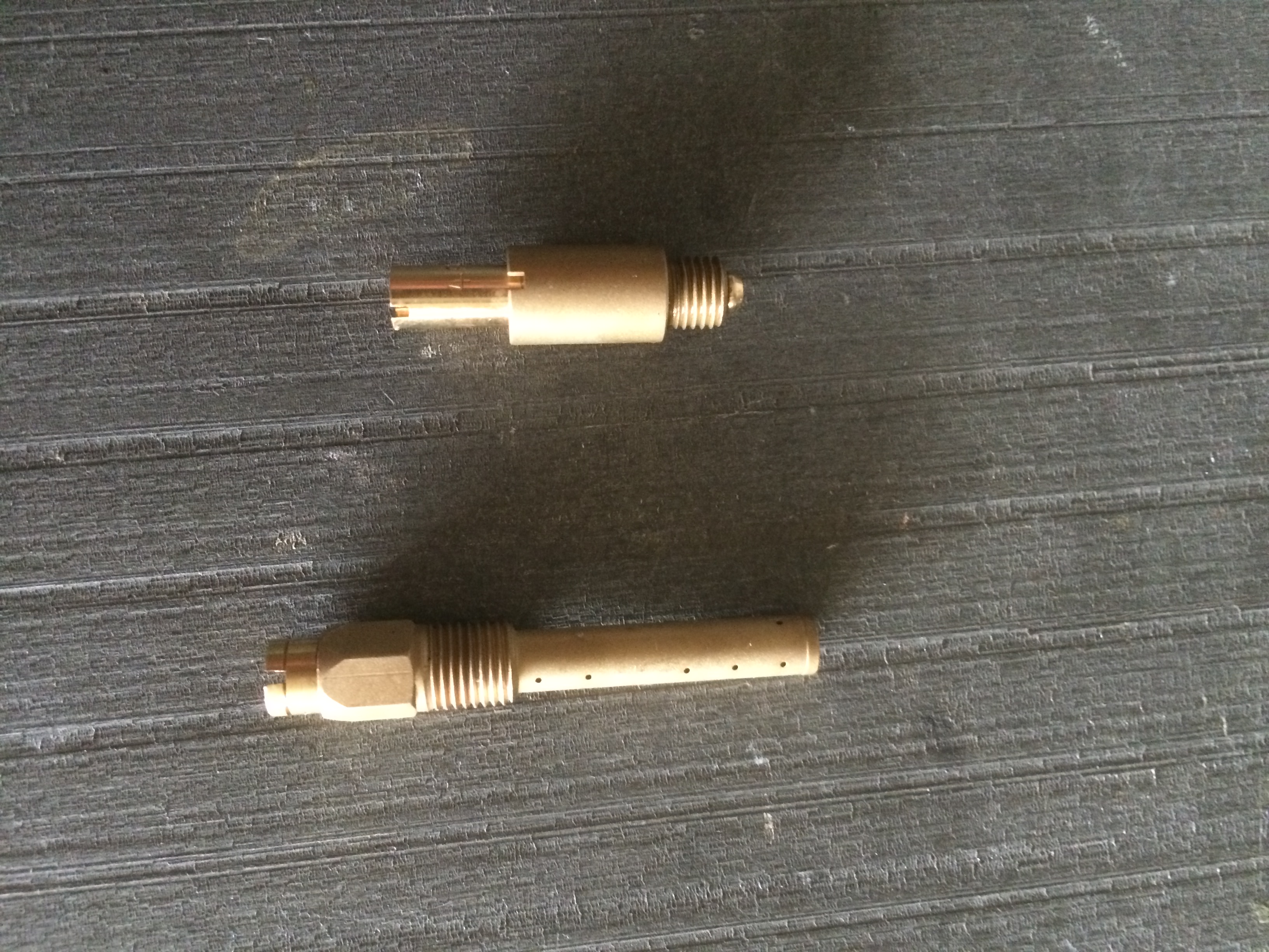

Two pics of the stock jets which I removed.
