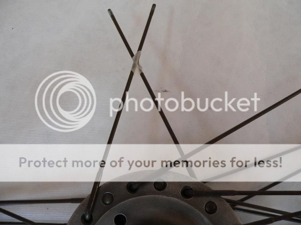

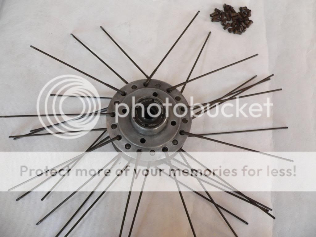

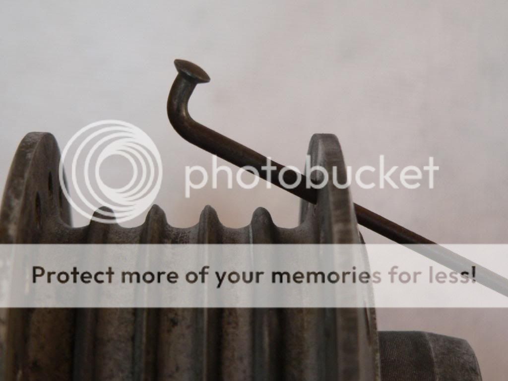

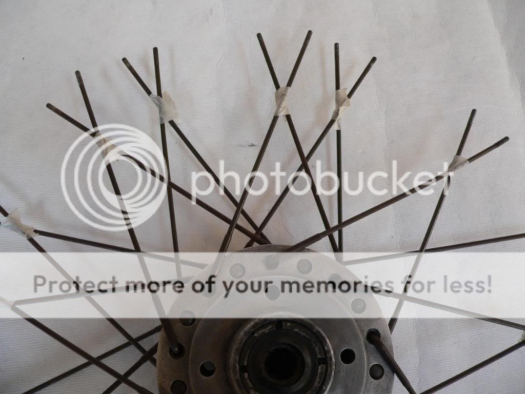

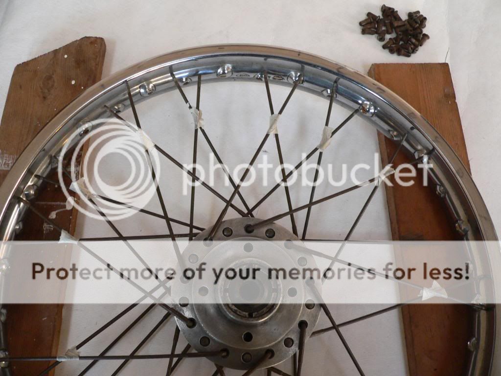

Nice work man really enjoying this thread hope this helps to

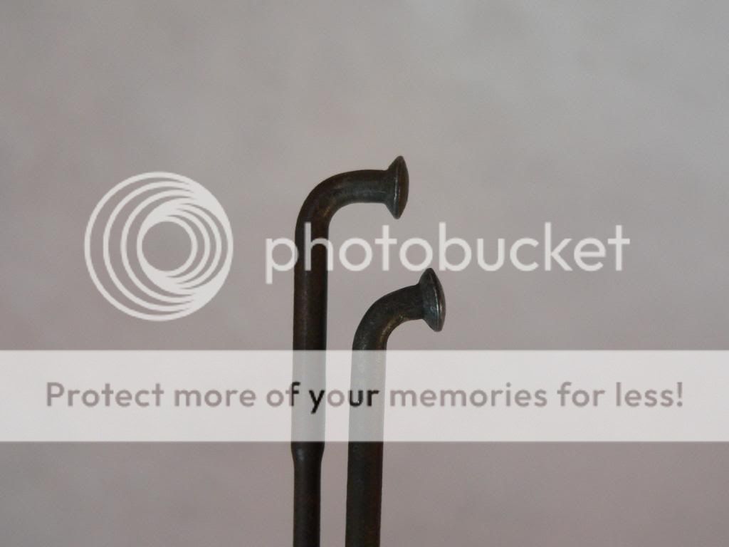

The longer bend gose from the inside out
lace all the wheel then lay it flat
start with an inside out spocke then count 5 to the right cross this one under the other and tapeit in place
go all the way round both sides
where the brake disc gose i put 20mm wood blocks to raise the rim inline with the spockes
this methared was used on my caferacer with borrani rims
hope the helped and not nindered!!!!
