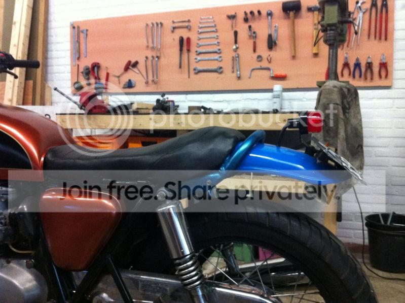

Do you mean something like this perhaps?
If not, OpTiCs is right, pics would be very usefull to help you more.

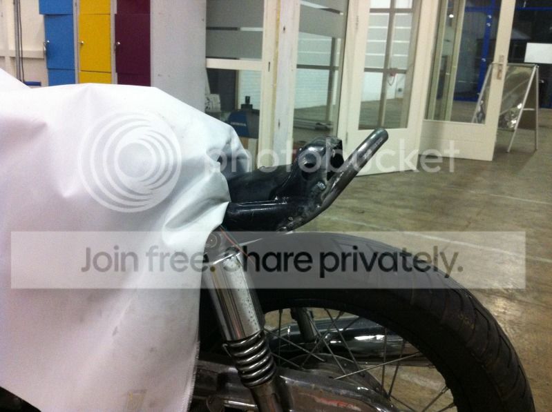

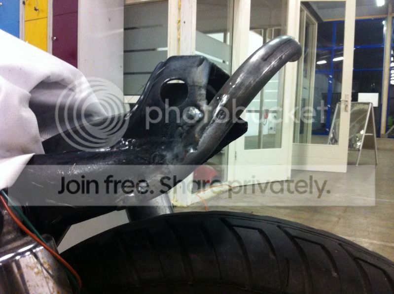

I used a handsaw to cut of the frame. One side first and used the chopped part to draw the saw-line on the other side. That way they're about the same. I then used some tubing i pre-bended at school using a big bender. I sawed the tube linear so that the piece remaining covers the hole created by chopping the frame.
I hit the remaning part with a hammer so it got flatter and fitter nice over the frame-cavity.
I sawed and filed it in such a way that it fitted snug everywhere and then sawed the other side the same way. I then welded everything together and sprayed it with epoxy (hence the blue..) it's now black.
