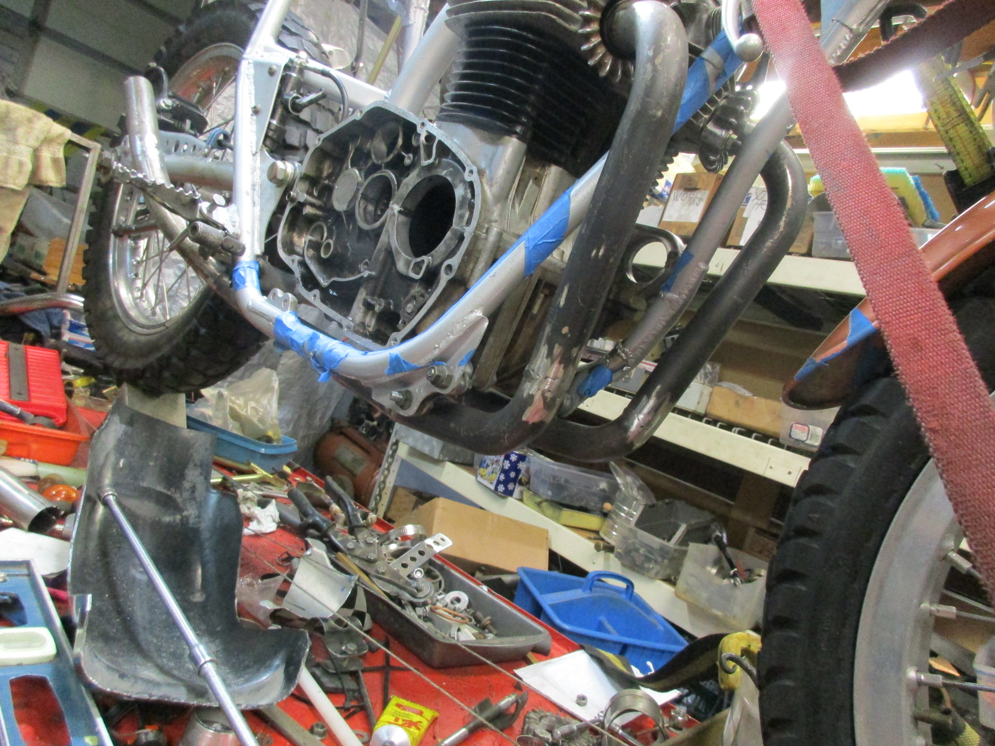

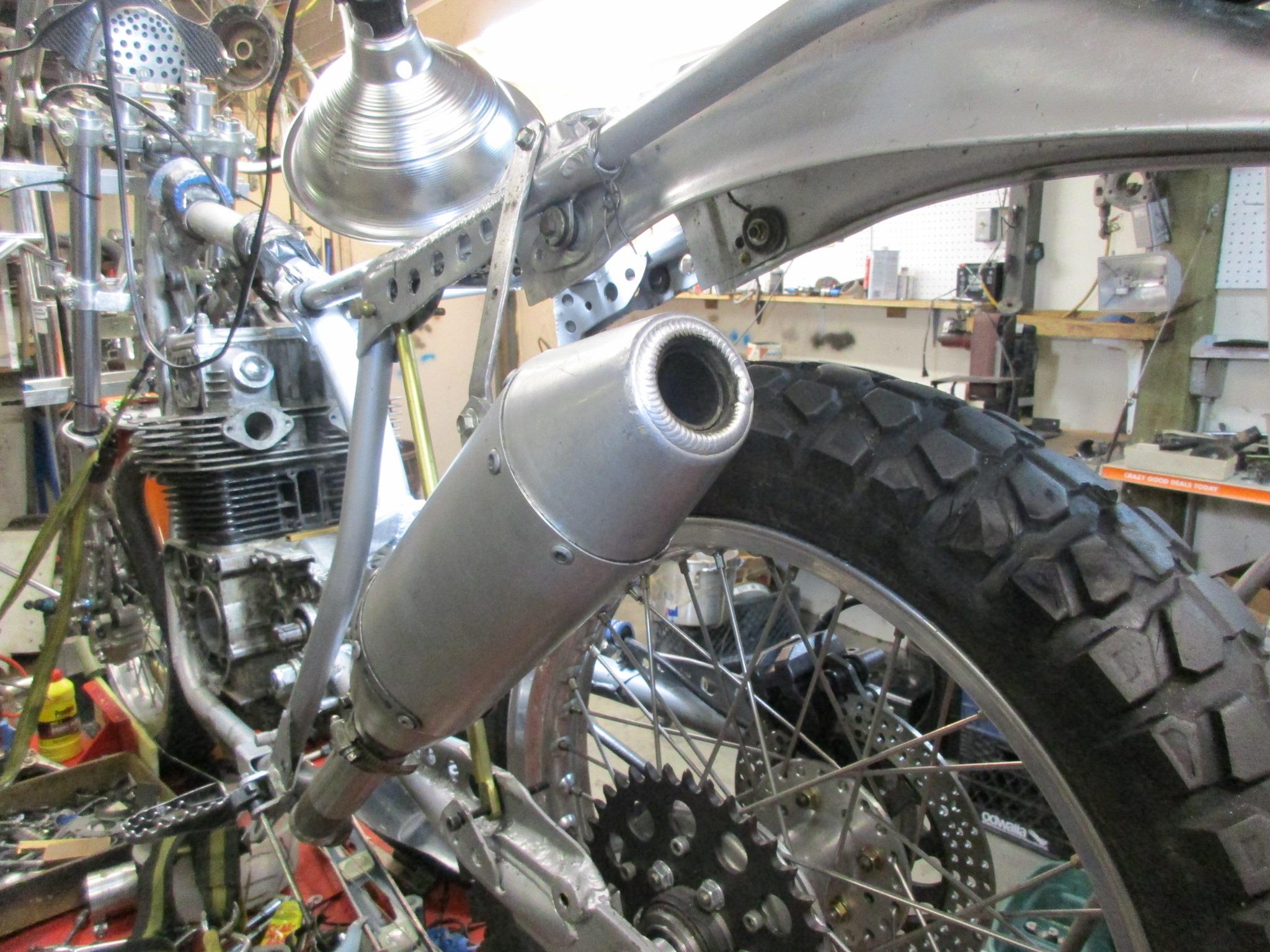

right i been waiting gonna contribute a build of a 350 twin dualsport dakar \
what really made it possible for the project finish was my storage facility keeprs turned me on 2 2 sweet pimp china clones just left em for me :eek: :) :-*
look at all the usable parts
i am going to try one of these rtotors on the rear
had the frame blasted 48 hrs it wikll get the final coats
no wire feeds will be used nope flame is all we need
e start only
frame deraked to 26.5 fit cb/cl cases
wheel travel of design is around 8'" front and back
seat rails were cut off and raised 2""
\swingarm now sports 1rst gene4ration forward mounted shock geometry ala gp 74.5 maicos and early penton ktm inspirerd formed speedi holed stiffers it is not that good of a lashup as far as how it actually perfomes buy i was going for stance ya bums
i skip welded it and got drunk an fillet brazed it why ? cause i was drunk toTALLY FRIVOLOUS

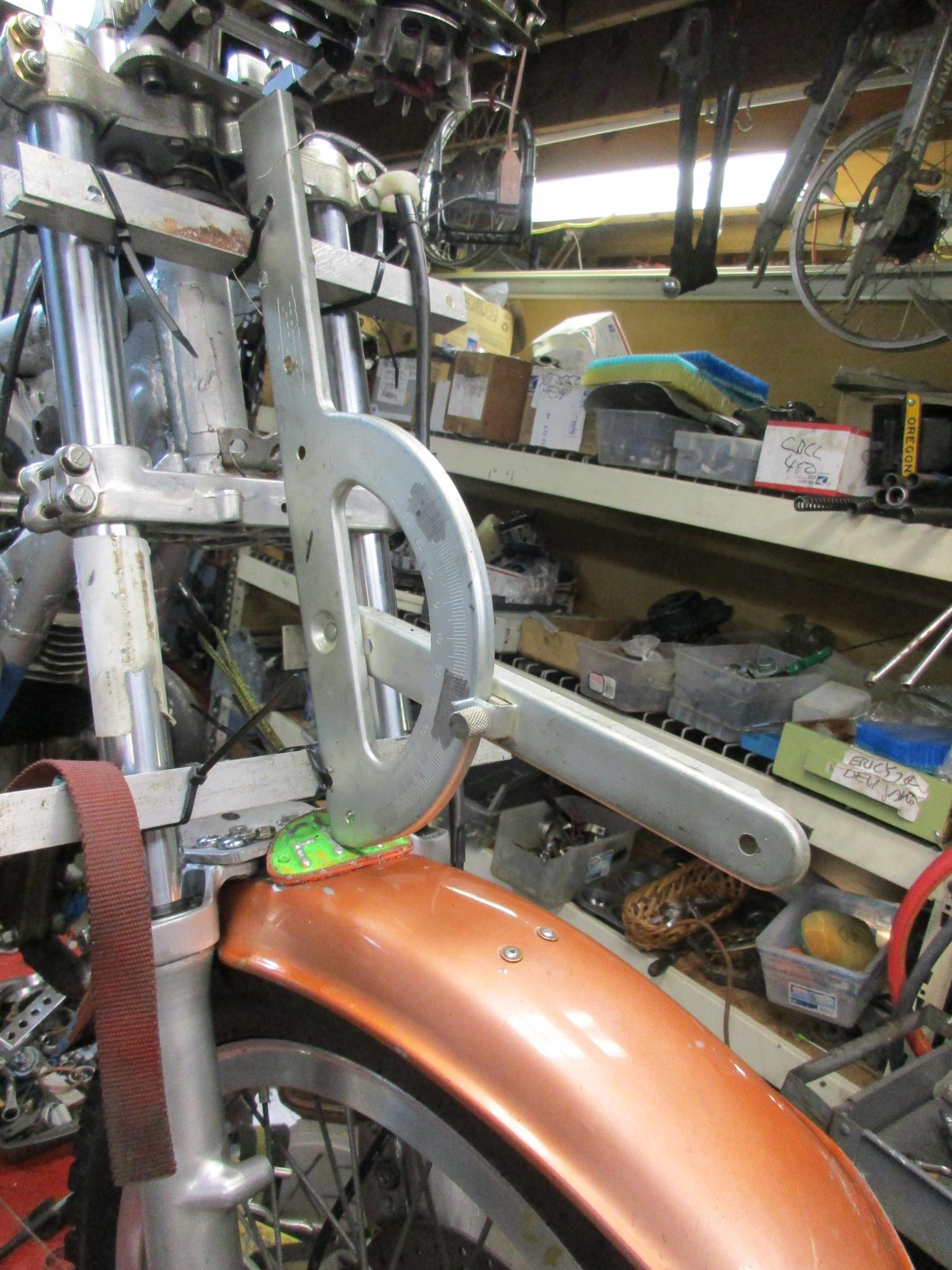

i should have added the footpegs moved back 3-4' up about 1'

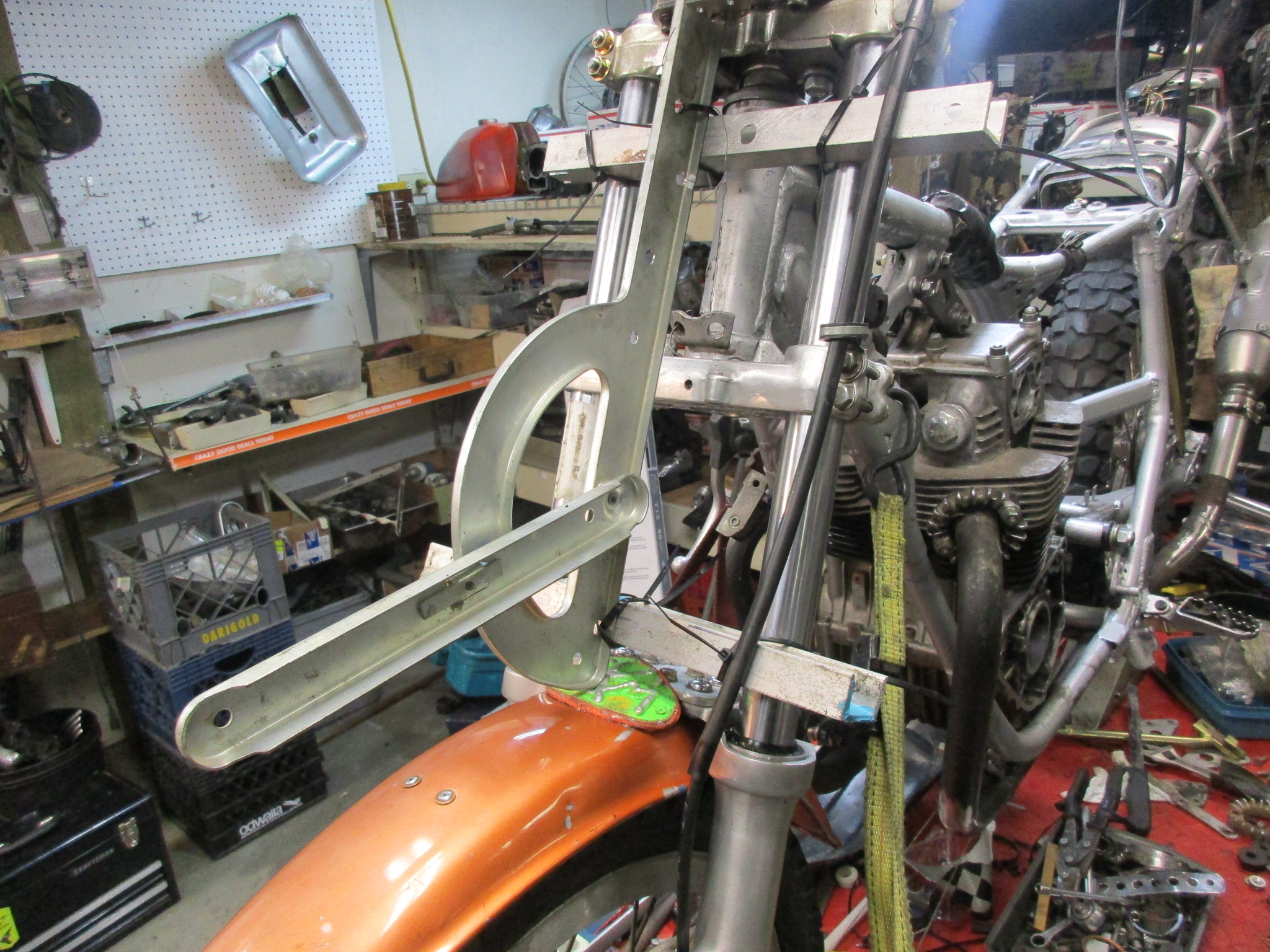

the forks will be bitsa's mix n matched parts i wanted a fork brace and i wanted some flex just like we had back then the sliders are virago with the buiilt in fork brace ,caliper bracket
brakes; all pumps and clatchipers are brembo and the stanchions and damper rods will both be cut down in length they are 36mm thinwall 1979 klx stanchions gold valved ,very light stanchion tubes its amazing how much thicker a virago stanchion is
i have 3 different offset triples to try i knew i wanted 26,5 head angle now on final assembly i will dial in a trail number i want by choosing offset and test riding
of course forks will be fit new shimmed DU bushings, as will the swingarm Pivot, big ass du bushings

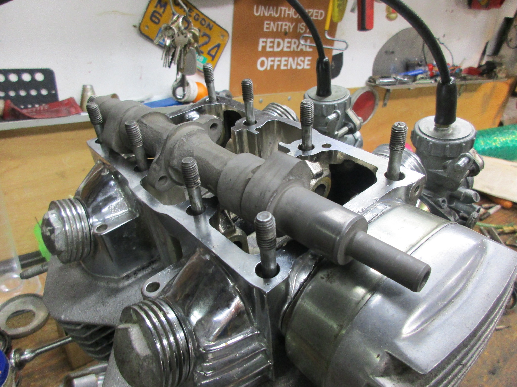

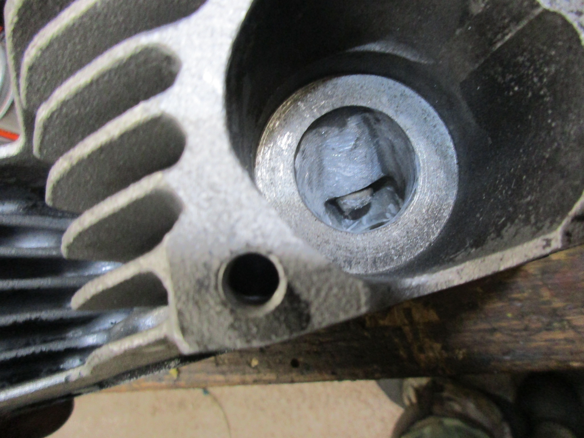

and last detail for today spud mandrel turning cam journal gasket faces
on these parts i did not use a bolt to pull the jounal up tight but hollowing out the spoud alloews a very snug fit i am only skimming .002 off of these and friction holds them for turning
and again a draw bar thru the headstock so the spud is absolutely secure
for the tacho drive one i just put it on ,lface in and used a diferent tool from backside to cut face

this is a situartion where the part becomes a piano if you let it the harmonics will get out of control i was only able to go .001" at a pass but they werre fast paced feed wise less than 4 total minutes turning per end
this setup,would not be suitable for fabricating from scratch it is hanging to far from chuck for serious cuts it would need a angle plate on a face plate

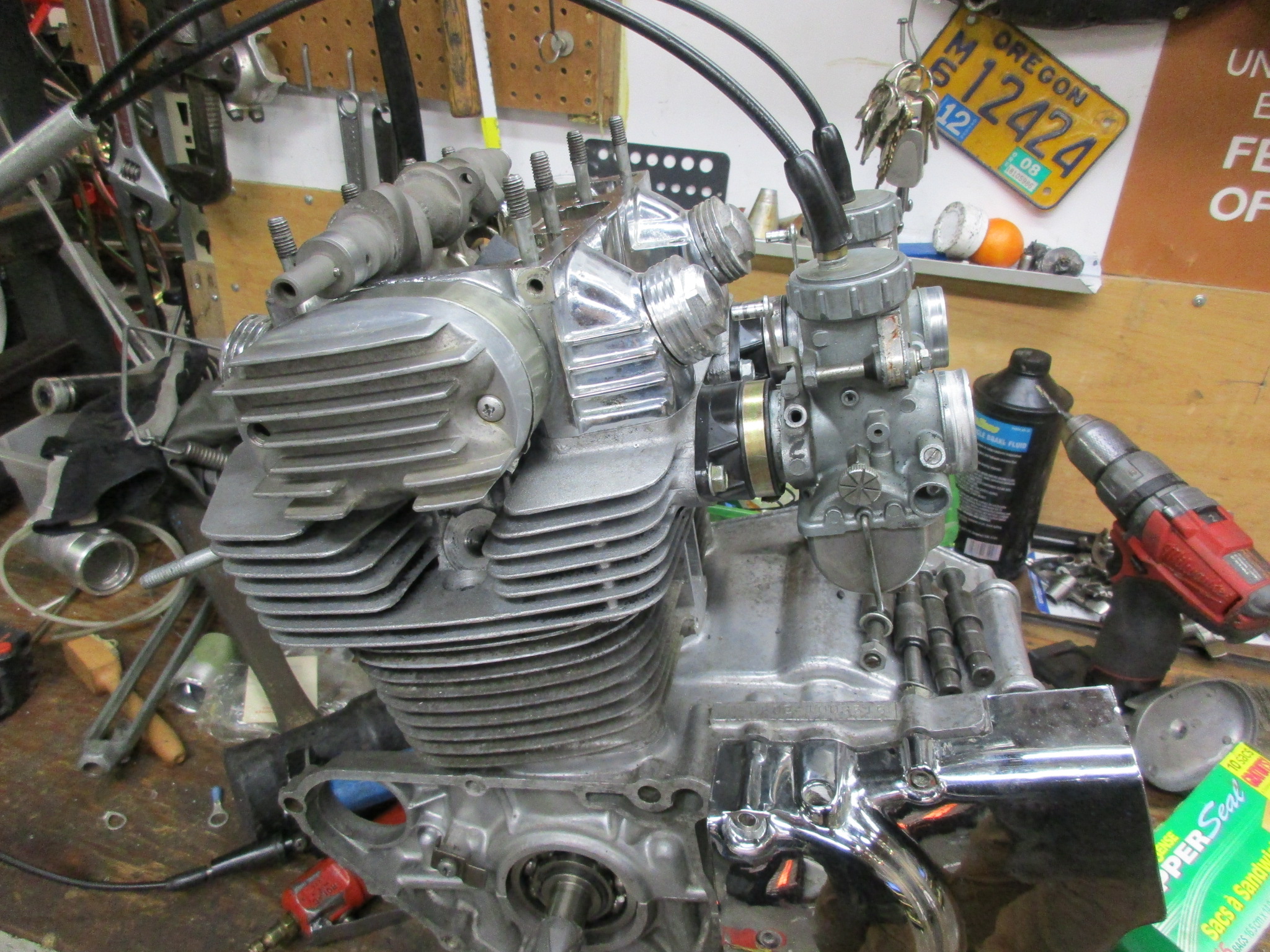

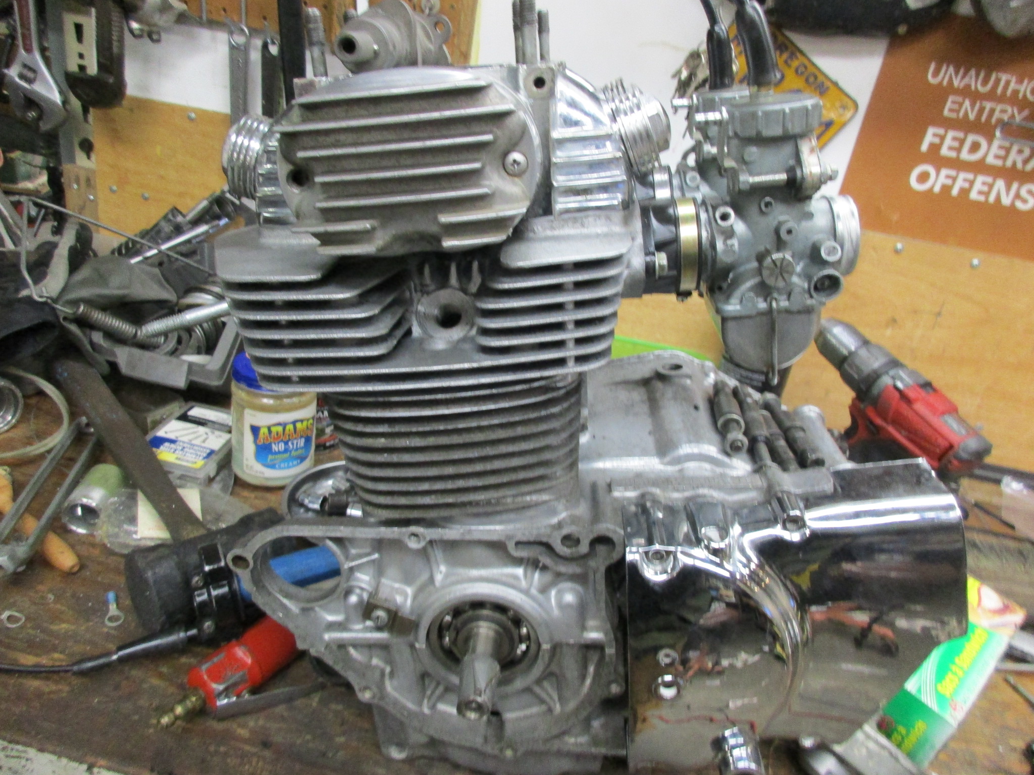

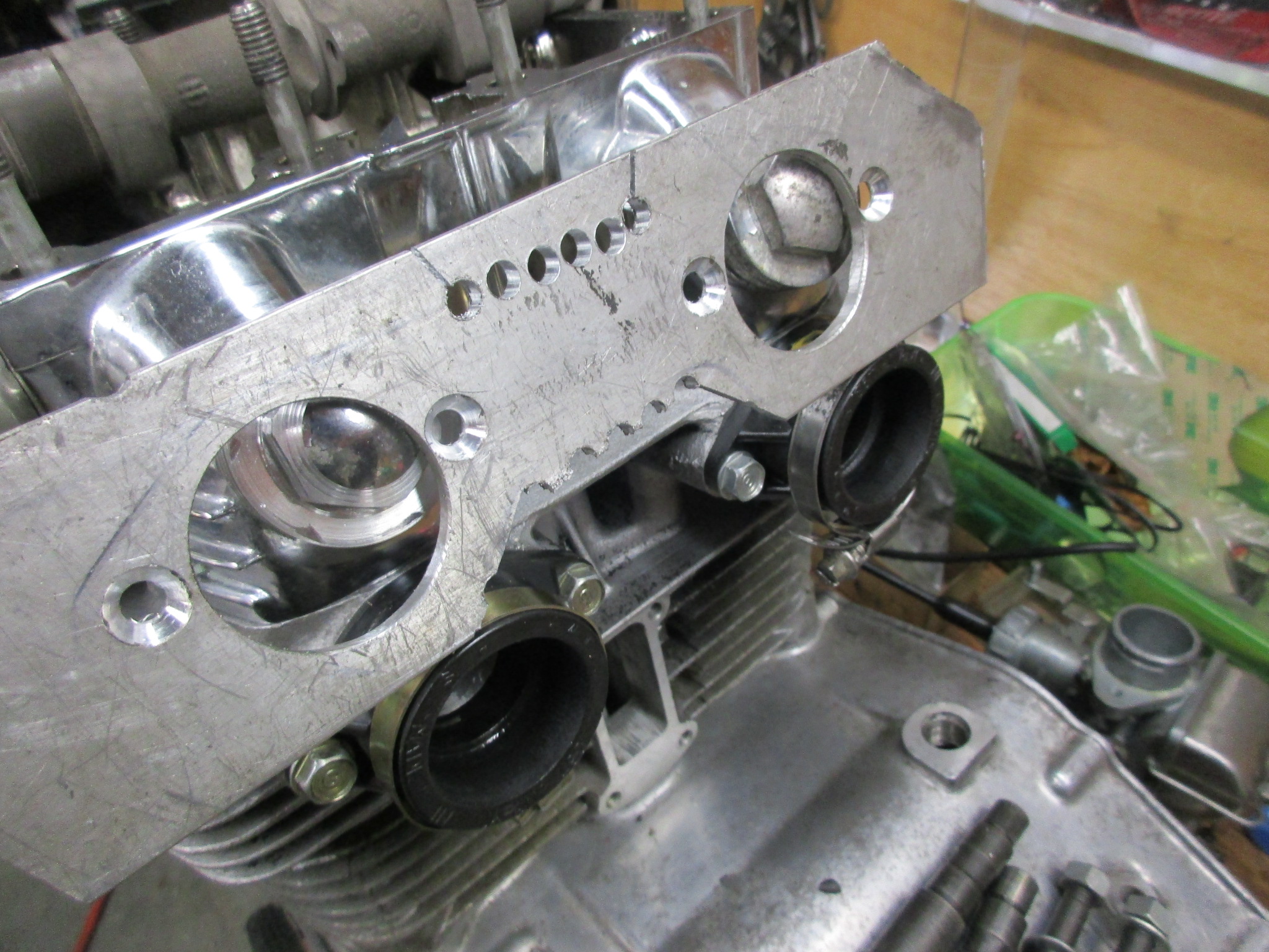

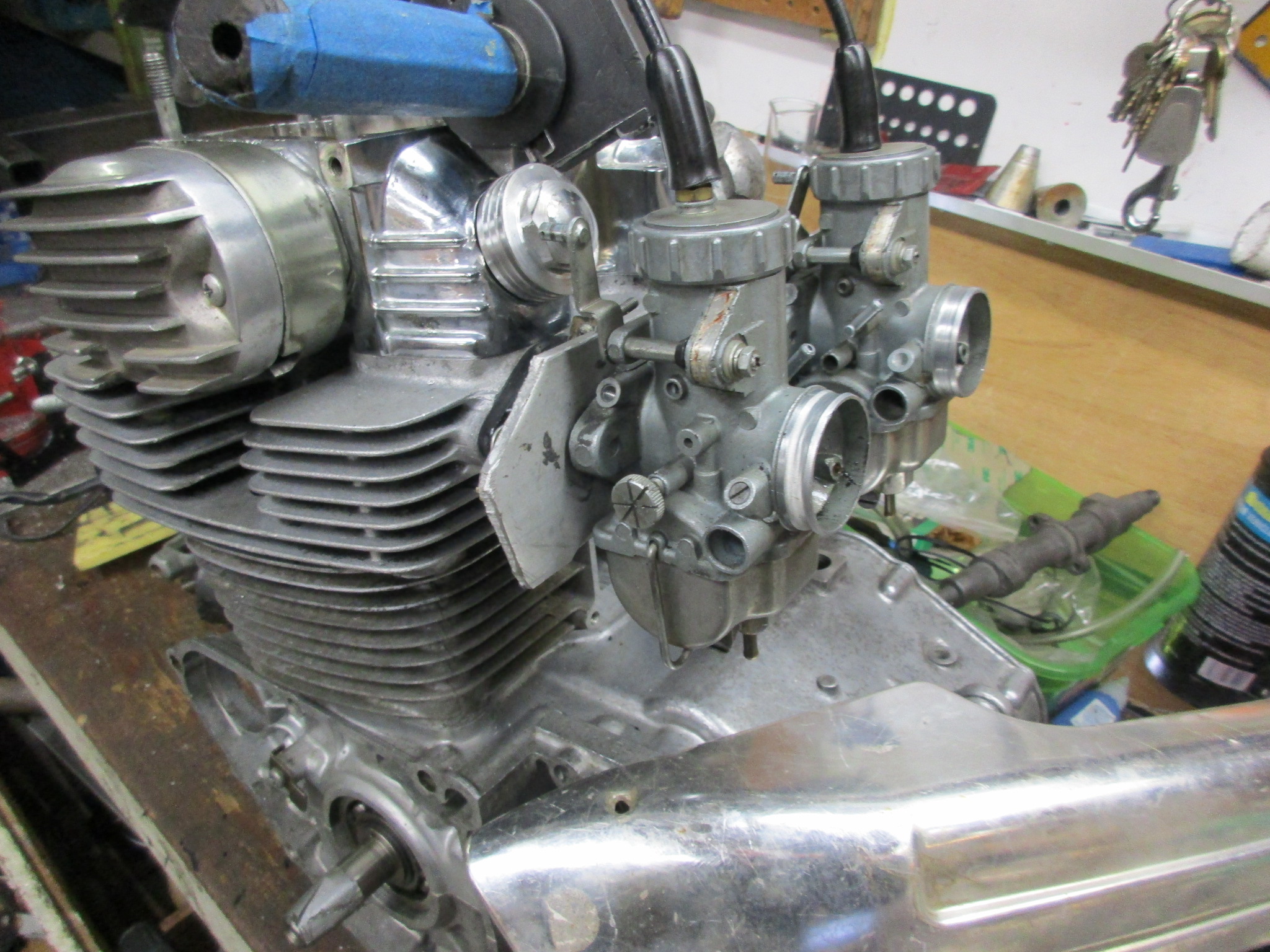

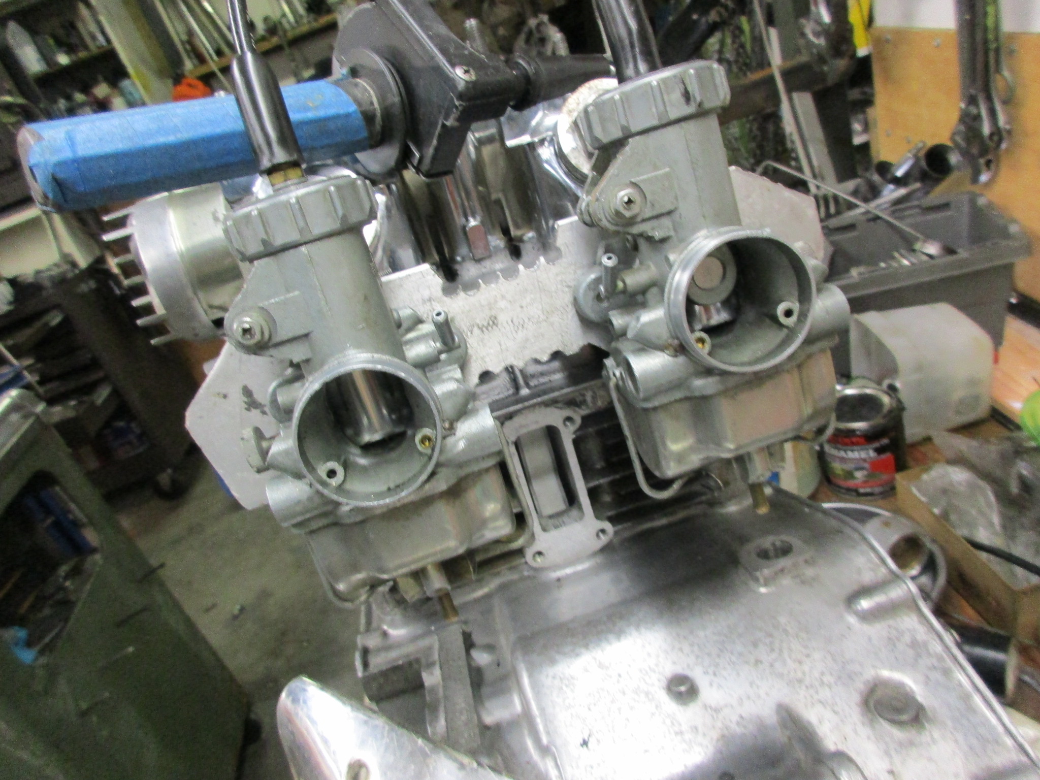

all right then i guess it makes sense to put up a beauty shot i do love speed holes

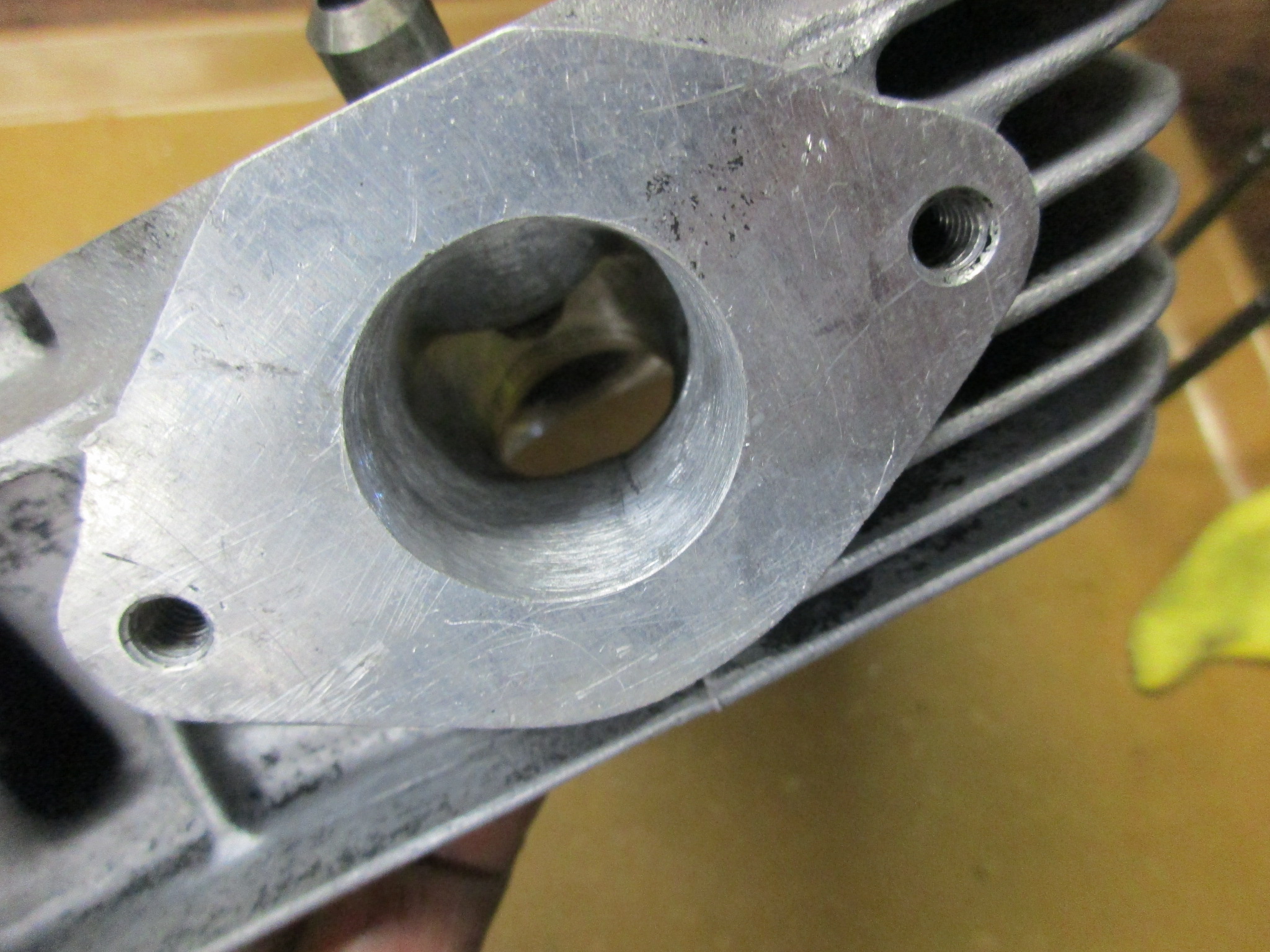

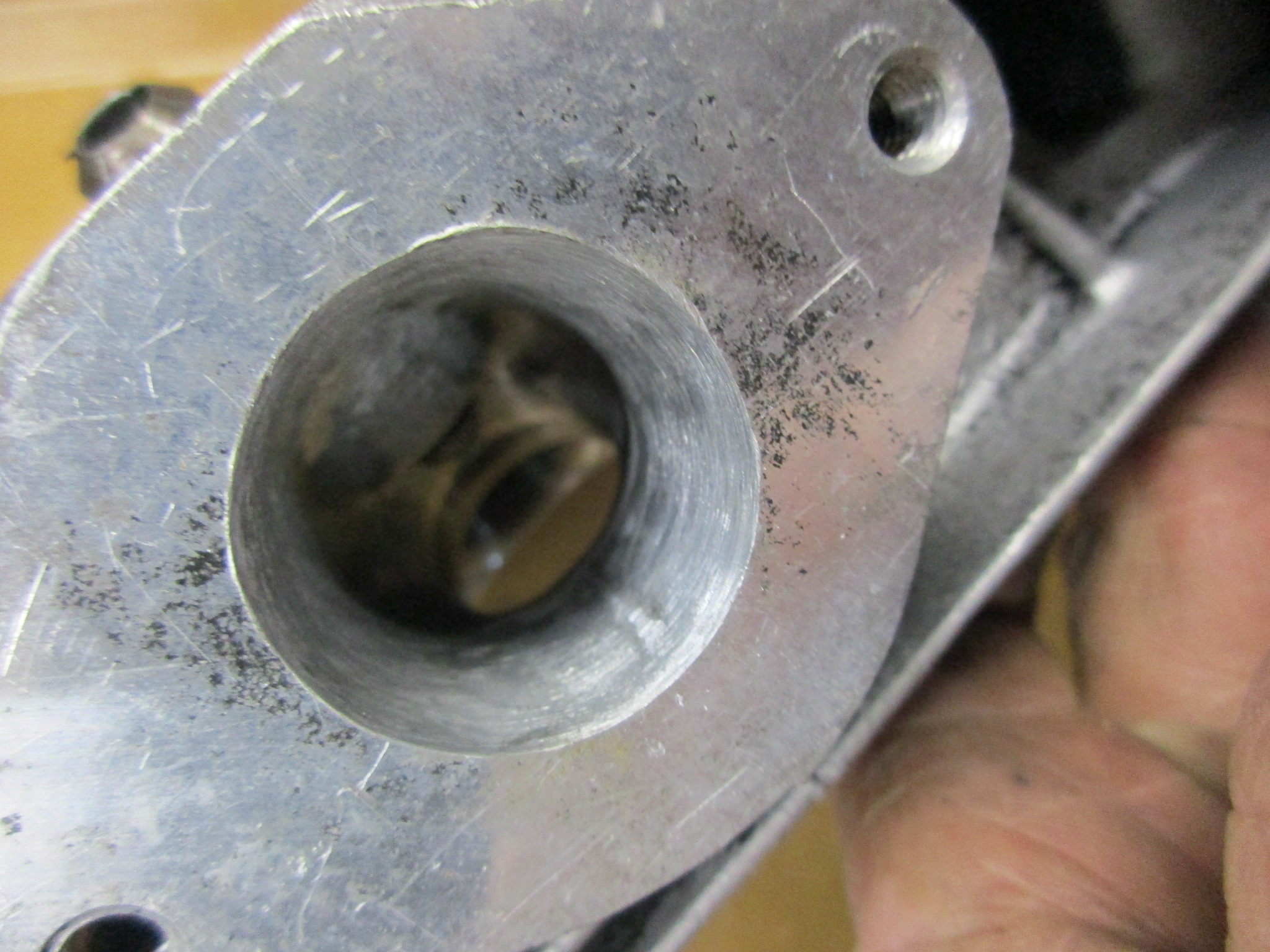

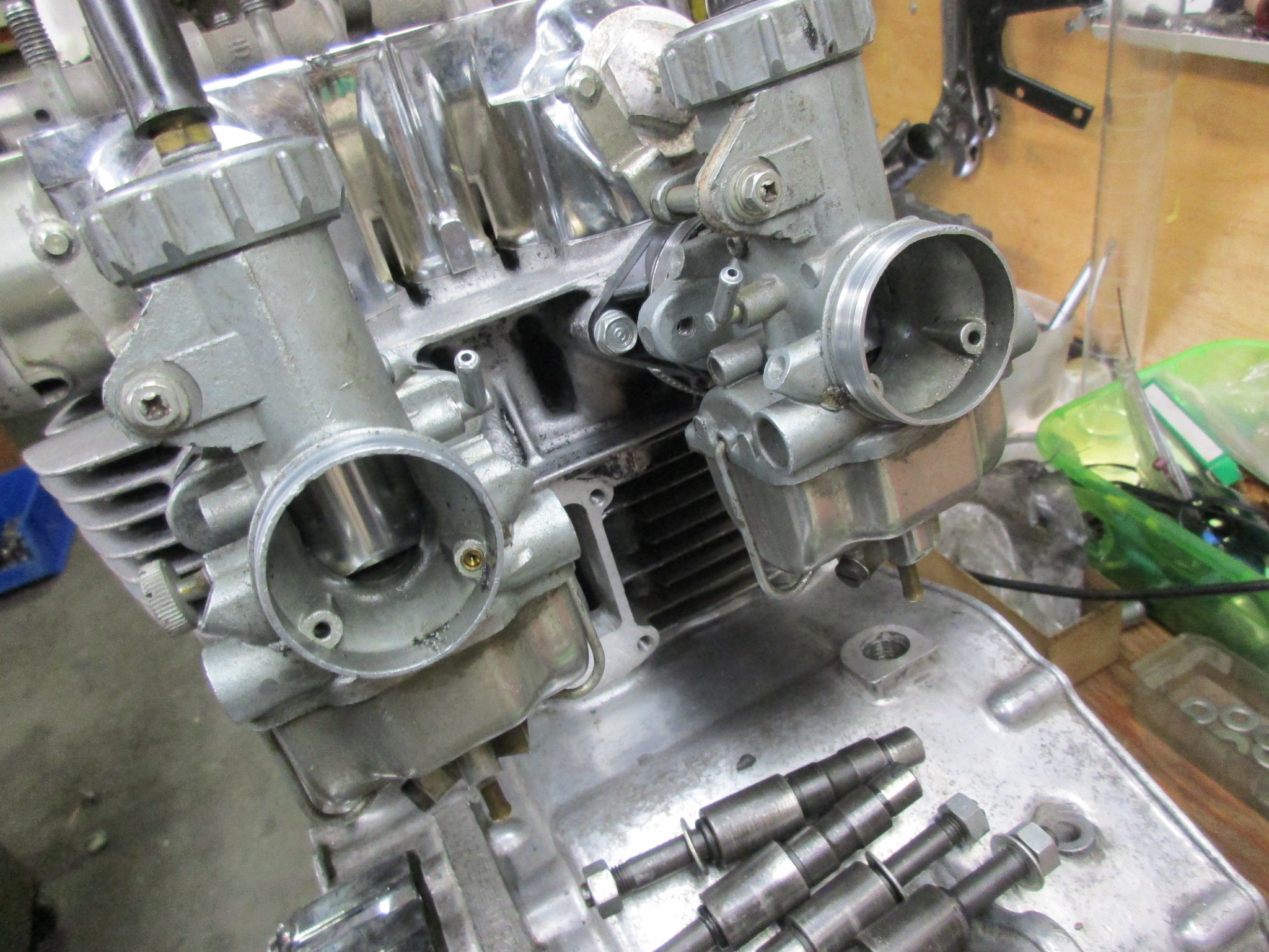

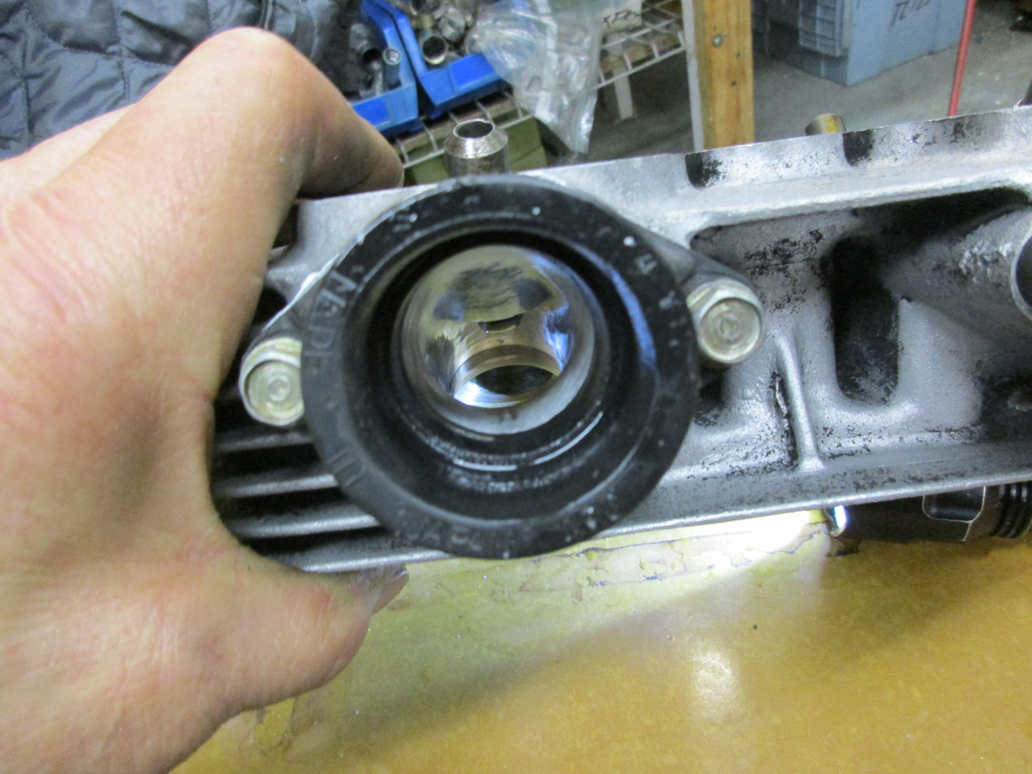

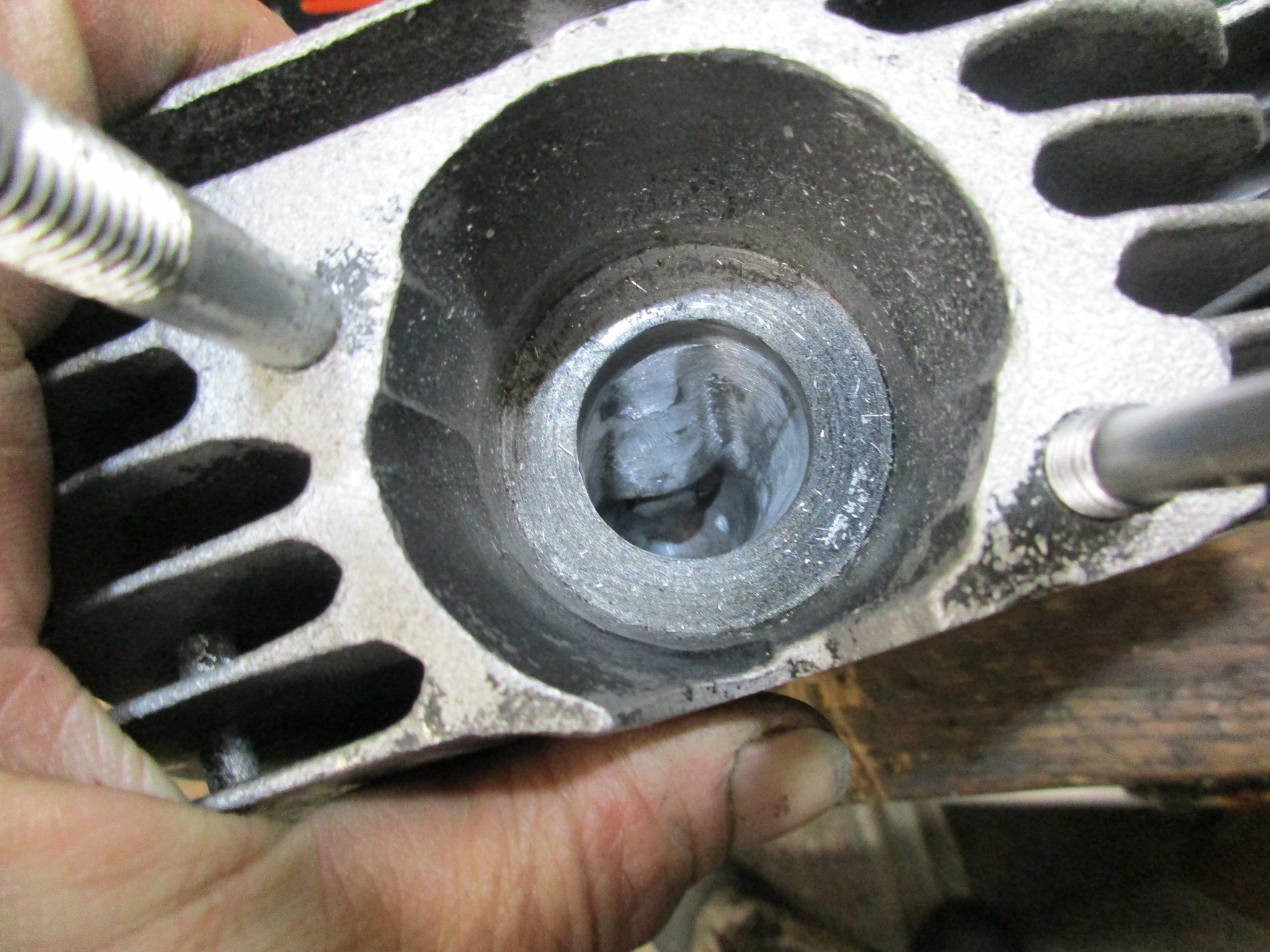

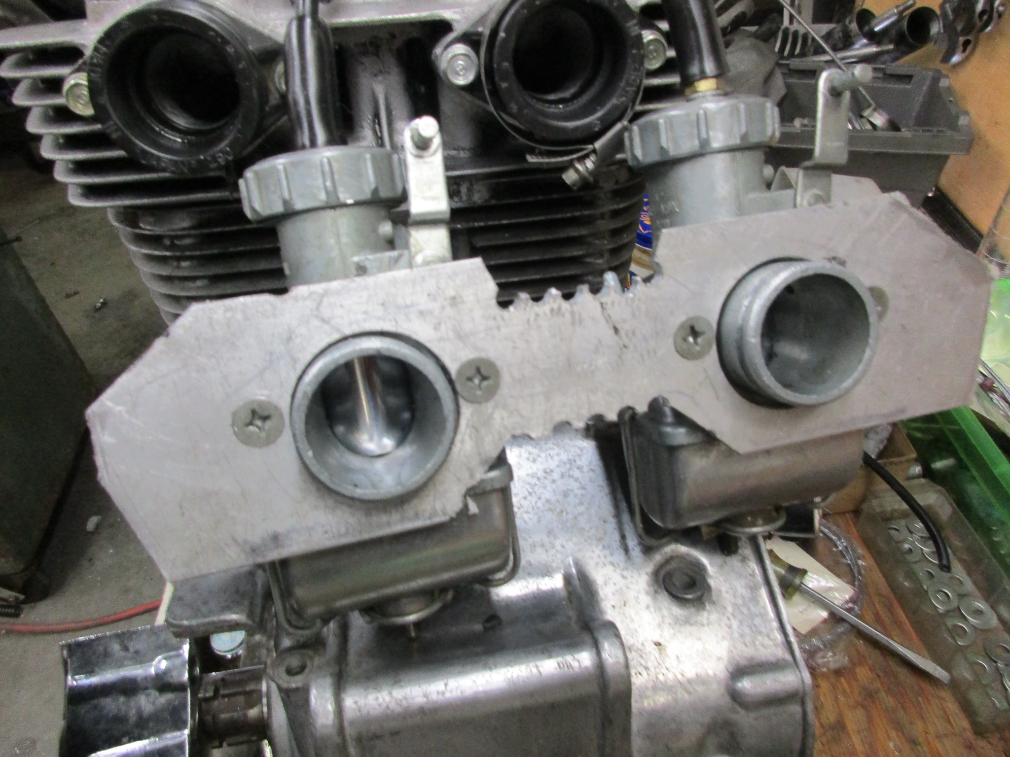

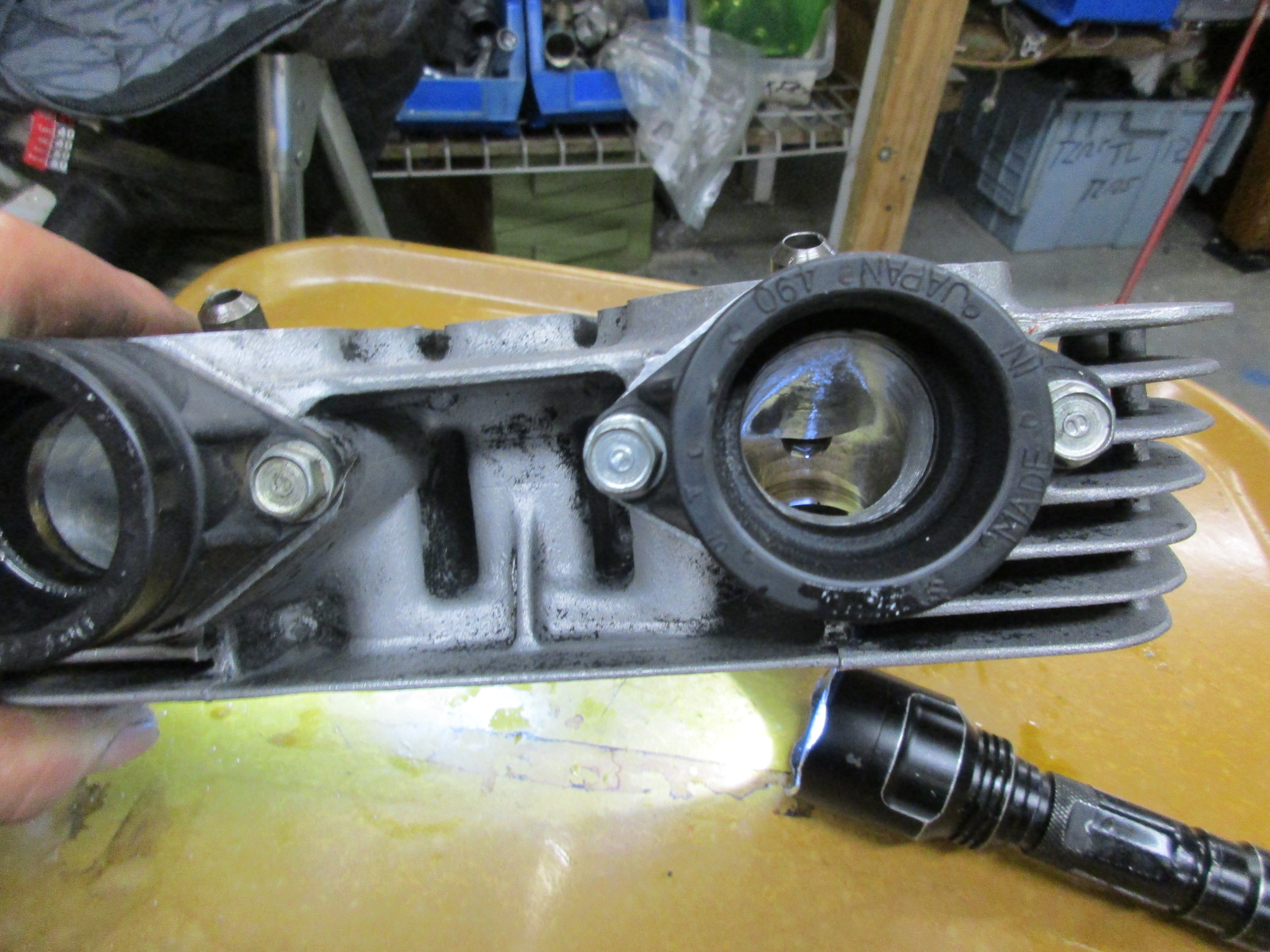

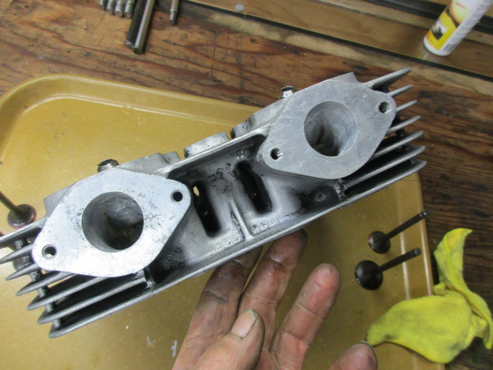

....and shiny keihin carbs which are sourced from cb750ko they measure 29mm inside the outlet

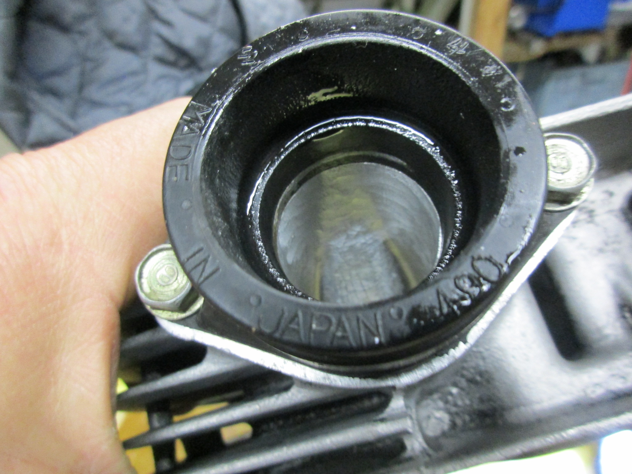

going to machine some al spigot flanges for the head and use cb750 center cylynder rubber boots
i hate cleaning carbs got lucky found these in this condition :)

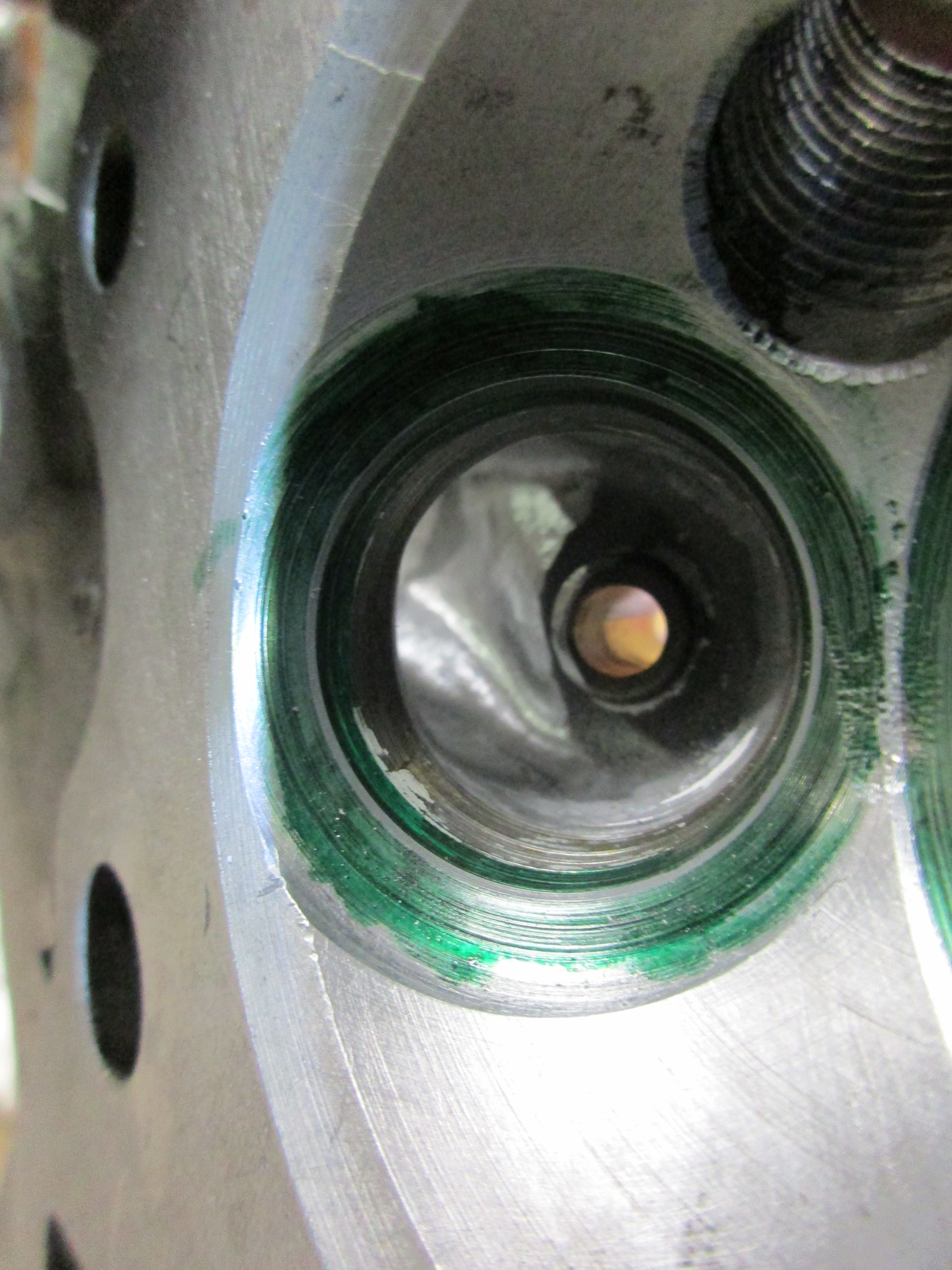

but hear is a little thing i dun with some 350 cam followers not the ones that are pitted just the ones with a faint mark going
i used a cr500 susension link its forked and got it set so up so the rocker pad has perfect convexatational contact as you sweep it across a faceplate with 600 glued i was hoping to easilly disapear the shadow line
there is a flat opposite the rocker face so a fella can measure and the most change i can get is well less than a thou but it works awesome ,just need fine diamond wheel to remove the .001"
then the plan is al ox grit blast and kg gear kote baked on

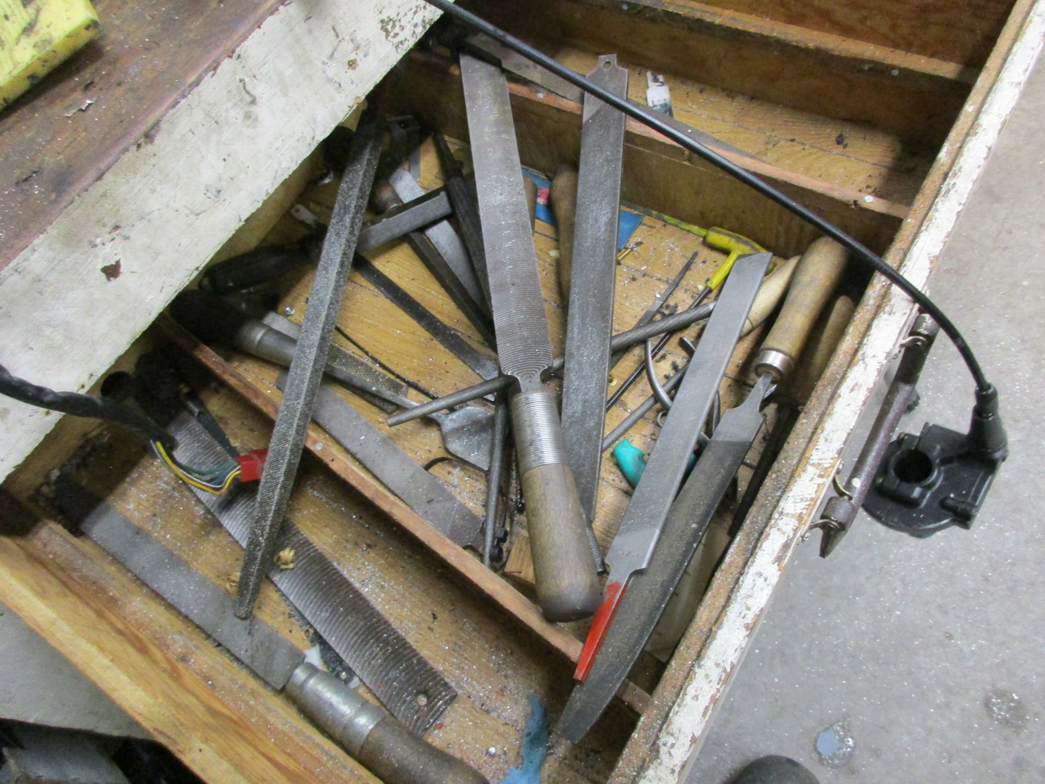

Read up on the 3000 Gear Kote and it sounds like a treatment for the KZ buckets too... The make use program is how I have to do everything, I don't have machine tool one but I have a hand piece and files and grit juice an oven and a torch ::)
