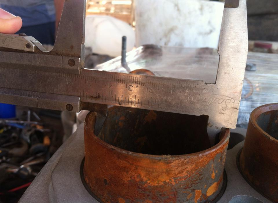

it a 61 mm solid for me, as i stated before de rings, when speaking about the diameter, fitted perfectly when introduced on the bore cam and when tried on the pistons that why i think my pistons are not oversize, the oils scraper ring just wasnt thick enough to fill the space where it goes, the compression rings were perfect.. I just want to know if somebody has had this problem. I would aprecciate if somebody could tell me where to buy the ring due to experiences. Thanks again.
