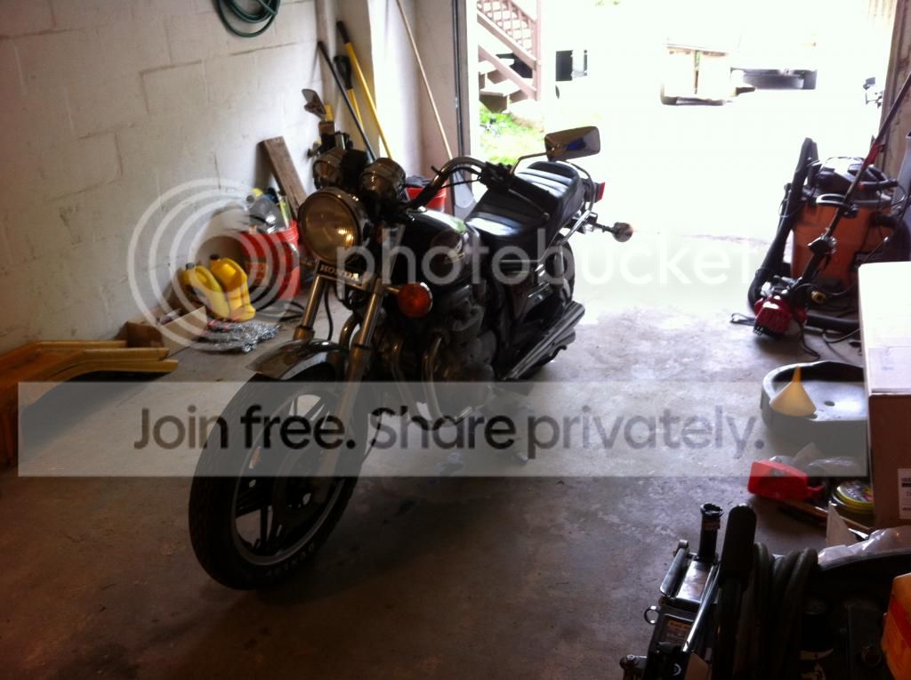

These are pics from when I first picked it up and got home.

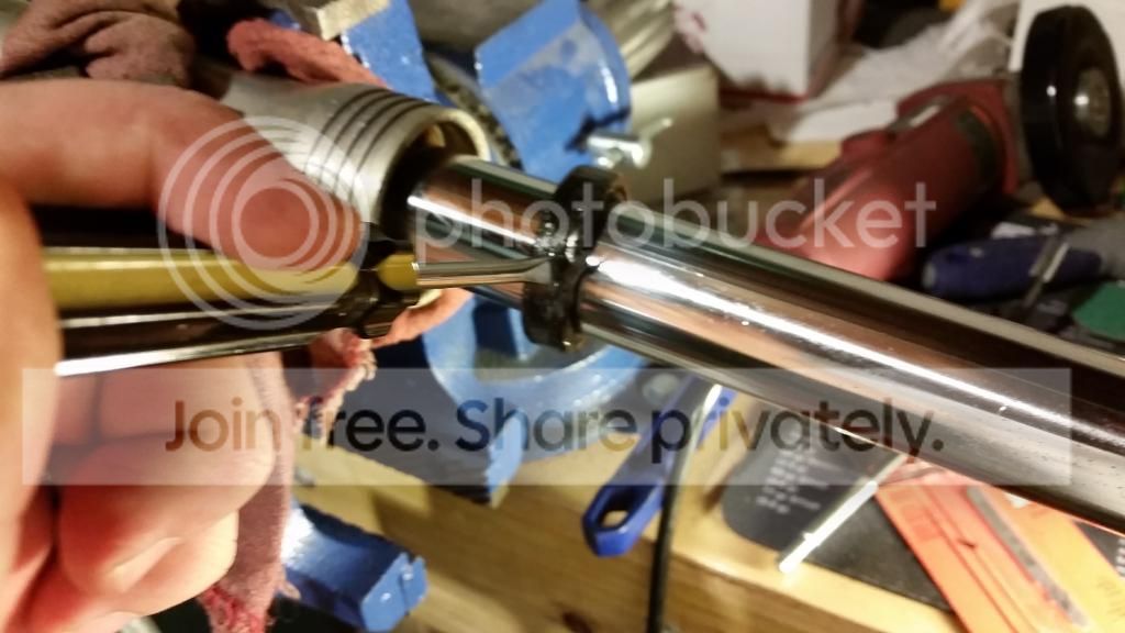

So, knew I had to replace the fork seals. When draining the old oil I noticed how awfully nasty it looked. I then noticed a slight clicky noise when shaking the one fork so I decided to completely break them down, clean, inspect and repair where necessary. Ended up replacing the bushings in the one "noisy" fork and now all is well. Here's the fun.
The trick to these forks is to remove the top caps, drain all of the fluid and remove the springs. Then you fill the tubes completely with ATF to the threads on the top. Mind you, please make sure that you extend the tubes all of the way before filling. If you don't do that, you get nowhere in the next step. Put the top cap on the tube and plug the air tube hole with a bolt. Remove the dust cap, the snap ring under that and the washer under that, exposing the seal.

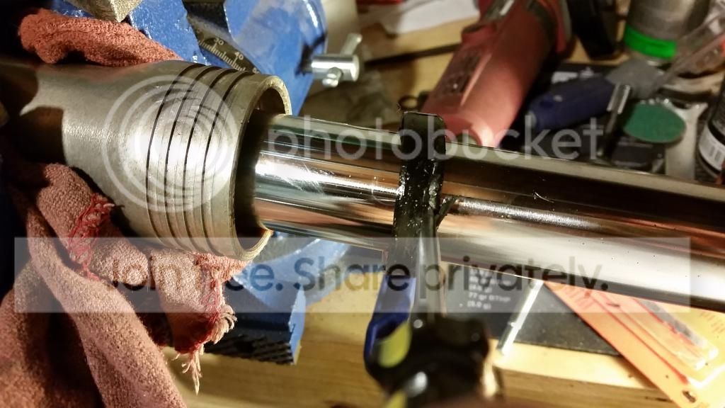

Place the fork into a bar clamp as shown and compress. This will raise the seal right up out of it's seat.
The seal will raise up to the point where all of the fluid will ooze out from around it. This is why I had everything suspended above a bucket.
This is where some fun starts. You can get a thin bladed flat head down next to the seal and start gently prying out in alternating positions. Once you get a full side of the seal exposed, beat the screw driver into the side of the seal like it owes you money. Once you have it in there good you can use this leverage along with another flat blade to work around the edges to walk the seal out.
Once you have that free, remove it and the backup ring below it.

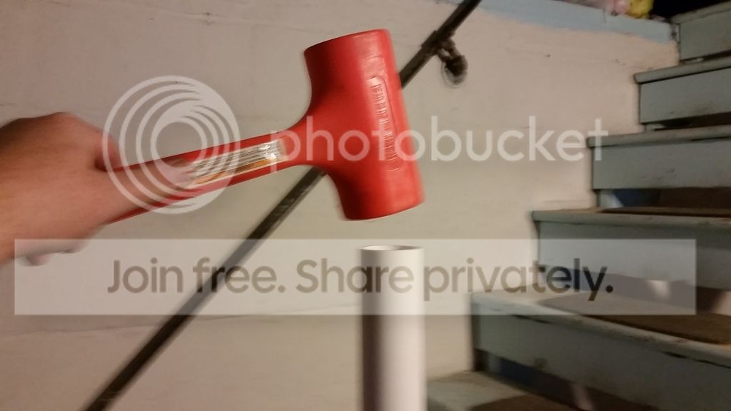

Reinsert the top bushing, back-up ring, seal, washer, snap ring and dust seal. Seat the bushing and the seal individually using a PVC pipe sanded slightly to fit the area and a dead blow hammer.
I just got this same tip today on thumper talk for a Yamaha YZ80. I love internet.
Yeah, I was wondering at first about seating the bushing since the ID of the PVC was to big for it and then it clicked in my brain to use the back up ring on top of the bushing and lightly tap it into position before driving the seal in on top of that.

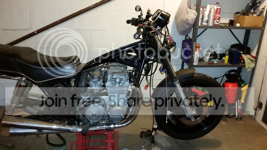

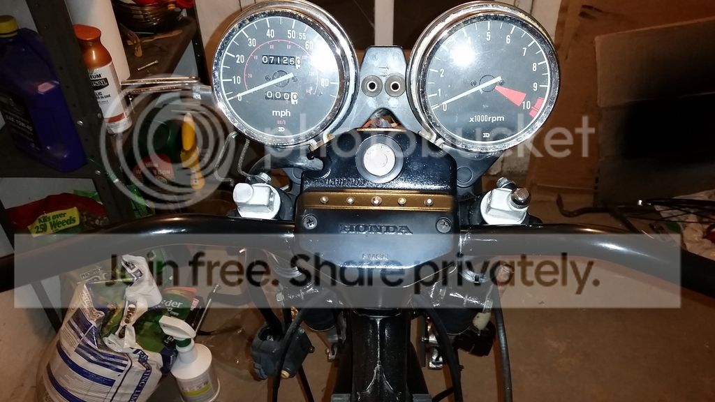

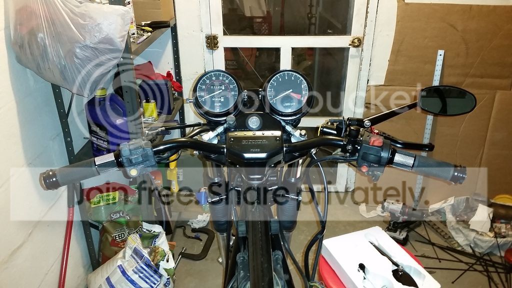

Ditched the giant 80's indicator pod and wired up some LED indicators in the fuse cover. Also changed the fuse panel over from glass to ATC blade fuses.
Got a bunch of things mounted to the handlebars before having the DUH moment that I need to make shorter clutch and throttle cables now, so that's next.

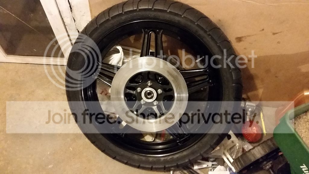

Rear wheel mounted back up and new Hagon shocks.
New Mac 4 into 1 exhaust mocked up.

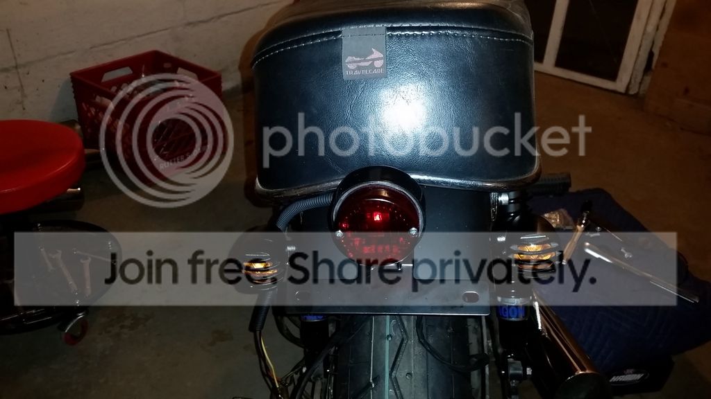

Cut fender and new rear lighting array installed.
