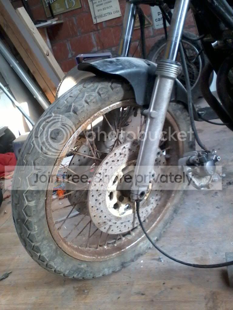

i have a 750 F2 originally with the comstars but now I've sourced some spoke wheels.

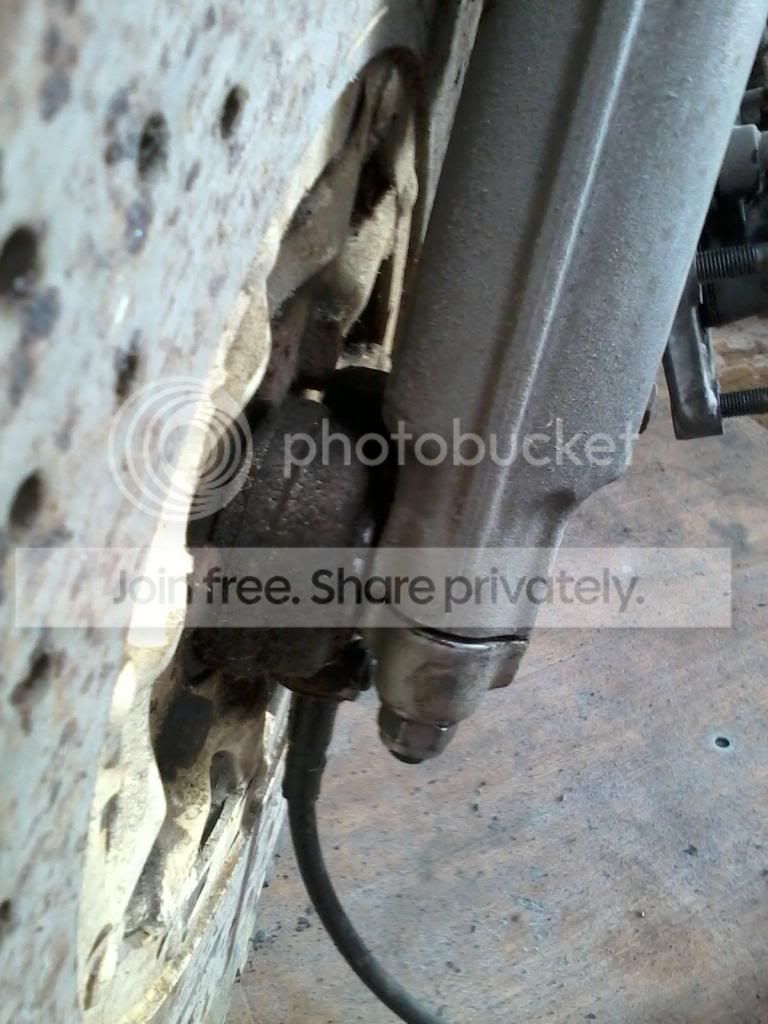

it does fit but the rotors are bigger in diameter and thickness. so calipers don't fit...
Also the speedo pickup is larger so it doesn't clear the forks completely...

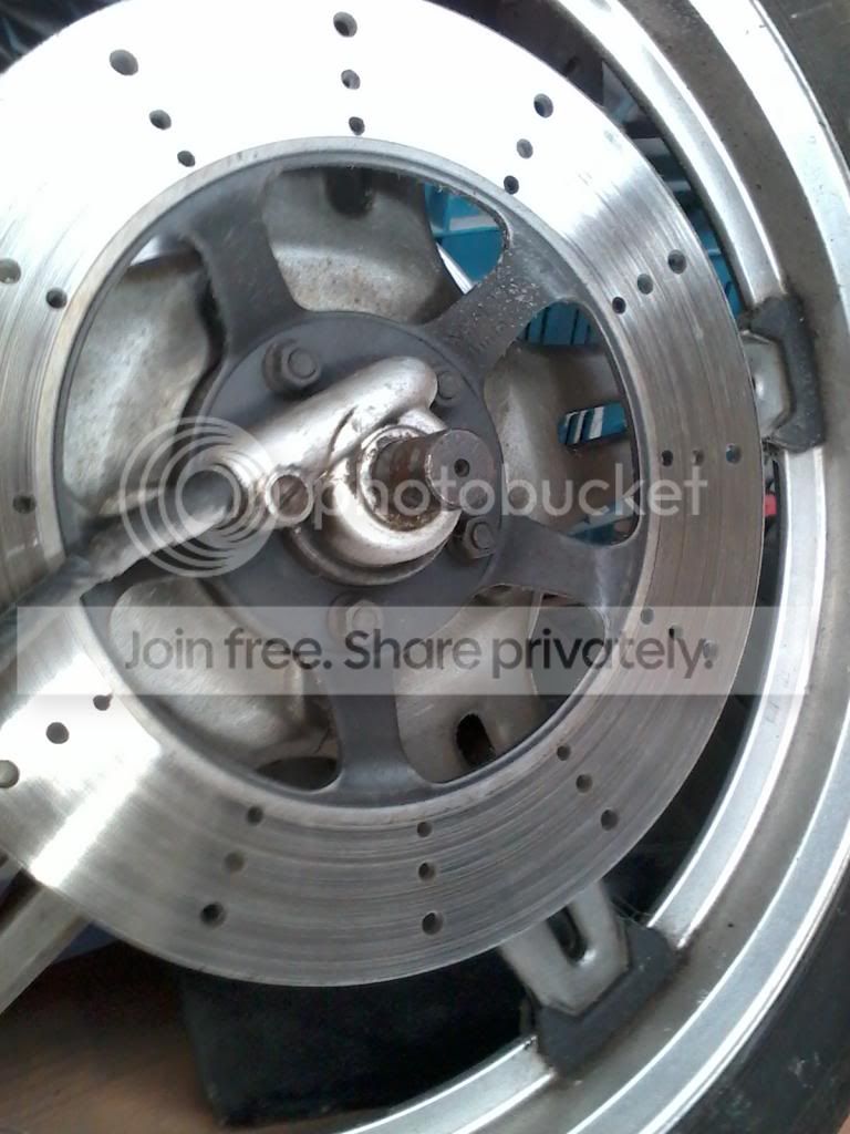

And the rotor on the spoke wheel is 6 bolt, the comstar is a five bolt...
Is there any way of adapting the wheels so I can fit the original rotors?
or should i machine the bigger rotors to the size of the comstar rotors?

You can run adaptor plates for the calipers to space them out to suit the bigger rotors. That's probably the easiest if everything else lines up.
Otherwise you could get some plates made up to convert your Comstar hubs to accept spokes. There was a guy on here that did that on a CX500. Basically it's 2 metal rings that bolt to the hub and you lace the spokes to them.
Either way, you will be starting with just a hub because those spokes and rim are fucked.

Actually haven't thought about making a bracket to allign the brakes, not a bad idea!

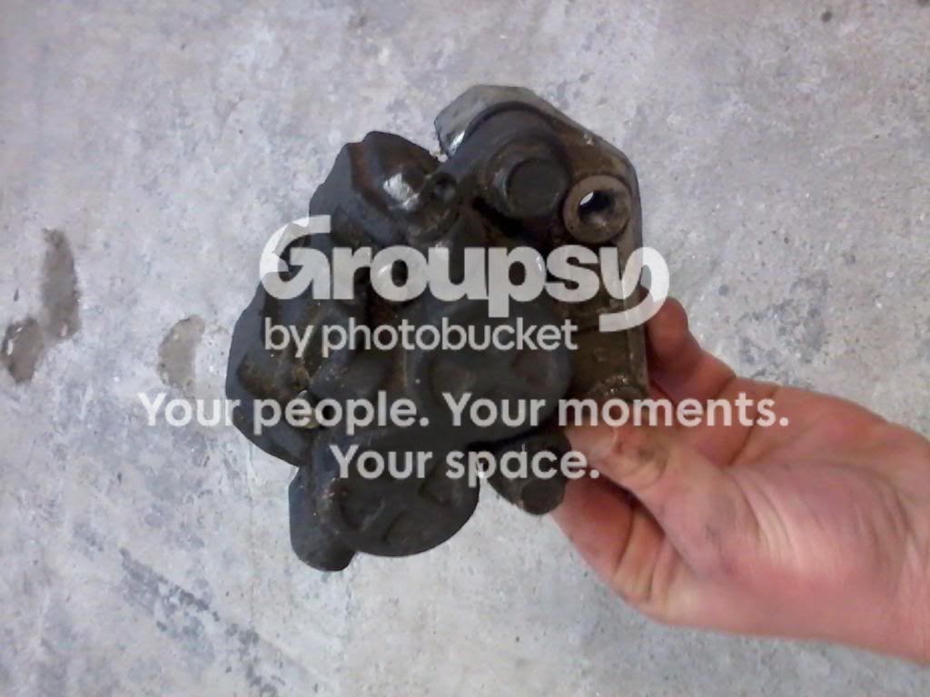

I also bought a box full of calipers, I think these are off a 80's model CB 750? I allready have a complete rear brake setup with dual piston by the way.

Really any mixing of comstar ans spoked parts in an extra pain in the sohc world.
Better get is to swap the whole front end. That will get you spokes on the front.
Smart move is to swap to a GL front end. This gives you better forks and an alloy wheel.
Then find a 75-76 cb750 F wheel. Spokes and disc. With the right mix of standard spacers and hubs it should bolt together.

just bought a F1 fork and rear since I allready had the wheels...
cut the old spokes, got the rims powdered, painted the hubs, installed new bearings and new spokes. With a set of new tires.
Also added a second caliper and rotor with adapted speedo pickup
