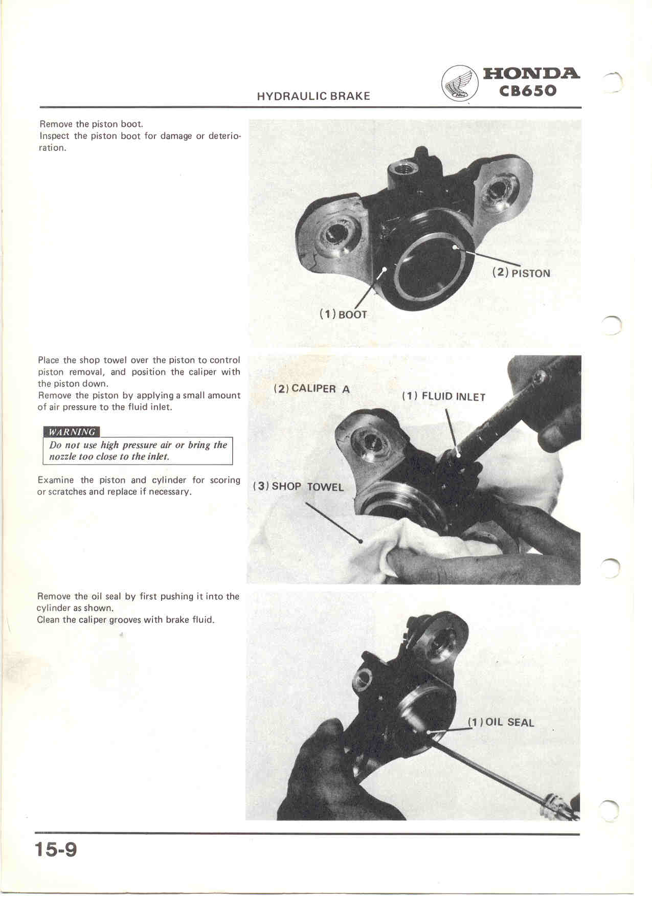

I just took the caliper off but I believe the piston is completely locked up. I have blown air in it, tried pushing it back in a little with a c clamp and it wont move at all. Any ideas how to get it out?
Is this your brake caliper?
You said you blew air in it, did you blow air into the fluid bleed screw after loosening it? Was there any fluid in the caliper cylinder?
It sounds as if the oil seal on the caliper has fuzed to the pad and caliper. Id try soaking in break free like marvels . Your going to have to rebuild it anyway.
The way to get that puppy out is to keep it hooked to the brake line and "pump" it out with the master cyl. Then you can clean it up and reassemble with some brake grease. Gene

Ok guys I appreciate all the advise. I have probably messed things up and I am hoping my Master Cylinder is still ok. I was unscrewed the hose from the master cylinder thinking that it would release my brake ( before I knew the piston was stuck). When that didnt work I took the caliper off and that is when I determined my piston was stuck. So I have not put the hose back on the master and I have hooked the hose back on to the caliper but I am not getting any fluid down. I have followed the instructions in the manuel for bleeding and nothing. When I first tried to move the bike and the front wheel was not moving I had pressure in the master cylinder.
I am stumped.
You can use a C-clamp to squish the piston back down into the caliper, just to break it free from being seized in the bore. Then use the master cylinder to pump it back out.
