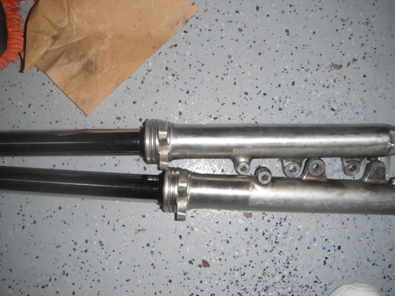

Onto the next phase, which is dissassembling the forks, something I have never done before.  There's the 17mm hex cap bolt that, once undone, all hell breaks loose;
And the impact bit and torque wrench that loosened it:
Shown is the lower for brace.  What is a good way of cleaning this up, i.e. getting rid of that yellowish patina.  Is that the aluminium's original clear coat, or what?  I'll take suggestions.

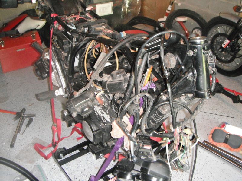

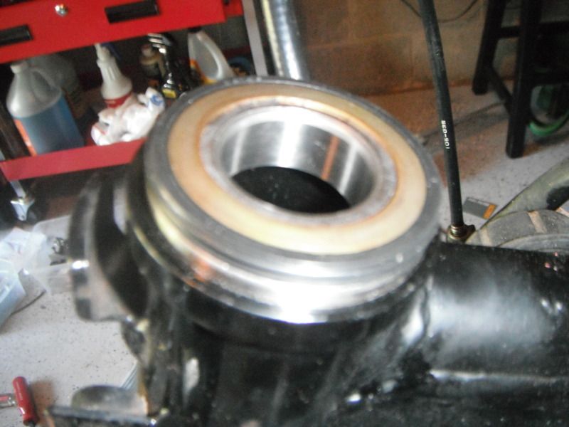

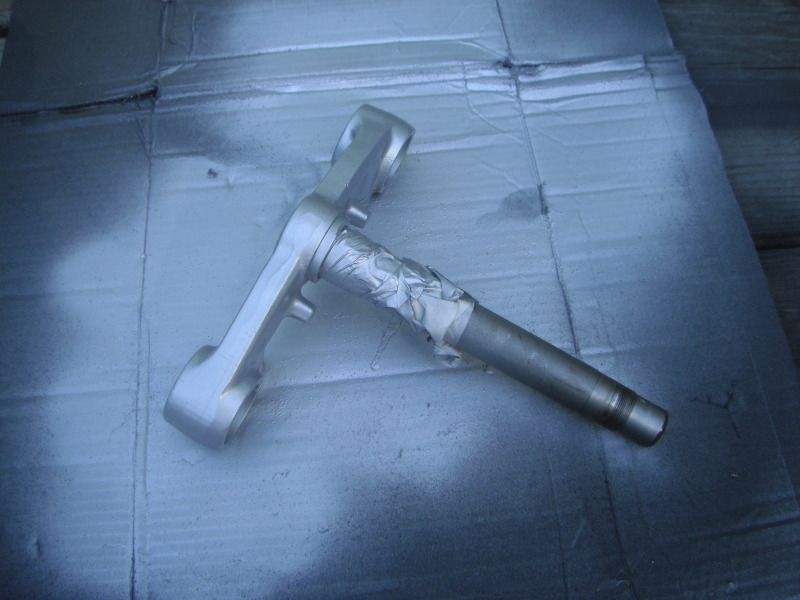

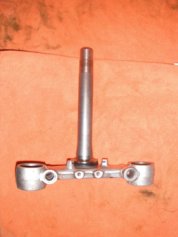

First up, or, er, off: the steering stem/triple tree: I had to elist some help to get the lower bearing race off.
And how it looks this morning in my outdoor rattle can paint booth:
When the paint is dry, I'll be able to continue to put the FRONT back together:
Forks have new seals...finally
And an All-balls kit is ready to go in as well:

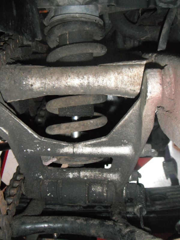

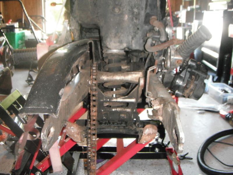

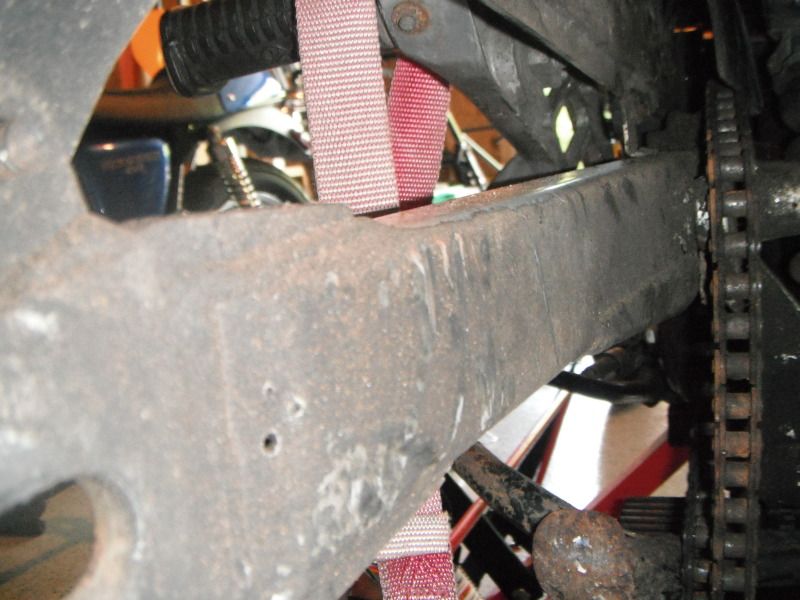

While the forks were out, and, well, I needed to take out some frustration, I started taking apart the rear wheel.  Needless to say, it's a mess back here:
Really:
That's about 20 years of grime on there.  Can you say PRESSURE WASHER??

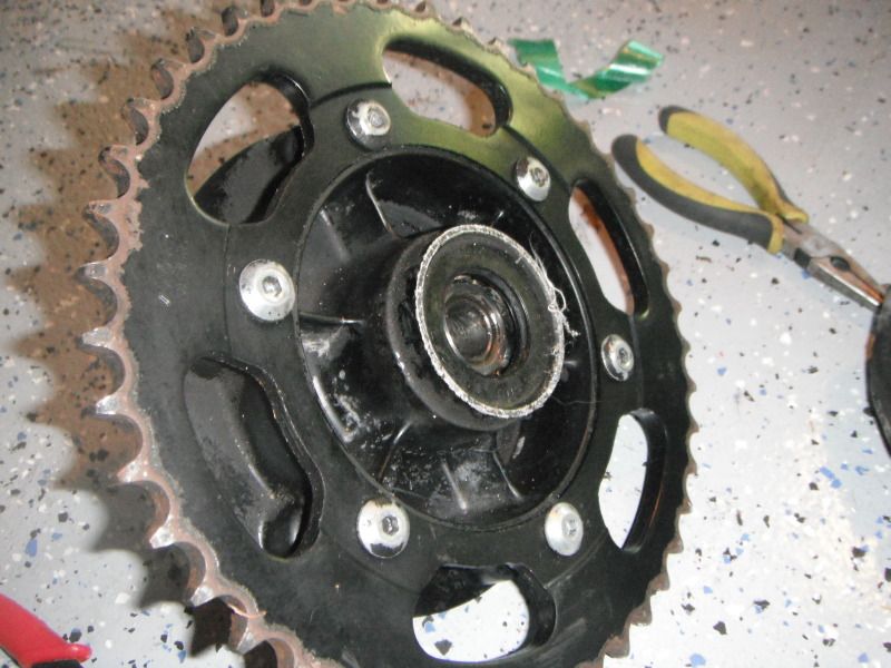

PROGRESS: Cleaned up the rear socket and boot assembly:
And earlier last week, the fairing-stay gor a new coat of Krylon:

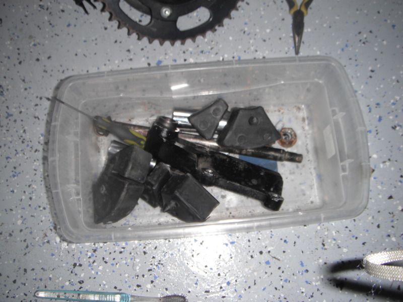

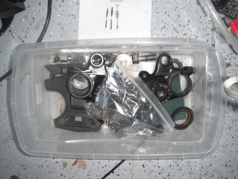

And I'm keeping everything else organized...to an extent with these bins I got at Home Depot for $1 each:

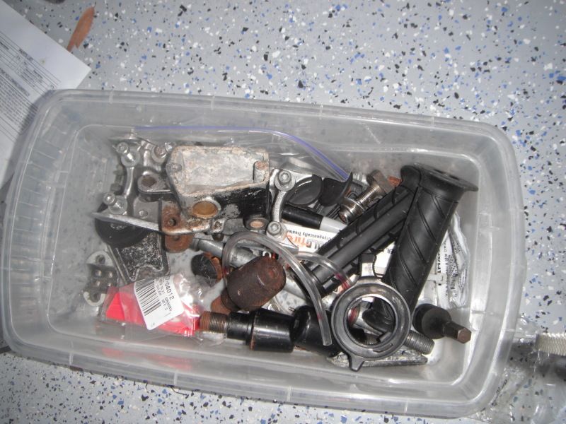

Handlebar assembly bin:
Triple tree and forks bin:
Rear Wheel bin:

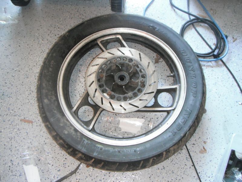

And the rear wheel itself (not cleaned or devoid of its crustry old Dunlop yet)

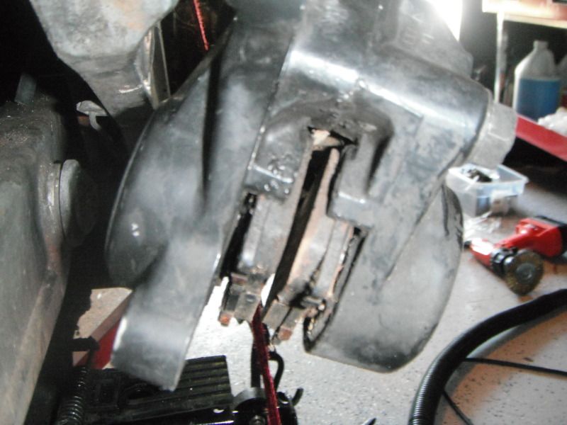

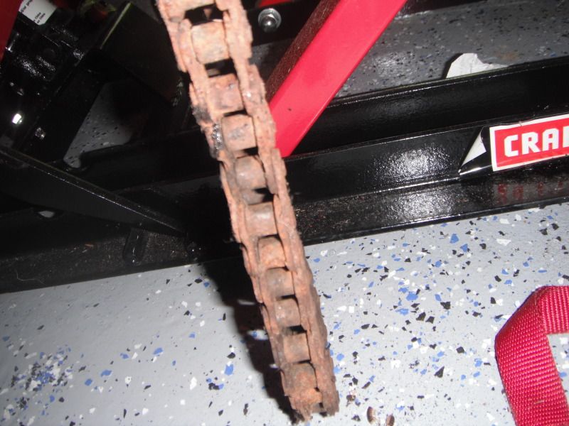

And no project thread is completer without a shot of a rusty old chain...which, with exception of MAYBE a few bushings, fittings, and other odd lots is the only thing MAJOR that I need to replace anytime soon:
OK, maybe brake pads and replacment lines...but no, really, that's all I need, I swear:

Nice work, I am about to attempt my first tire change, fork oil change etc. on my 79 GL1000.  Let us know how it goes for you on those tires.  Amazing what a little wet sand and mothers can do for crusty aluminum.  Give it at least a few coats of car wax or if you can find it a product called sharkskin can protect it really well.  I am still trying to obtain an bottle of that for my polished bits.  I spent hours on it and with the weather around me it will look terrible in a couple days if I don't do something to protect it.

The secret to tires is making sure the opposite side of the bead stays down in the well of the wheel when you spoon it off/on the rim.
That and a dash of soapy water.
An extra pair of hands helps a LOT if you can get them.

I also read to be careful with what brand/kind of soap as some is caustic/acidic and can eat holes in alloy wheels.  Cause slow leaks and inproper beat seating. I bought tire intallation lube designed to be safe on all types of metal wheels. it was 6 bucks for a lifetime supply.
