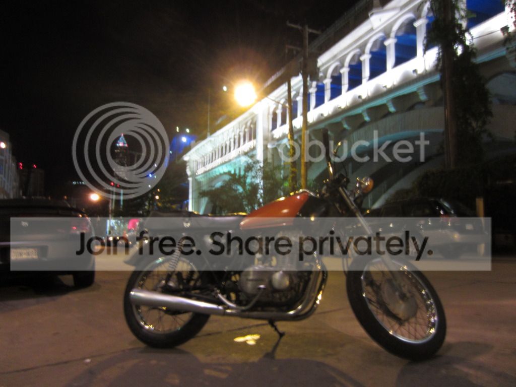

well i just finished:
clubmans
grips
weighted bar ends
exhaust wrap
engine covers
signals
rear fender chop
taillight
lowered the front end a little
replaced flasher relay with EL12 to flash quicker.
when i first got her:
now:
next up will be bigger tires, do something about the awful seat, fork gaiters and new seals/fluid, sprockets/chain
i'm also thinking of plasti-dipping the tank gloss black and scotch-brite'ing the fuel cap. what do you think?
I used the silicone sealant on the exhaust wrap and took out the cam chain tensioner to clean it out, well i snapped the adjusting bolt off and had to drill it out :'(. I ate through some of the housing too but managed to get it back on the bike somewhat functional i think, maybe it's just paranoia but the cam chain sounds louder now; so i ordered a new housing for 20 bucks off the bay.
Went for a short ride to cure the sealant and snapped some more pics of beautiful Cleveland:

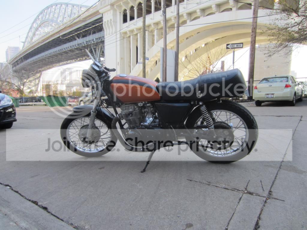

I had some extra time and i'm a little in-between ordering more stuff (tires, sprockets) so i decided to have a go at shaving the seat down, I think it turned out ok.
Before and after:
after about 1.5hrs of messing around with a steak knife...
