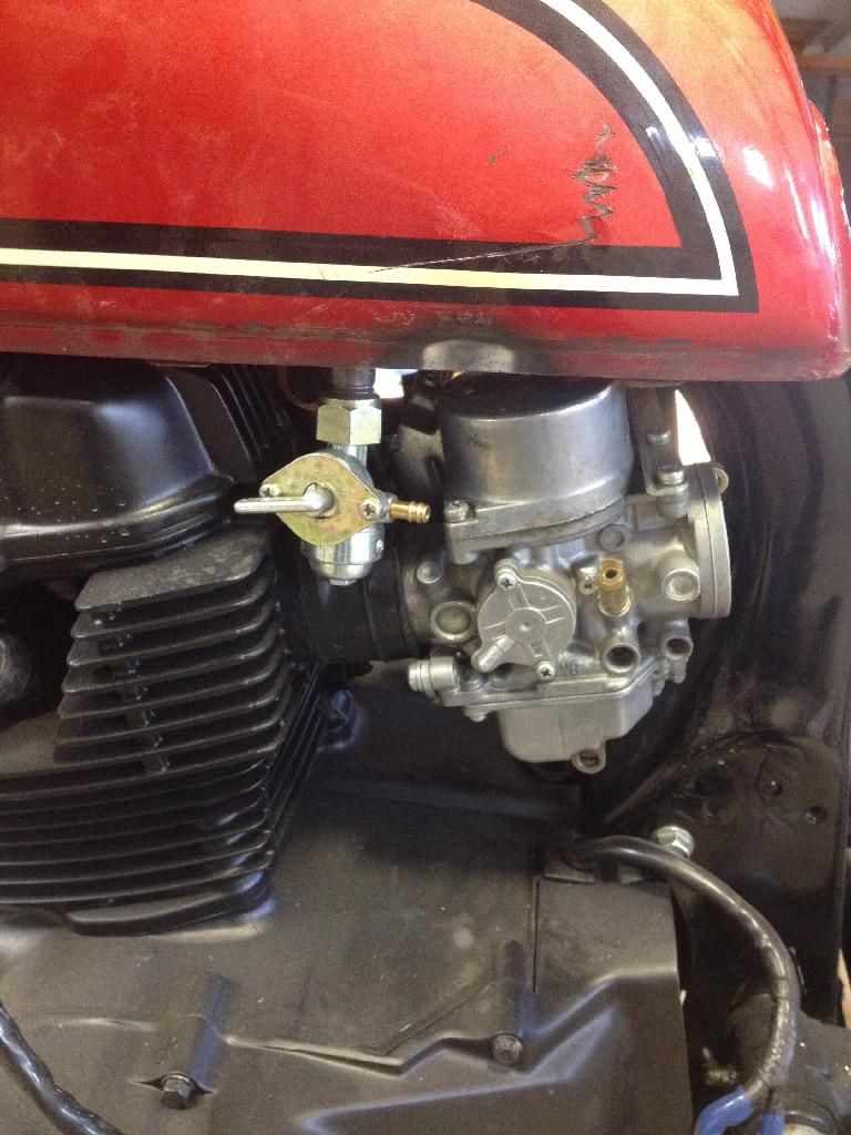

Ran into a bit of a snag on the weekend... I came to the shop planning to have all the hard parts done. Reamed the swing arm out for the larger 20mm CB450 rear axle, then bolted the carbs on and set the tank back down annnnnnd this happened... having the bung moved forward 2", that way it drops down right next to the carb boots with plenty of room for the petcock.
Ah that last post brings back memories haha. Let me know if you have any clearance issues with the coil under the tank, I think I have some spare brackets I made up to remount the coil and still keep it tucked.
That color combo is looking great.
it seems to just fit, with a bit of 'love' hahaha... I still plan on doing the GM coil mod, not sure if that will be better or worse clearance wise. I may PM you for some pics, and measurements though :)

had the pet cock tube on the tank moved, fits great now! I still dont have mount setup for the rear of the tank, have to figure that out and ill be lifting the rear just a touch to get some clearance underneath.

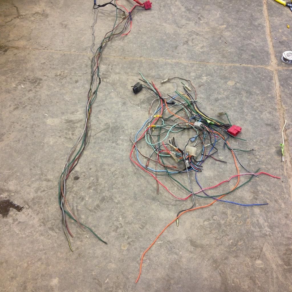

Then i hacked at the harness for a bit, aside from the mess of black ill trim back as i hook everything up, I'm down to seven wires going to the front of the bike :) everything on the right is junk

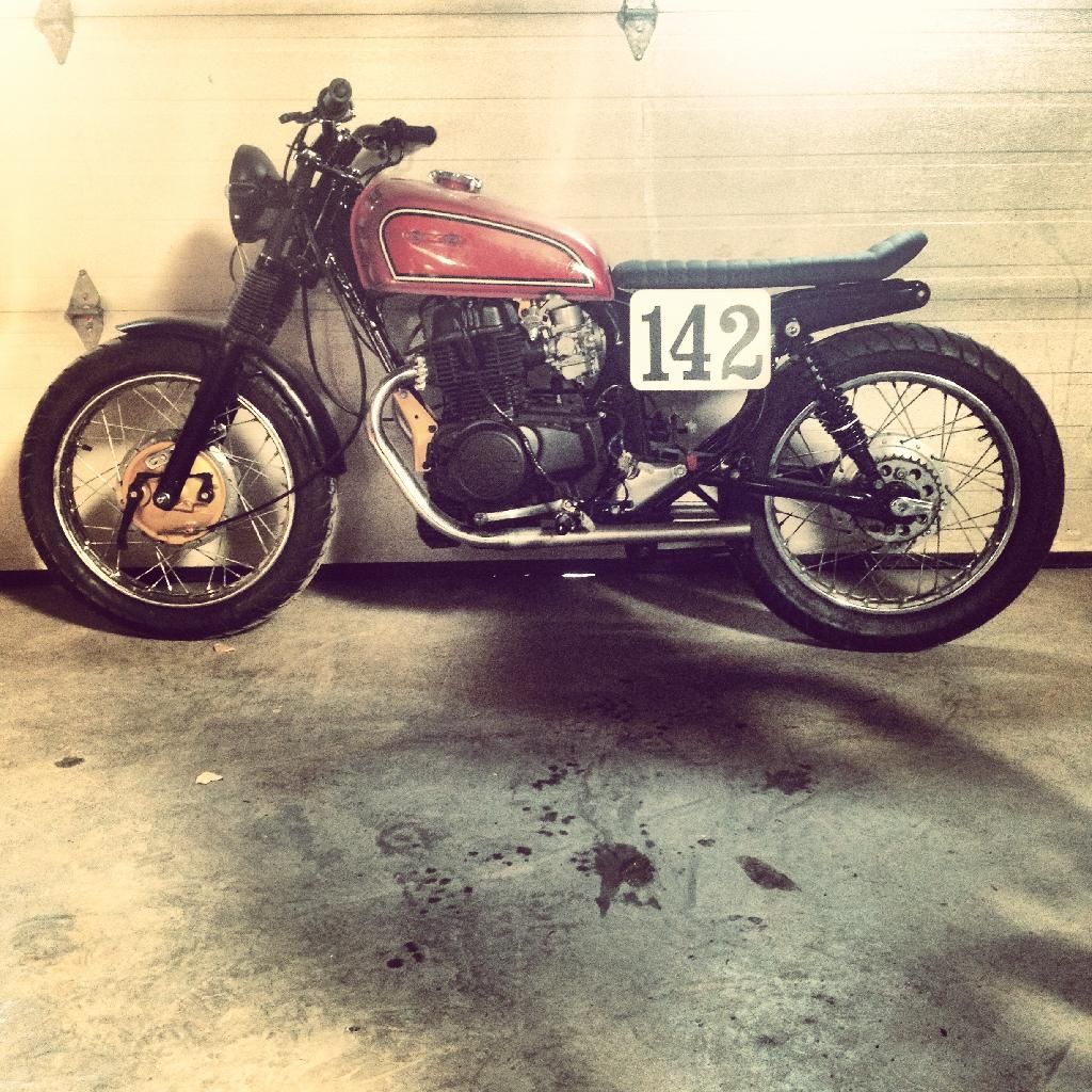

annnnnd then i took a picture, I just stuck the plate there with some tape. I hate this damn subframe, I should have just cut it off from the start... oh well.

If you don't like I would cut it now. It wont set you back that far.
Well I had to order a new throttle tube which puts me off by 3 weeks, so im really thinking of just chopping it off. the problem is to get it to the guy that would be welding the new section on I would have to tear the bike down again and take him just the frame.
