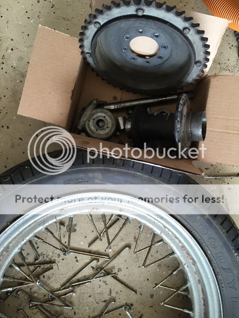

Update: I got the rear wheel completely broken down and ready to rebuild... It's gonna get a new rim, stainless spokes, powder coated hub and drum, new sprocket and I'll replate all the hardware... Should be good as a new one. Now gotta break down the front wheel... Gonna need to score a proper socket or wrench to get that apart... My sockets aren't deep enough.

He'll be pleased that it's not gonna have an angle grinder taken to it and turned into an eye sore.
Looks like a great project man.
Though I did have to chuckle about the "it will not have an angle grinder taken to it..." with a picture in the same post of the spokes cut presumably by an angle grinder haha I know it's just cuz your replacing them though =) good luck man
Edit: nevermind, upon closer inspection it looks like bolt cutters were the culprit, not an angle grinder. I shall now wallow in my shame =p

I had to make a little spanner tool to get the bearing retainer out... That worked well.. The bearings are pressed in quite well though and I am not having good luck getting them out.

One of the trickiest jobs in overhauling Triumph wheels is removong the hub guts and keeping everything in proper order.

Omg... I fought and fought to remove the bearings in this hub... I finally had to weld a washer to the inner race to give me something to whack from the back side.
I was then able to blast and powder-coat the hub.
