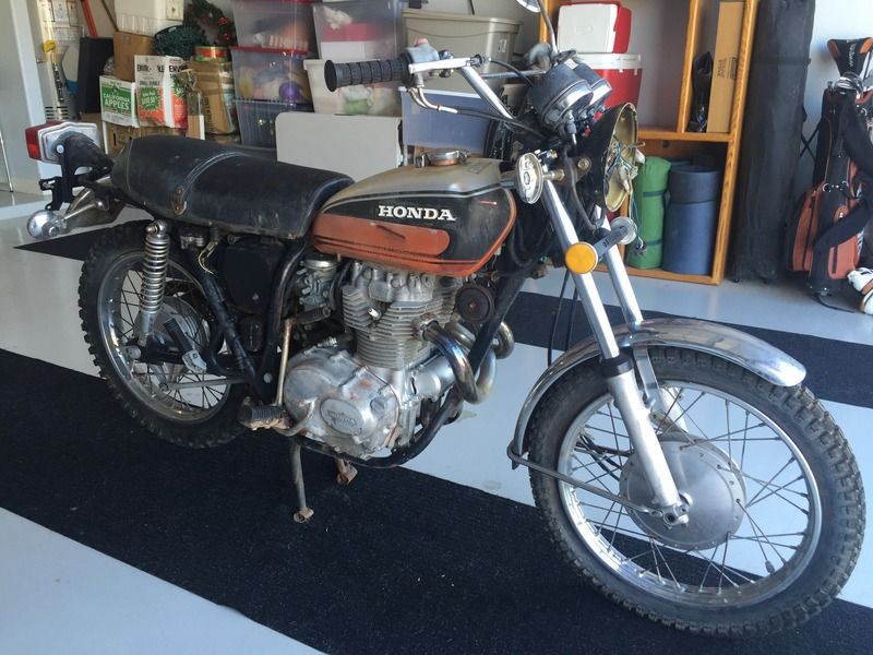

Newb here. I have been looking around for a bike that I could build into a neighborhood cruiser but still go race the hooligan class with the local flat track club. I was looking at XLs and XRs but I wanted to start with something really cheap which is how I arrived at the CL. $600 on Craigslist. Motorsports are in my blood and I've been riding motocross and working on my moto bikes for a long time but this is my first "project" of any sort... To make it a little more fun I suckered a friend into a build-off. It will be his first project as well and he picked up a Yamaha DT250 for $50!

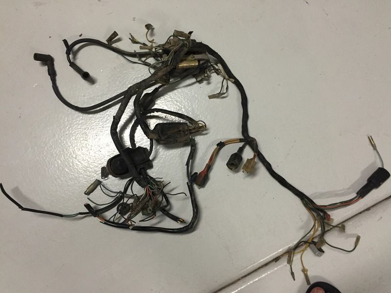

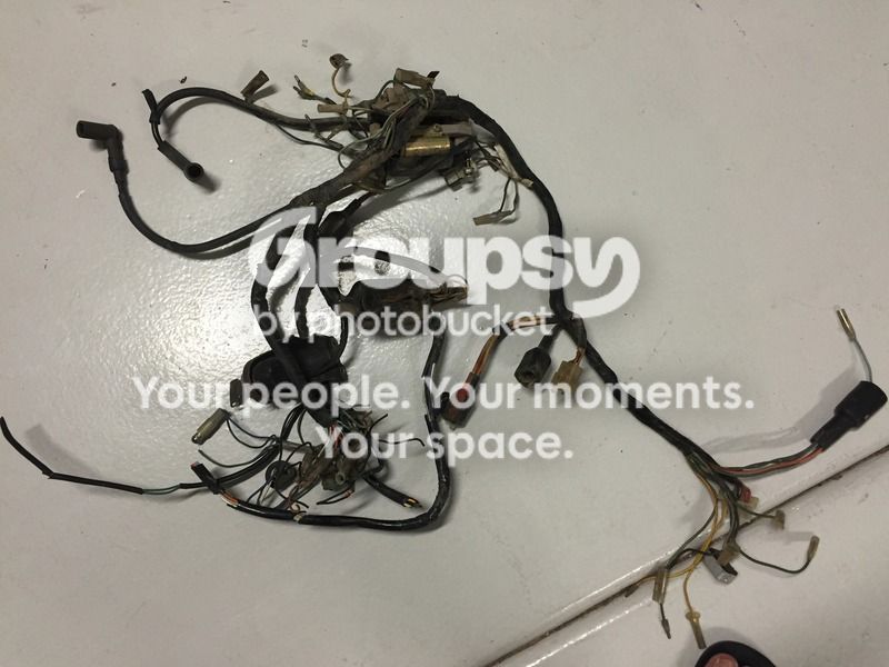

Here it is the day I picked it up. It wasn't running but has good compression. I would soon find out that pretty much all the wiring was trash. No biggie, I planned on a Motogadget unit anyway.
Posing on the new (really old) whip!

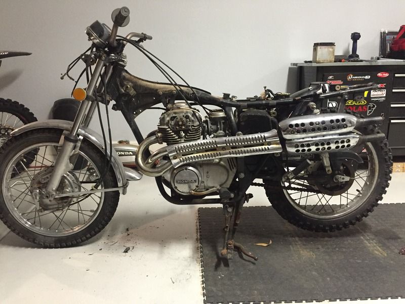

Getting stripped down. Not too bad of shape actually.
We have a roller!

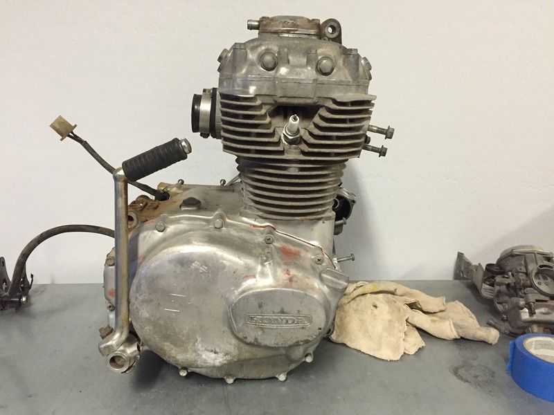

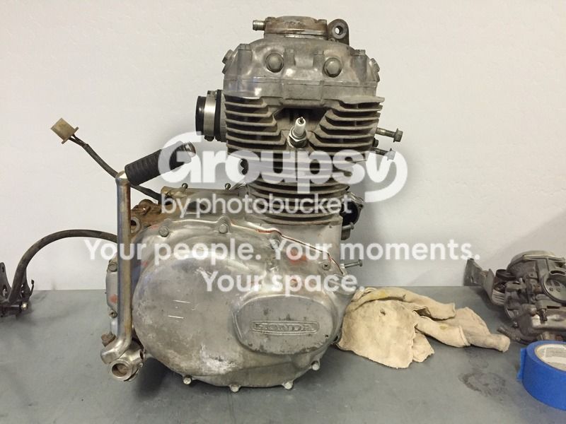

Motor will definitely need some blasting.

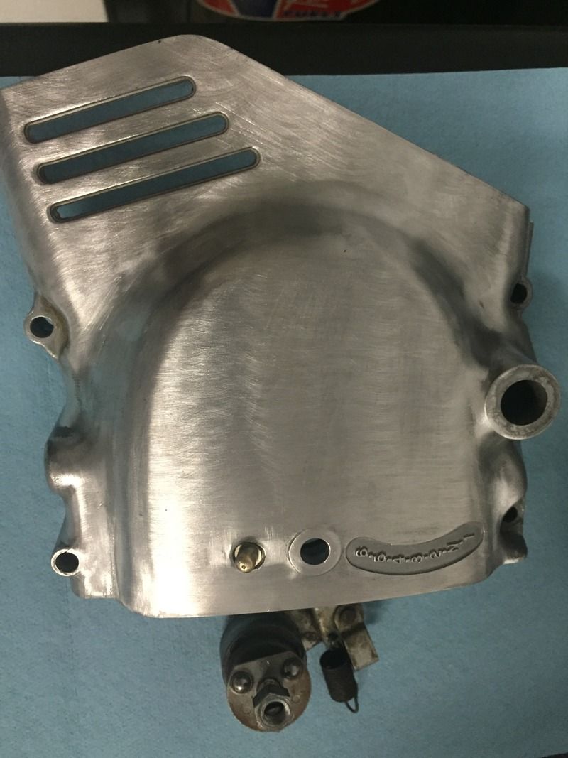

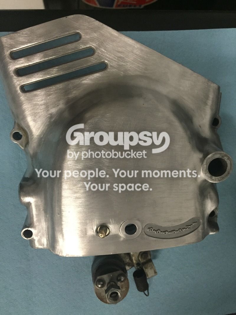

Couldn't resist polishing one piece up just to see how tough it was gonna be to bring it back to life. This piece probably took 15 minutes. Not bad.

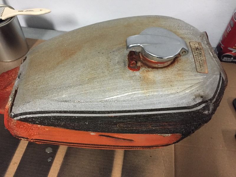

Getting that shitty weathered paint off the tank.
I was hoping I could leave the tank bare and just clear coat it but unbeknownst to me someone had already bondo'd the right side  >:(

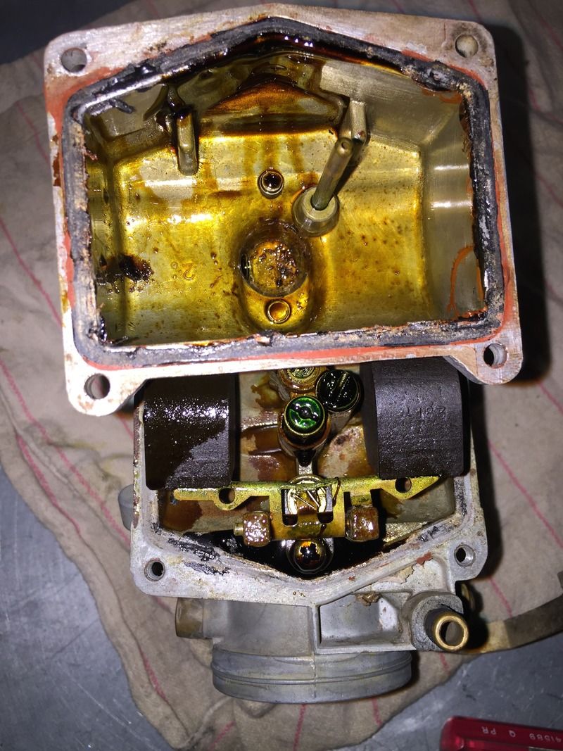

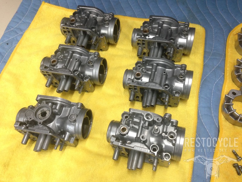

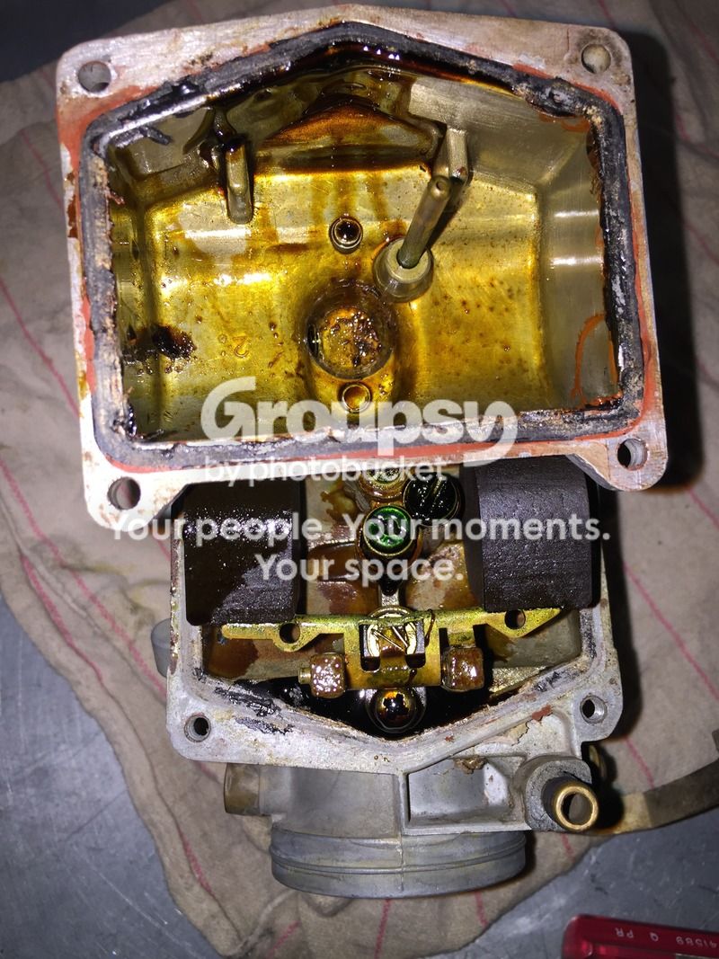

The carbs were dirtier than an Amsterdam madam. This shit was like melted caramel.

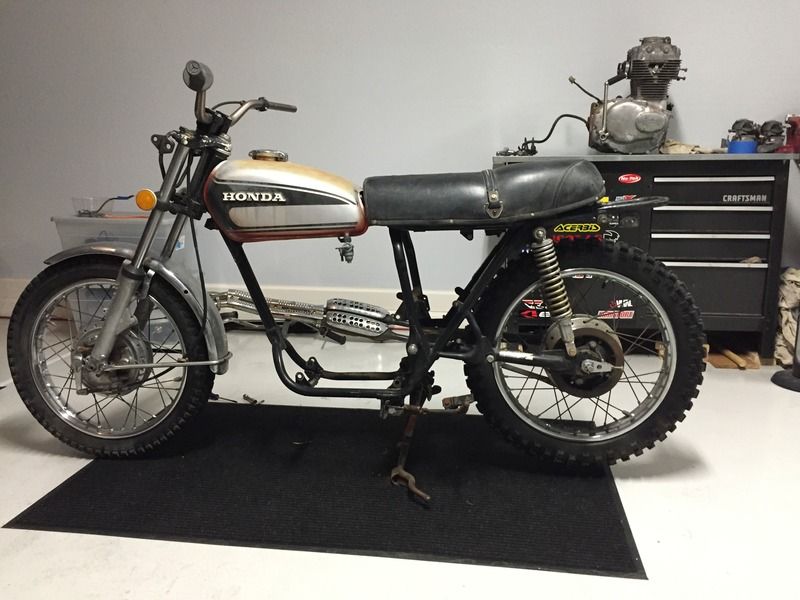

Been a while since my first post. Slow steady progress is the name of the game. I've done just about everything I can do without really spending much. Now it's time to start the spending.
Here's some pics...

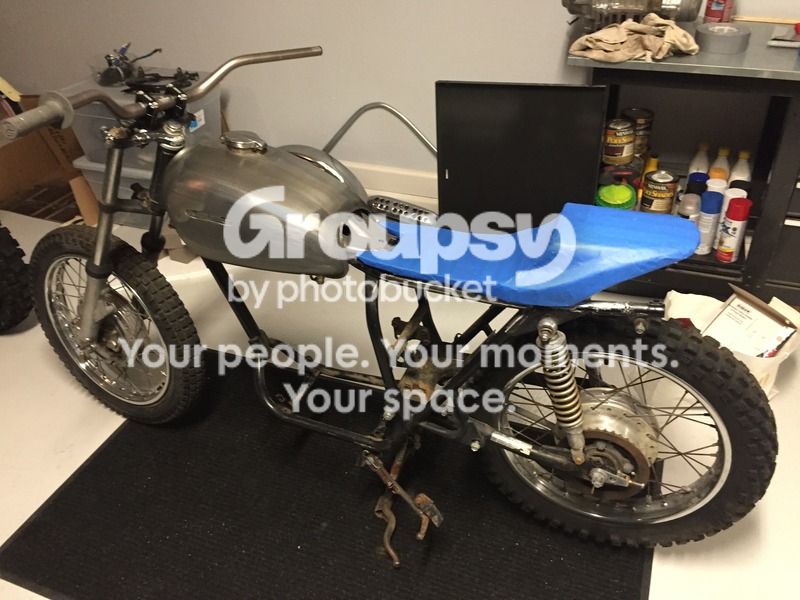

Finished tail mould

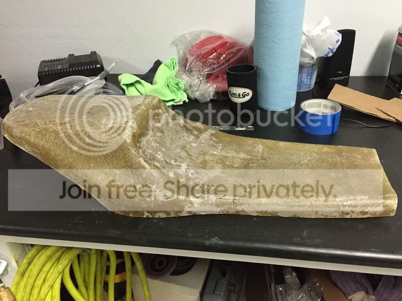

Glass laid up

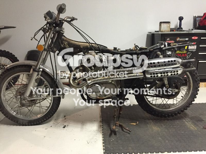

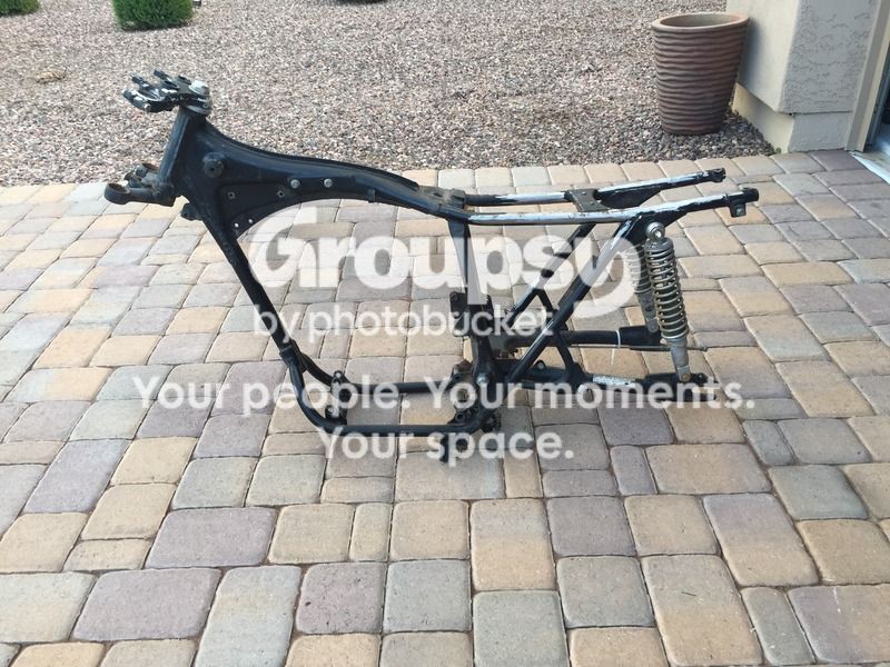

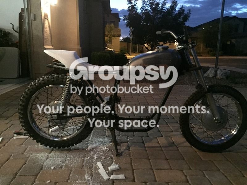

Frame as she sits now

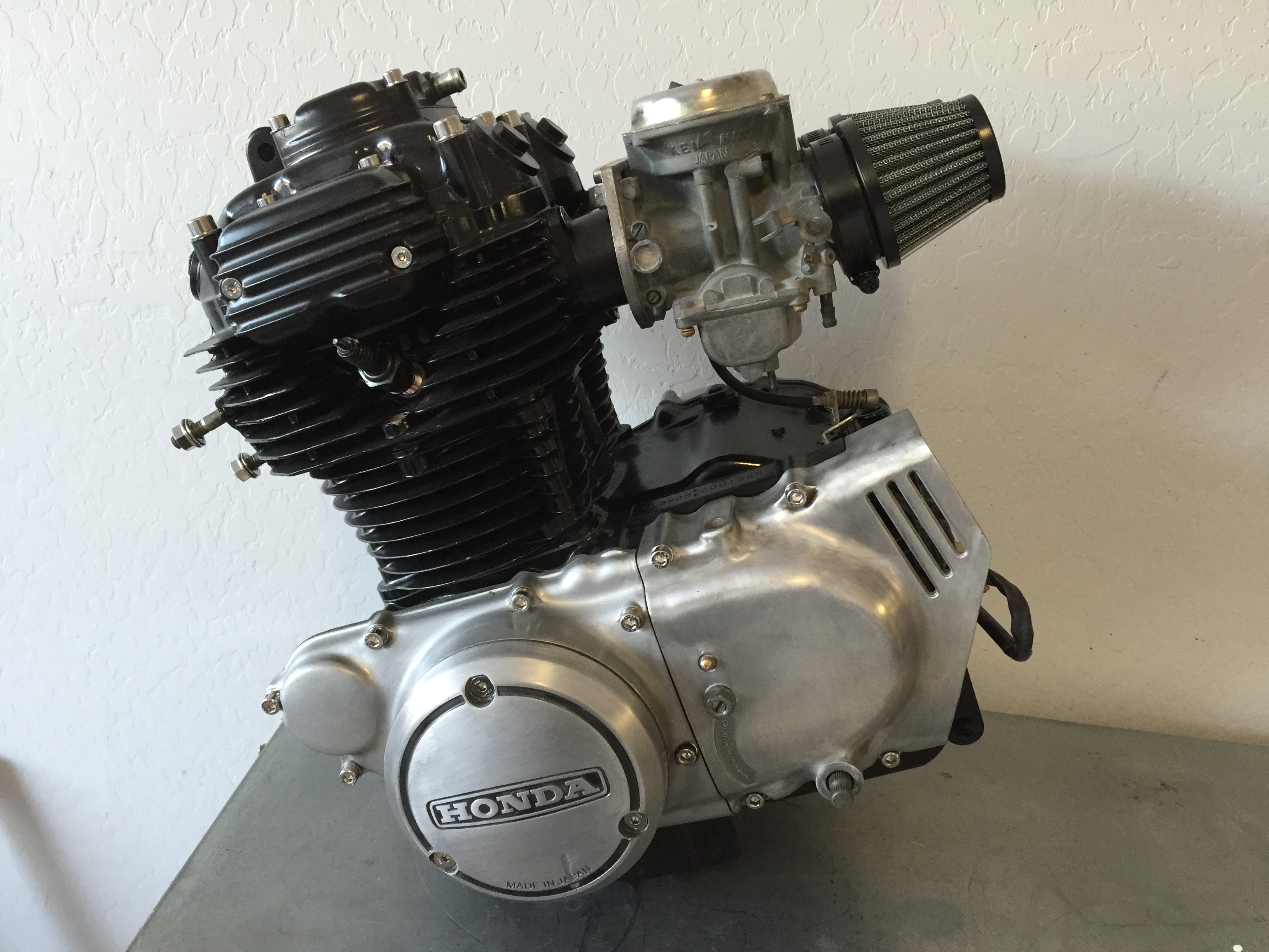

Engine painted

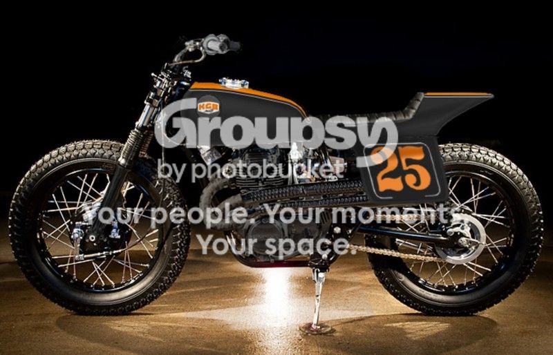

Also found time to photoshop my vision for the bike. Getting there!

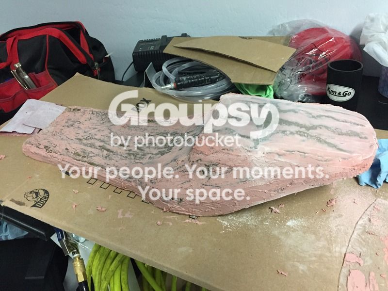

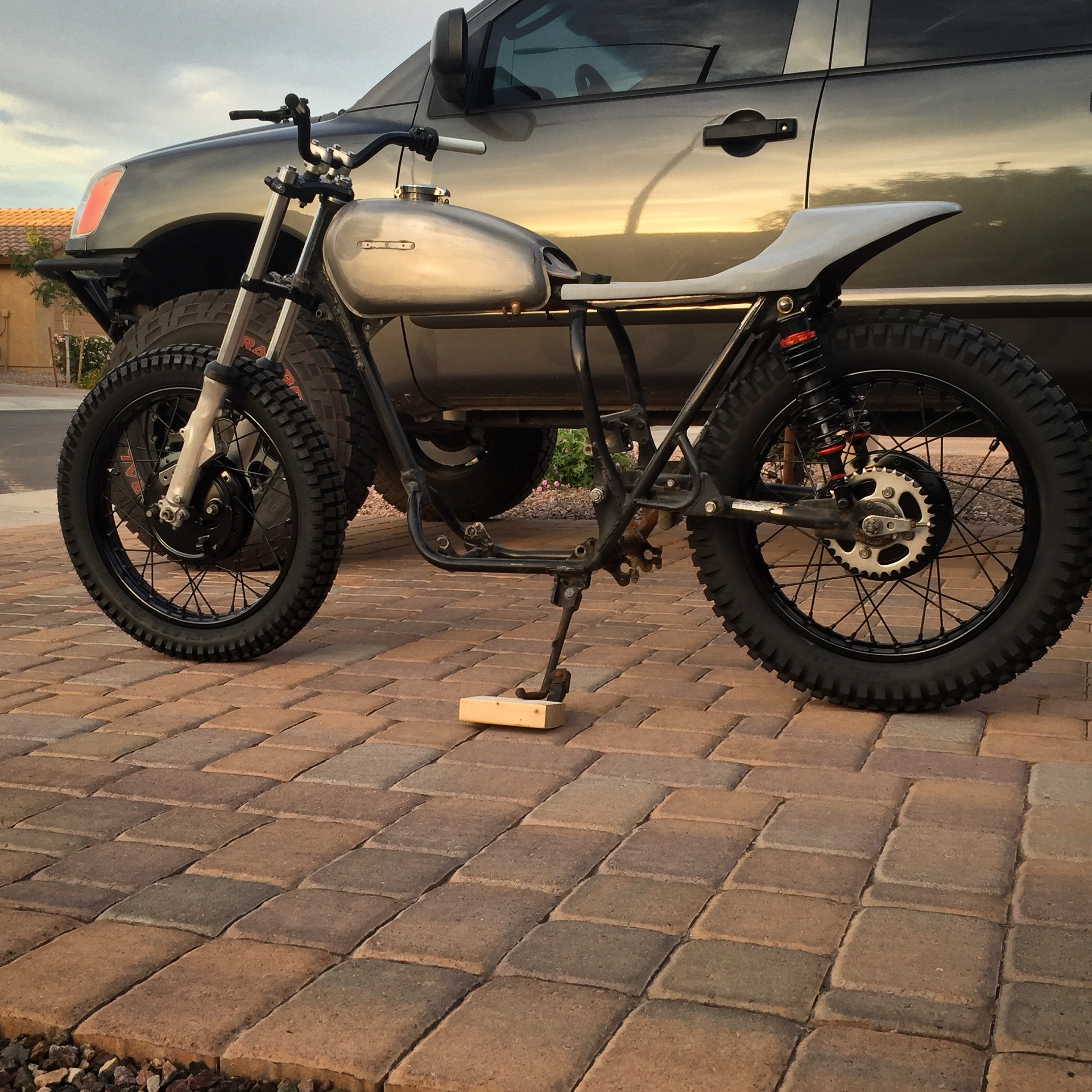

Did some grinding over the last couple days.
First layer of filler on there. Obviously a bit of work left...

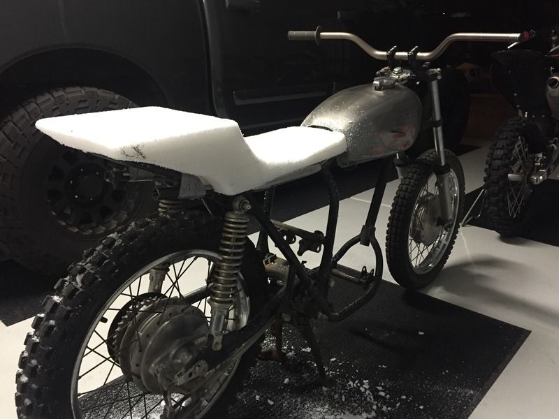

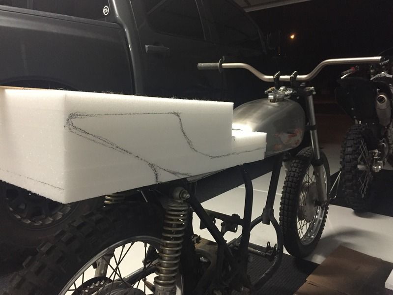

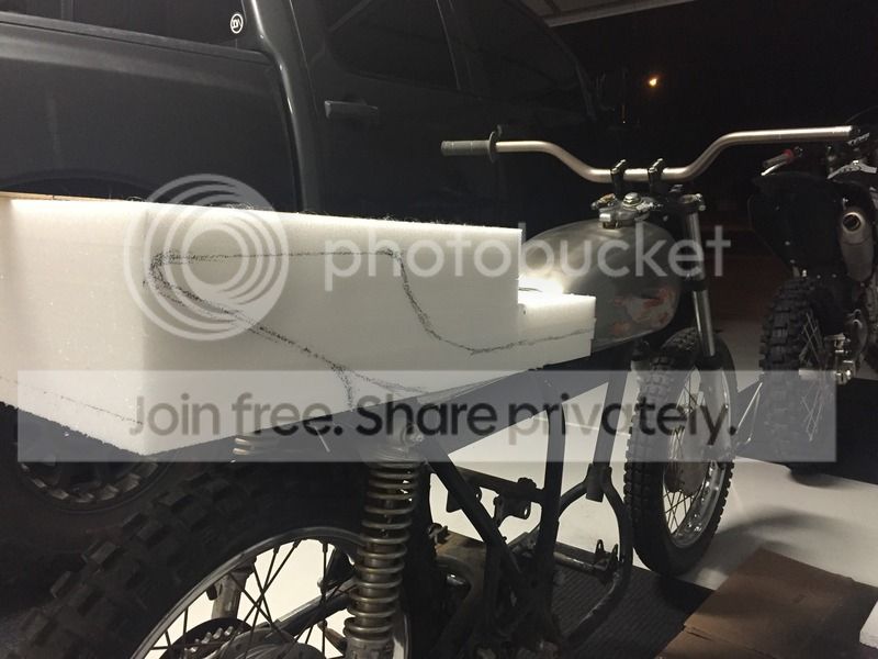

What was that you used to mold the seat?
Everything looks cool man......good job.

« Reply #6 on: Dec 03, 2015, 20:08:35 »
Thanks man! I used some craft foam from Hobby Lobby to form the shape then laid fiberglass over it.

« Reply #7 on: Dec 04, 2015, 06:45:44 »
Thanks, just looked different from others I'd seen.
