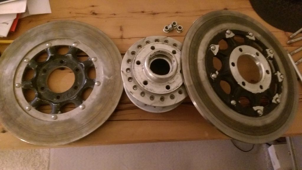

Finally have all of the bits ready to go off to get powdercoated.  I still can't decide between dual disc CB550 front end, or a drum CL450.  So i think I'm just going to end up with both... I guess it'll be a gametime decision and I'll have a spare setup for a future project!
Before...
Hopefully after will be pretty soon...
