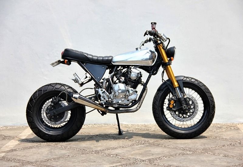

If I can make it look even a little bit like this I'll be well pleased.
