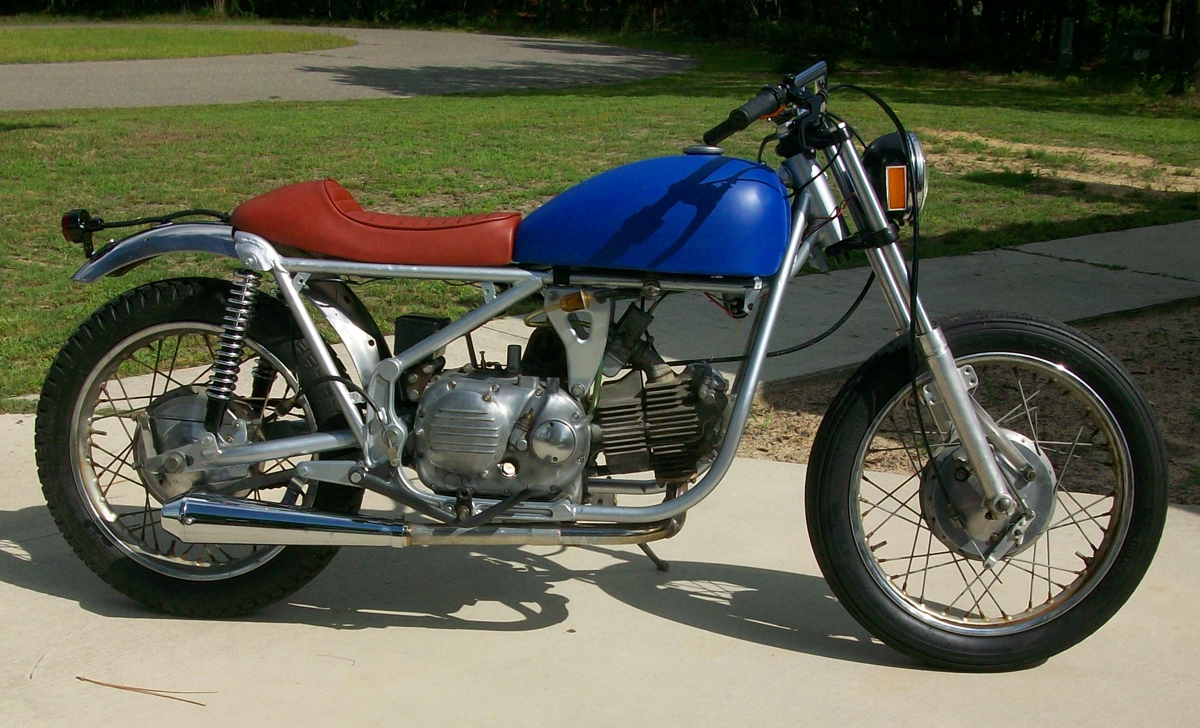

Here is how it looks now
Still needs foot pegs, tires and spokes
The tires that are on it are the original Pirellis
