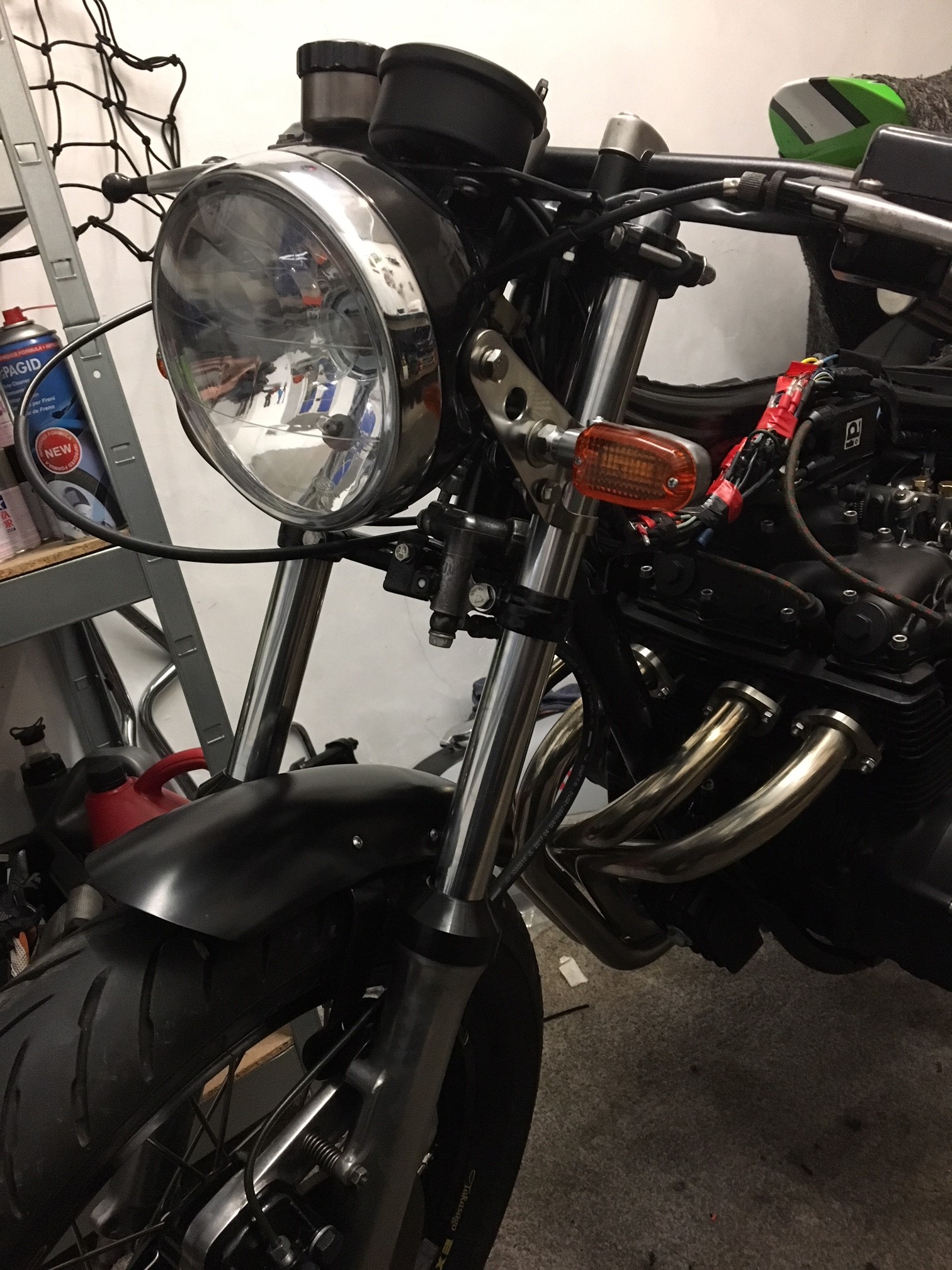

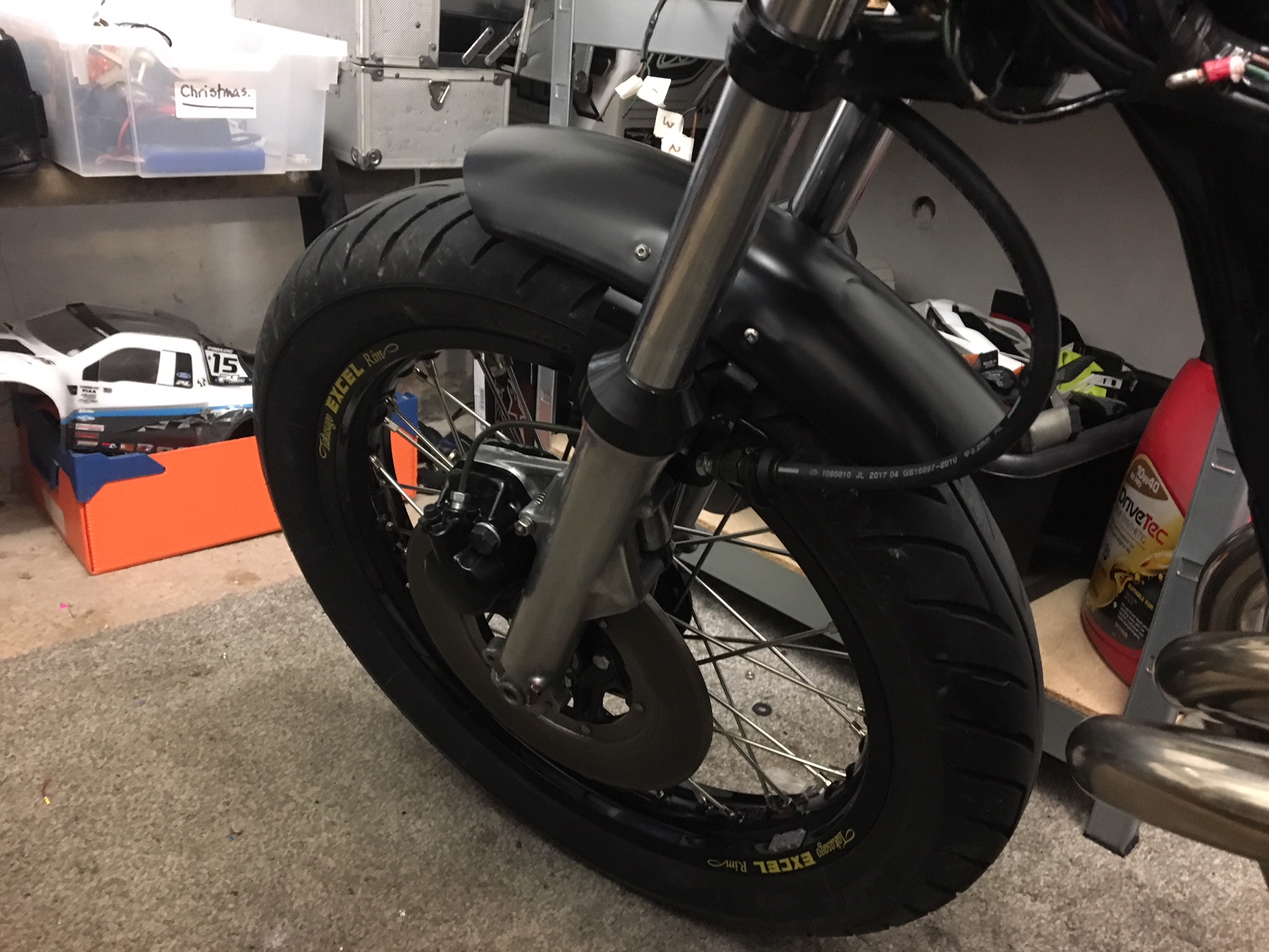

Its been a while.. loads of issues and other projects taking up time. Main issue is it appears the cam tensioner is stuck. For now I have a new cam chain on and everything is where it should be, she runs sweet so I'll crack on for now but at some stage I'm going to need to split the cases. With 2 months to the bike show and the fact she runs beautifully and I won't be doing more than a 1000 miles in a year I'll carry on with the build. So loom is now in, gauge in and all warning lights working. Cut down the front guard, it needs to be lower but cutting the original bracket down is not as easy as thought.

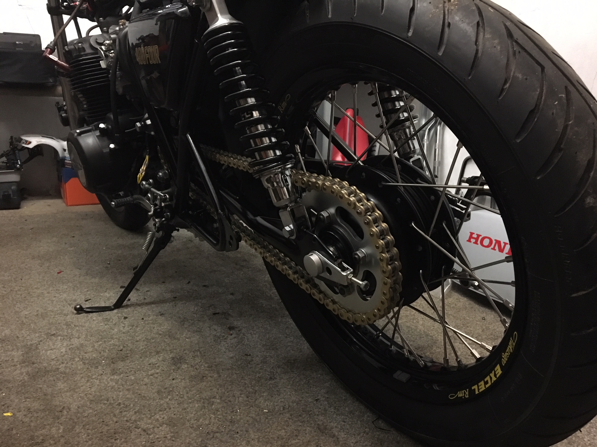

New chain and sprockets on.. really pleased and huge improvement over the stock chain!

So much attention to detail.  So much shine and perfection and then I see that red tape wrapped bundle  where a wiring loom should be.  WTF?
We have all used those crappy red crimp on connectors but they have a horrible habit of coming apart, and they look like crap (IMHO).  Do yourself a favor when you get a moment and order a bunch of waterproof multipin connectors.  You will be happy you did.  I usually use Sumitomo connectors from Eastern Beaver in Japan, but I believe that Sonreir now has taken over Vintage Connections and can supply connectors of the type that were commonly used when our bikes were built. That would take a lot of bulk out of that harness and would look more professional.

Ah well that's just temporary to hold the loom together.. I'm not wrapping it up yet as I have a problem getting charge to the battery and still need to finish some wiring! As for the connectors I've used slim gold OEM type connectors in most places.. the ones you see are for the horn and the new gauge of which I'll be replacing as totally agree and I made a mistake using them they are total crap. The reason it looks bulky is well... there are a lot of wires to sort.. as I have no wiring jumble behind the headlight so this will be neatly wrapped up and hidden under the tank keeping it clean and tidy around the front of the bike..  thats the plan.
