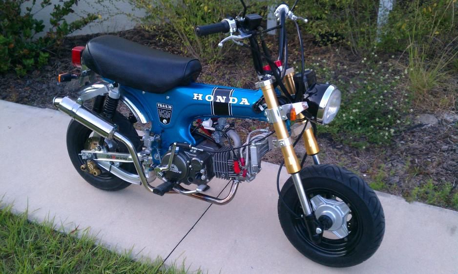

 I pulled this out of the local bike boneyard yesterday. It's rough as a cob, but for only $40 I couldn't resist.
 Almost everything on it is stuck, rusted or rotten, but all I really wanted was the frame and some hardware.
 So far, all I've done is dragged it into the garage....because it won't roll...and sprayed everything with PB Blaster in preparation for disassembly.
 I have lots of questions and could use some guidance. Below is a list of things I'd like to do and a couple of pics for inspiration. Anything you can tell me is appreciated.
 I'd like to do:
 * Fork swap. USD or conventional hydraulic?
 * Front disc
 * Aluminum swing arm, probably the extended one. What do you do about the brake rod and stay with the extended arm?
 * 12" wheels. I re-use my old rear hub. Do the disc swap front hubs accept the 12" hoops?
 * Big motor....140-160cc. Would also like some suggestions on brands/size for this. Lifan, Piranha, SSR, etc.

I'd stick with a stock restoration to be honest.  Having done a GSXR front end swap onto an SR500 I wouldn't waste my time or money doing it again.
They're fetching top dollar in stock form.  I'm embarking on rebuilding my ST90 this winter and planning on going full stock restoration except I'll likely put a Lifan engine in.  The stock motor runs but needs refreshing and I want something clean and reliable.

Check out places like CHP, T Bolt etc. For parts. They do make inverted forks for the CT's but is it necessary? Probably not but it does look cool.

If you swapped forks they would have to be off a pit bike, any sport bike front end would be miles too long and way to heavy.  And then you could just use pitbike disks.

 No way this is worth restoring. I basically have a frame and some hardware.
 That's why I'm looking at fork replacement. It'll be easier to swap that fix what's there.
 And rat_ranger, I'm not talking about "real" bike forks. There are USD fork kits made specifically for these bikes.
