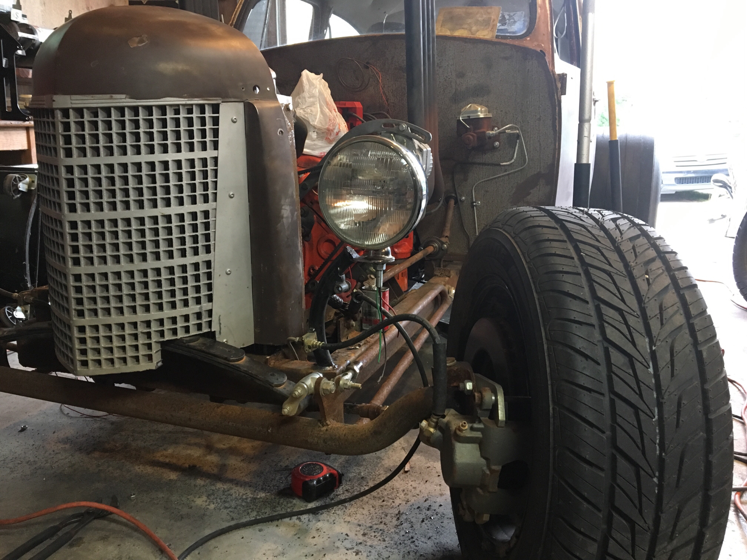

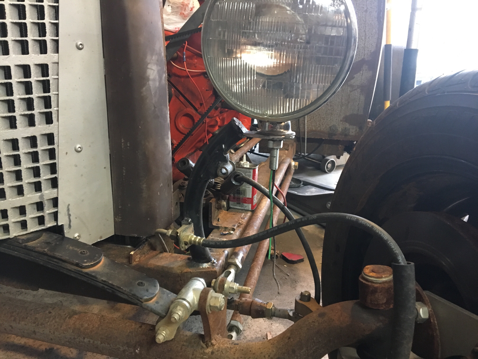

I didn’t like how low the headlights were, or the box tube mount, so I cut some cradle out of a cb750 frame. I have an idea for how that motor mount will tie into the rest of the front end.

SONIC. said:
That thing is ridiculous.
Should be a fun project especially if you can keep it driveable while doing it.
Who the hell thought it was a good idea to do springs and no shocks? Mind blown there.
It weighs all of 1500lbs max, so way more power than it needs. Those springs hold the weight, but it feels like riding offroad on a chopper. He described it as feeling like a go kart, but go karts don't spring like this thing does.

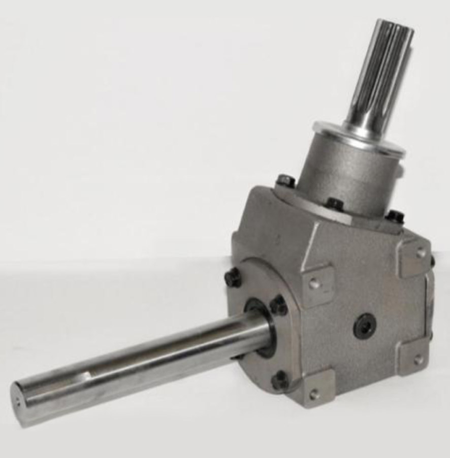

Dig around ebay... Lots of old, cheap and rebuildable angled gearboxes that could solve your steering problem. Like so:

Haha. I may or may not damper the front. I'm more worried about the rear end, as far as dampening goes. I have a set of 4" drop shocks from my C10 when I went to 3", so they alone should stiffen it up a good bit if want to run them. Regardless, a pair of Beetle KYB Gas-A-Just out back will do the job once I get the mounts from Speedway.
