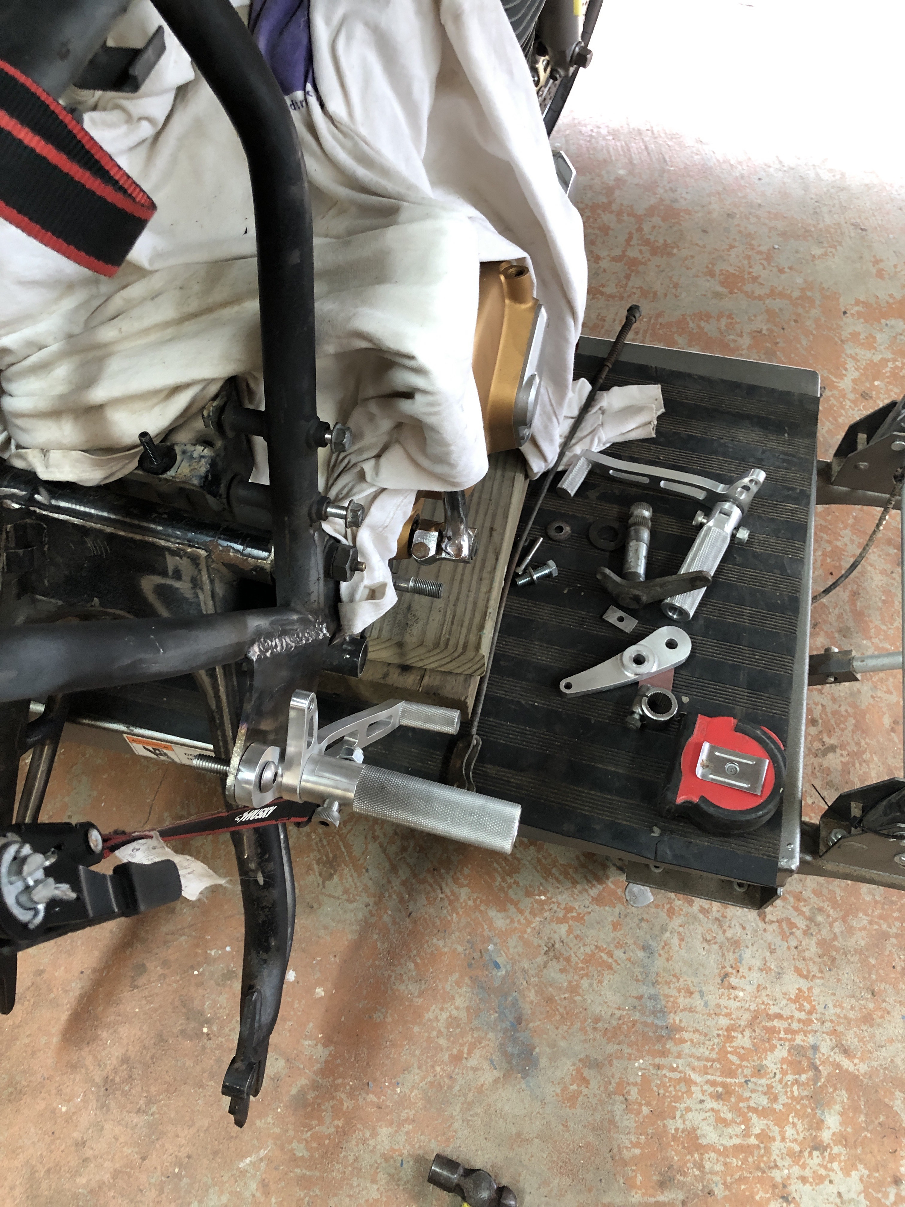

To recap what I have done in the past few months, I have broke my engine down, removed valves, pistons, and cam, heavily cleaned everything that can be seen, prepped and painted the engine, and worked on the frame cleaning it up getting rid of unnecessary tabs and metal(not done yet). No I am just waiting on machine work for the bigger bore pistons and my cam to be returned with higher performance phased and new valve springs. Also some tidbits from 400tt like cam tensioner, new guides, and a couple other nic-nacks.. I'm posting some pictures of my progress so far..
New pistons
Cut off the bottom bike stand
Painting time
