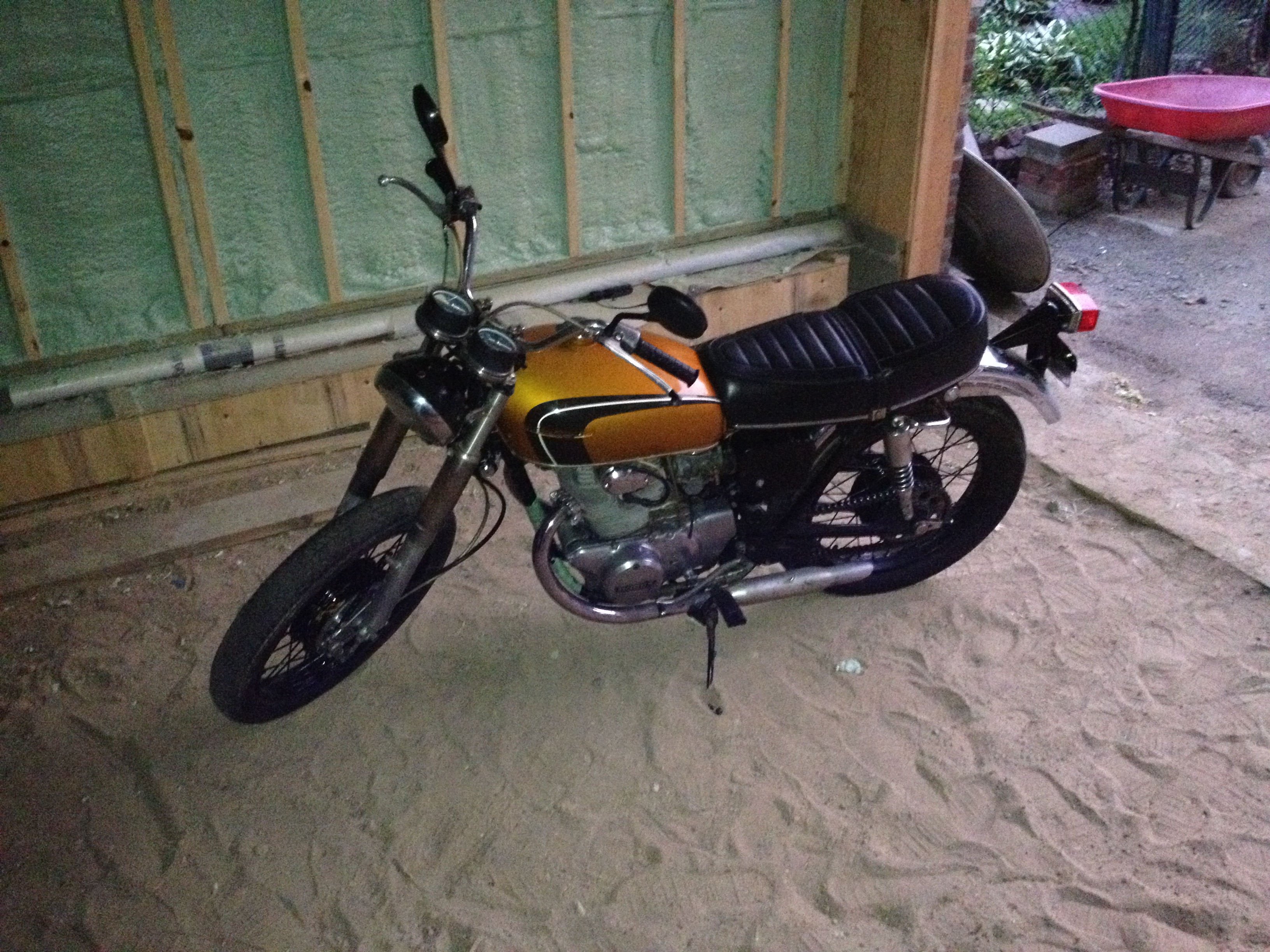

My first build- 1972 Honda Cb350
BCC
About two years ago I bought a 1972 honda cb350 in a box from a guy in Canada. At the time I knew very little about mechanics other then what I have learned in engineering school.(alot of theory very little hands on). Since then Ive put it all together and have it running pretty well. I plan on doing something along the lines of brat. Ill post more picture of the honda in the morning. For now this will have to do. (the last three are the inspiration bikes)

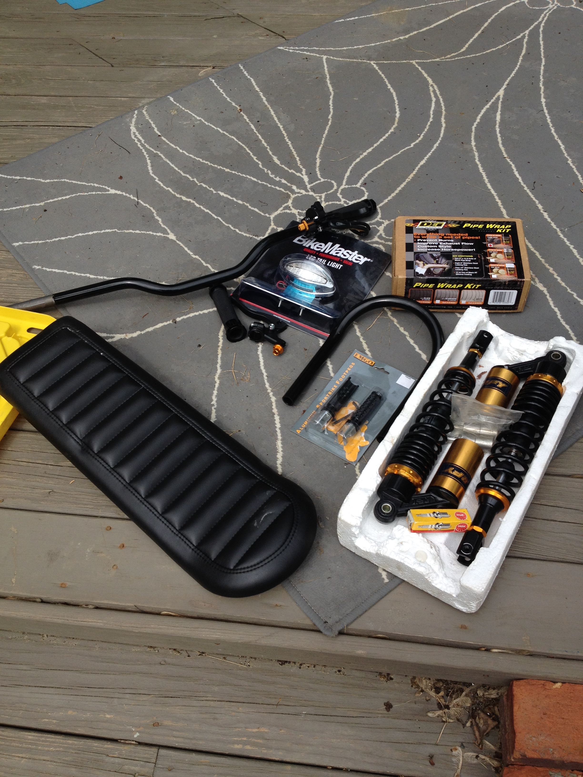

I didnt get around to taking any pictures of the bike as a friend from out of town was here, but i did manage to find a picture of all the things i have bought for the bike.

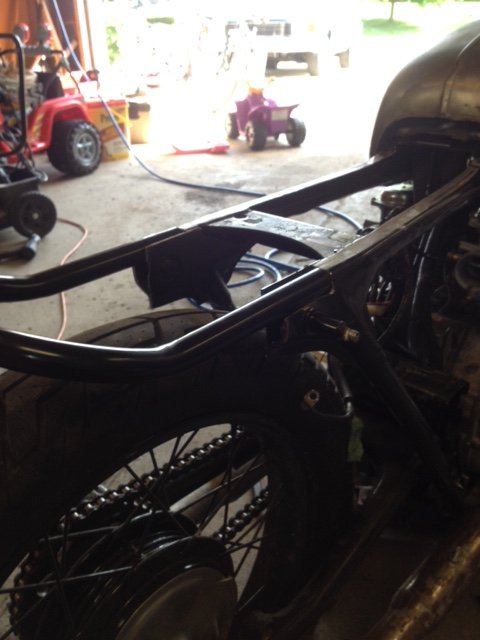

the honda rear wheel comes up higher than the frame so that flat seat wont work
besides unless you are a midget with short legs putting a lower seat on a tiny bike like a cb350 is dumb anyway, i assume you are doing it for some kind of LOOk and stance like you have seen in pitchurs on yer iphone

Okay I apologize for my past posts as they are clearly not going into enough detail :-[. So Ill start all over. I bought this bike back in 2013. That year I read the clymer manual about a dozen times, took the whole bike apart, striped the frame, repainted the frame, checked pressure in both cylinders, set the timing, valves, points, changed the oil etc. In 2014 I had bike running perfectly and rode it all last summer while I was living in ann arbor. I never tore down the engine as I didn't see the need to as the pressure in the cylinders was good and there were no leaks in the gaskets. Being 6' 2" the bike is clearly a little small on me and ive decided that i would give the bike to my girlfriend. This is why i went with a flat seat. So that she could feel more confident on the bike. In the picture it probably is not noticeable but that seat is upswept in the back so i shouldn't have a problem with the back tire.

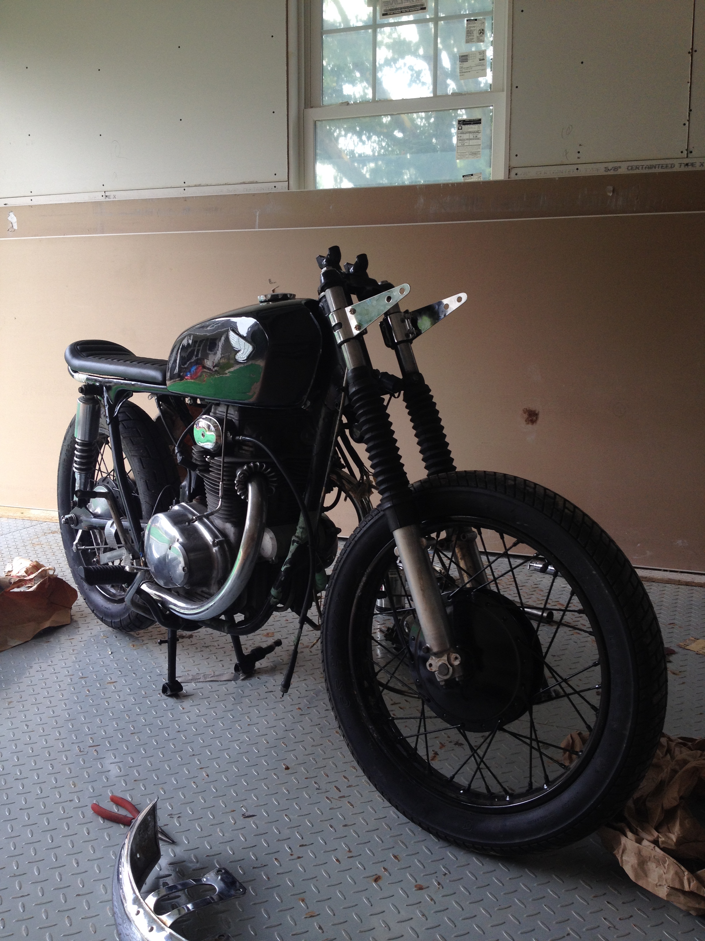

So I am really bad at this build thread thing :p . Anyways been working on the bike for a while now and its "almost" complete. So i decided to paint the tank my self with rustleom and a paintroller and am pretty happy with the results. Also welded the frame up and repaint the subframe.

you say it shouldn,t have a problem with the back tire but it does.it comes up higher than the frame tubes.the upsweep at the back is not the issue.it is the seat flat on the frame where the goddam tire goes when it hits a big bump.that is asuuming the shocks you are buying for your girlfriend are of high quality to give her a SAFE compliant ride.you needed to maintain the same clearance as with the stock rear fender
Well I am running 13.5 in shocks which are about an inch more in clearance. I assume that will be fine but ill make sure and measure the travel.
And if that doesn't work out ill have to extend the swingarm. (though i will avoid this if i can as i dont want to slow the steering of the bike)

suspension needs to be set up per rider weight, once in a while all travel will be used when this is done . if he cares about the safety of his girl he will set up the suspension correctly
