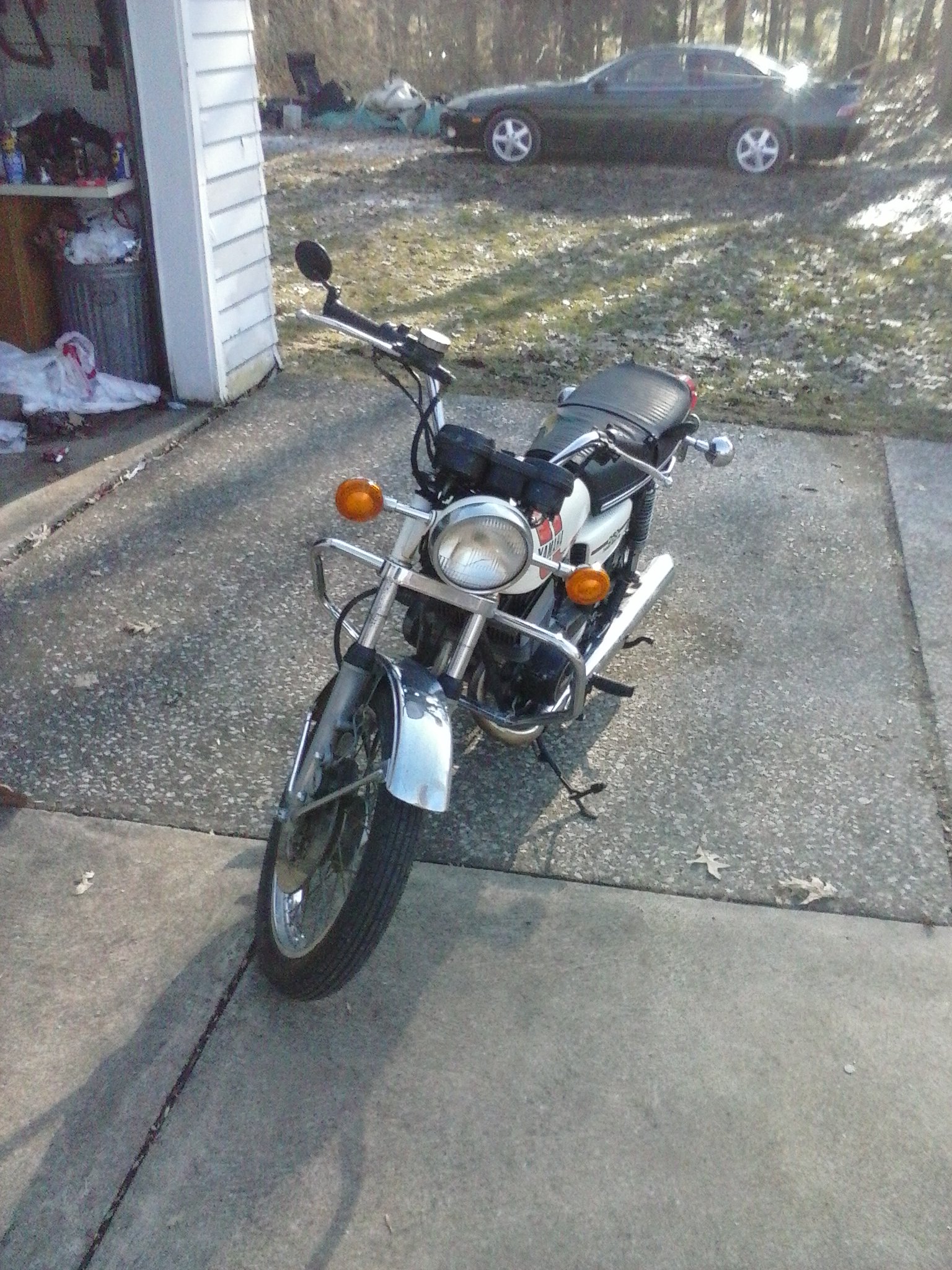

Got quit a bit done the last 2 days, but found one of the brake shoes had unlaminated and the wheel bearings are not doing too well. since i had the rear wheel apart i gave the sprocket, the cover the sprocket attaches to and the drum cover a QUICK buff. the rest of the bike is grungy so i wasn’t going to get them perfect, but they look a lot better. hopefully my wheel bearings get here tomorrow and ill be able TO FINALLY get her inspected.
Re: 75 RD 250 - poor mans hooligan/tracker/dual sport Hybrid
finally DONE. just needs an inspection.
as far as mods, i have the following planned.
-RD400 tank
-"made in japan" mil. surp. aluminum canteen re purposed as oil tank.
-minor chop to rear fender
-modify grab bar to follow line of the seat and de tab it
- modify RD400 tail light assembly to fit chopped rear fender
