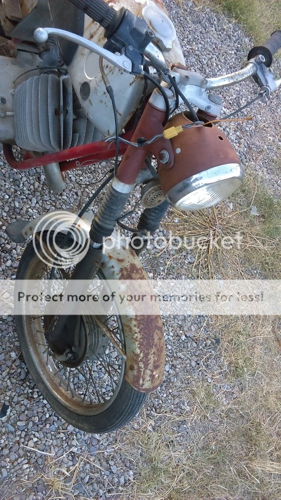

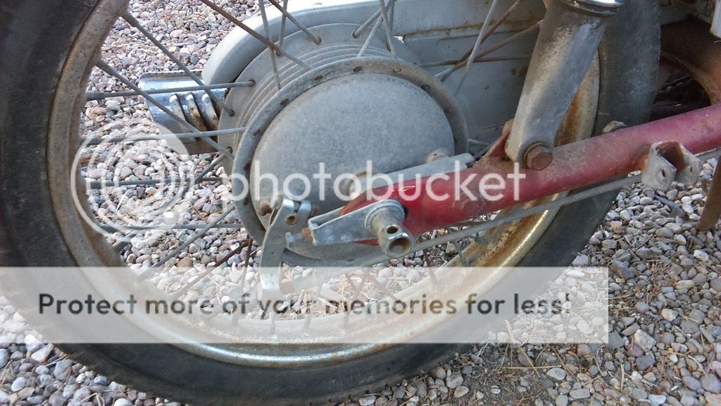

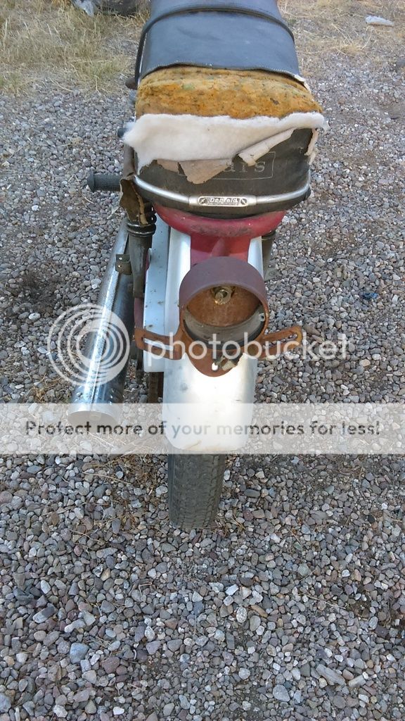

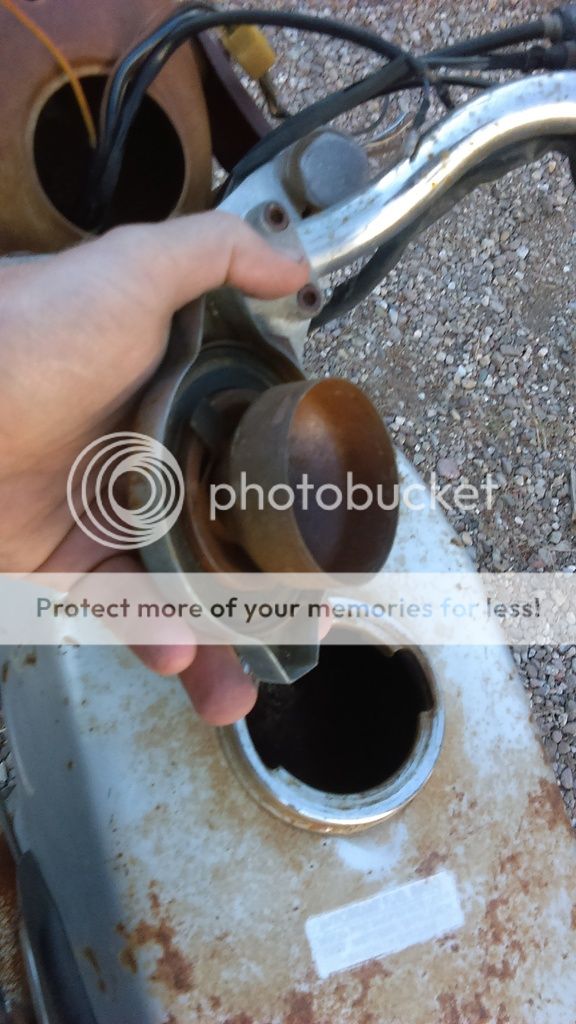

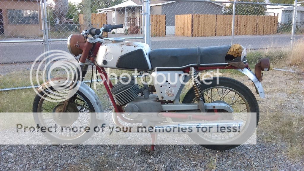

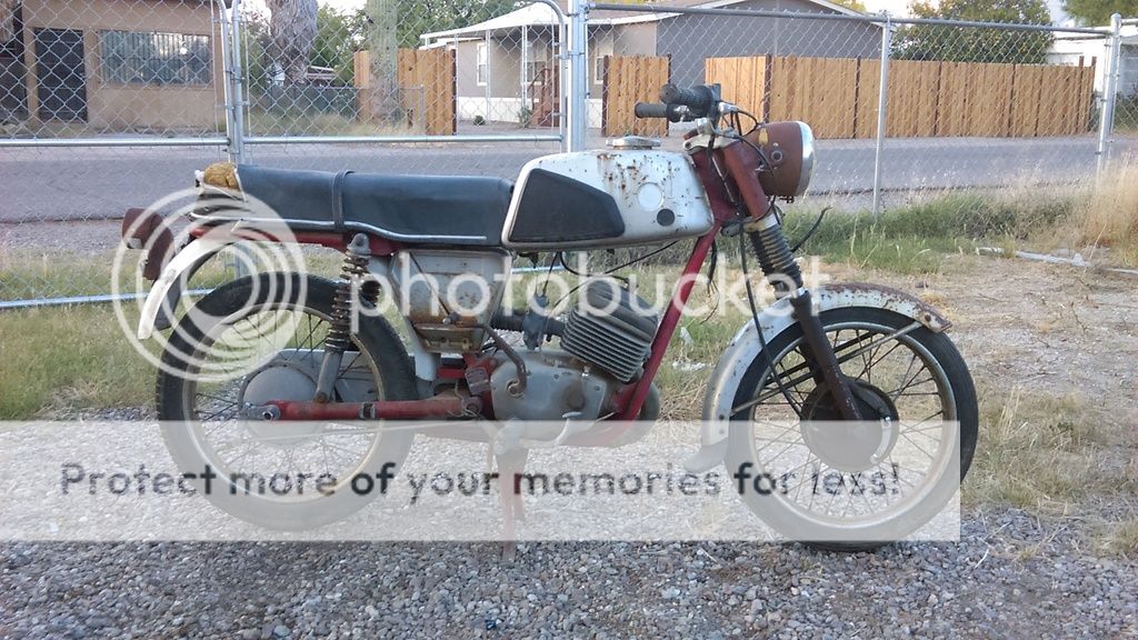

But enough of that, heres the pictures!

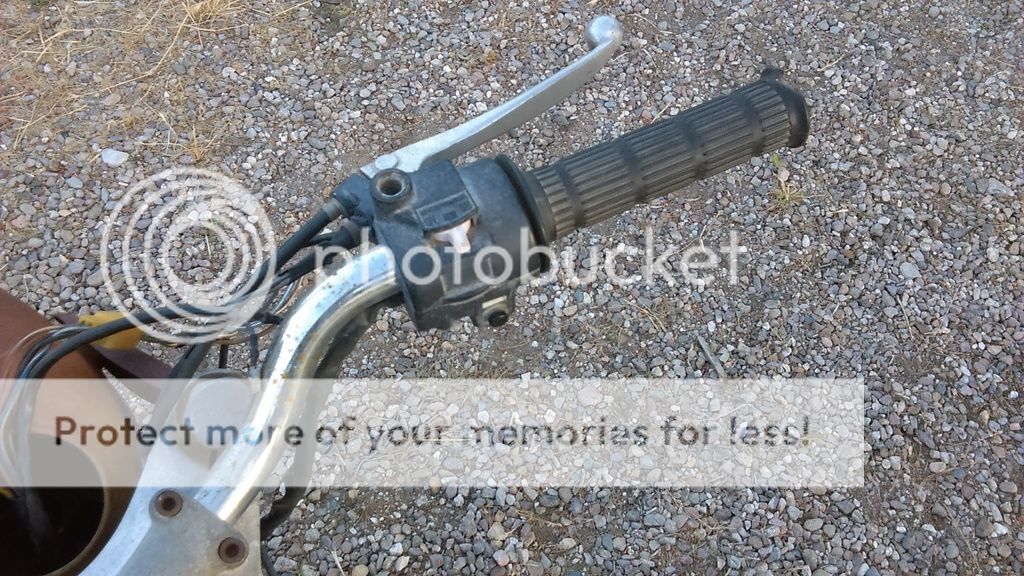

Fixed with brass
Something tells me that is not the stock control

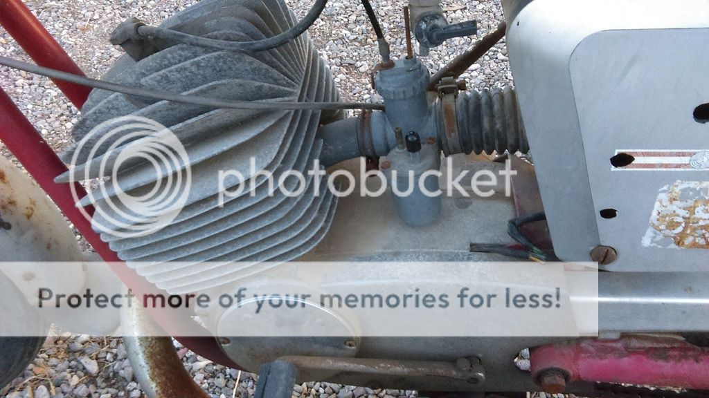

On the side it says, add three cups per one gallon of gas
Ive got some work ahead of me. Its going to go real slow as i have a GT550 im currently working on as well
