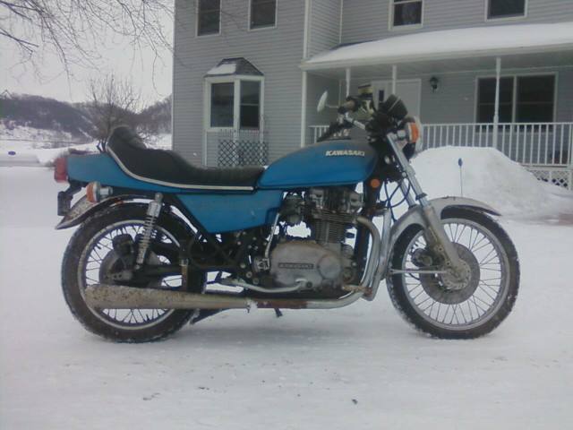

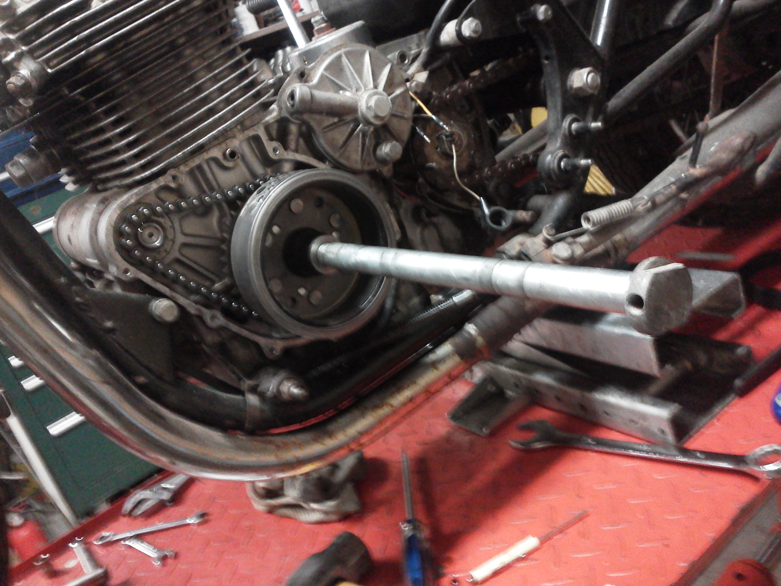

Here we go. First pic is the day I bought the bike. Today I finally put it up on the bench to start the project. Pulling the flywheel off to replace the starter clutch. I still don't have it off. Since I don't have the proper puller, we are using the rear axle as suggested in a few other forums I've been reviewing. Threads right in. I gave is a few whacks with the BFH and it didn't budge. It's under load right now and hopefully I won't have to bust out the hot wrench. We'll see what happens over night. Any suggestions from you savvy folk?

I wasn't able to get the rear axle trick to work either. I pounded on the end with a sledge and the generator didn't budge. In the end I sprung the mere $18 and bought the rotor puller tool, put it on an air impact, then drove that sucker out. You can get the tool from z1enterprises.com.
When you put it back on, make sure to clean the tapered crankshaft end with acetone or alcohol, put blue loctite on the reverse thread bolt, hold the generator/flywheel with a plumber's strap wrench, then torque it down as hard as it will go. The torque spec in the manual is not sufficient and the bolt will come undone. That will leave you stranded (ask me how I know) or, worse, throw you from the bike when it causes the engine to seize.
I wound up fabricating a tool to hold the flywheel by the two holes in the side in order to impact it down as tight as possible.

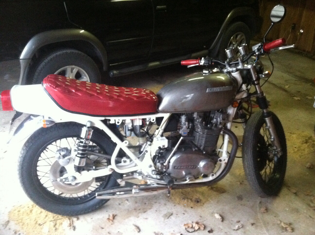

Btw, here's what came of all my efforts. I call it the Beesticorn, part wildebeest, part unicorn. I hope this pic posts ok...
More work has been done on the Kawi. Will post pics soon. I got the flywheel puller via UPS yesterday and 2 seconds with the impact popped it right off. Found one of the starter clutch springs all tweeked. Assembled the contraption with some new starter clutch components and that's done!. I pulled the engine out of the frame and really started looking at what needs to happen for the engine build and chassis mods. One simply complicated question I have is where to find some over sized pistons. I plan on pulling the top end apart and cleaning everything up. Not sure if I will even need larger pistons but just trying to stay ahead of the game. I've found a few o/s pistons on ebay but they are few and far between. I would be buying pistons from separate sellers because everyone only has 1 piston... Once it's apart I'll know what size to get and hopefully I'll be able to match up some part numbers. That is unless you folks know where to find some. Stay tuned, shit's about to get real!

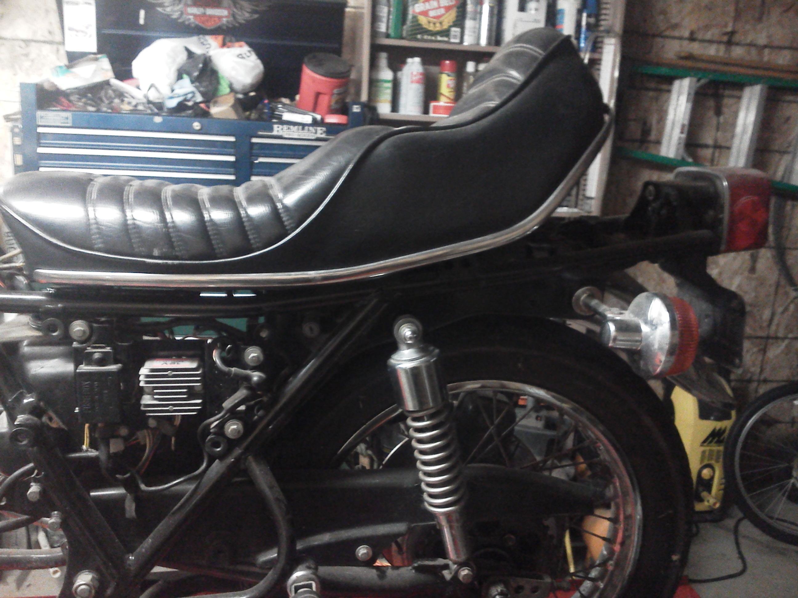

The engine is on the bench ready for a freshening. Starting to really look at some styling options.
I'm thinking taller shocks in the rear, and doing the pvc spacer upgrade in the front forks.
Looking at cutting off the rear fender and welding a hoop in. New or modified seat and modified front and rear fenders.
There's so much more to do to this Slow and steady it's moving along. :)

In relation to using the rear axle to remove the rotor, you need to have part of an M6 bolt inside the crankshaft end to "load up" the axle. Then you tighten the axle down on this bolt and give it a whack.
Worked first time on my old GS450 ;)

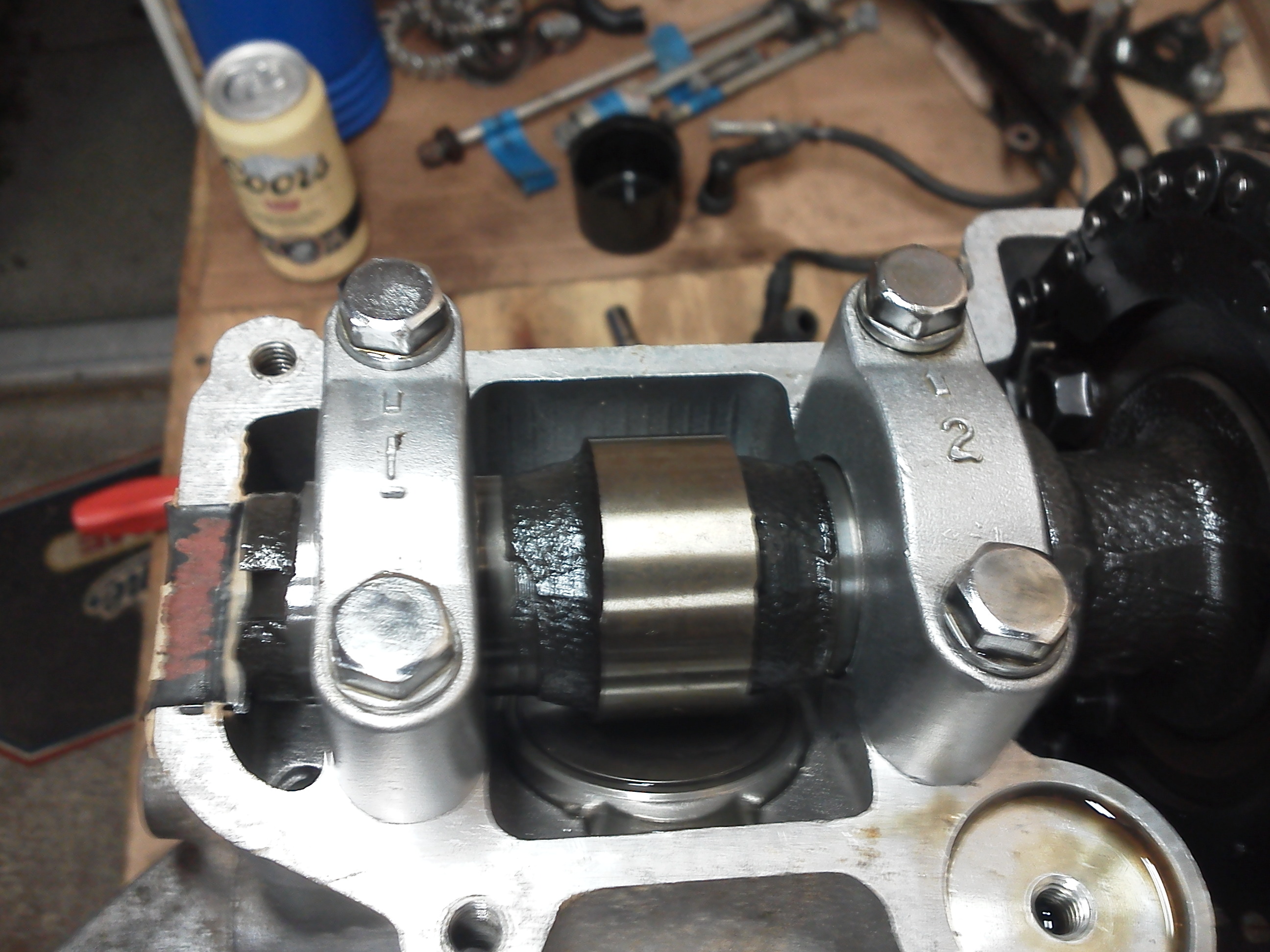

We have just a little progress. The top end came apart nicely. Got my hands on some measuring equipment and went to town. We are just past our service limits on the cylinder diameter and way over on the piston to cylinder clearance. Looks like we're going to bore it over and get some O.S. pistons. I foresee lots of scraping and cleaning in my future. :)
Oh yeah here's a few pics.

That is a truly amazing link and you can bet your ass that I'll be giving them a call. Just a little update on the progress. Took the cylinders to the hone tank and cleaned them up. After a re measurement and a second pair of eyes, we determined that we are well within our service wear limits. The pistons are still shot, but new standards will do the trick. Thanks for the link Armaund!!
