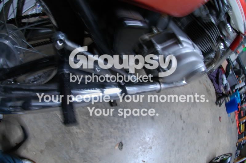

As I said it took about 5 weeks to sort out as a first timer. I used the factory exhaust mounts to support some custom aluminum brackets."I installed these when I had the clubmans on...so, I didn't really know where the pegs should end up. Then I actuated the linkage via the factory linkage. I sawed off the original brake pedal and kept the rest of the linkage. This allows you to use the stock brake switch and you can also keep the factory exhaust. I am still working out how to beautify the setup but it works. Here are some pics.
Also, pardon the distortion, I was using a "fish eye" lens.
