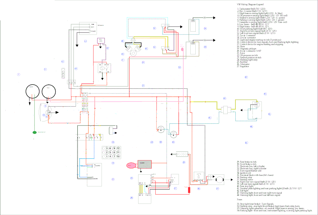

Had a quick tinker this afternoon, ripped the loom out. What a complete mess. How the hell this bike worked is beyond me. Dodgy loose corroded spade connectors, earth connections onto painted frame, electrical tape all over the show. Poor show. Stock loom is needlessly long too, looks like there's a section with a huge loop in it. Looking forward to rewiring it with custom loom and updating electrics. I like electrics!
Current plan for loom, its not right yet but I'm getting there

Got the breather set up sorted. And finished the wiring diagram! Made a sheet metal bender out of scrap wood so will try and get an electrics tray knocked up tomorrow
