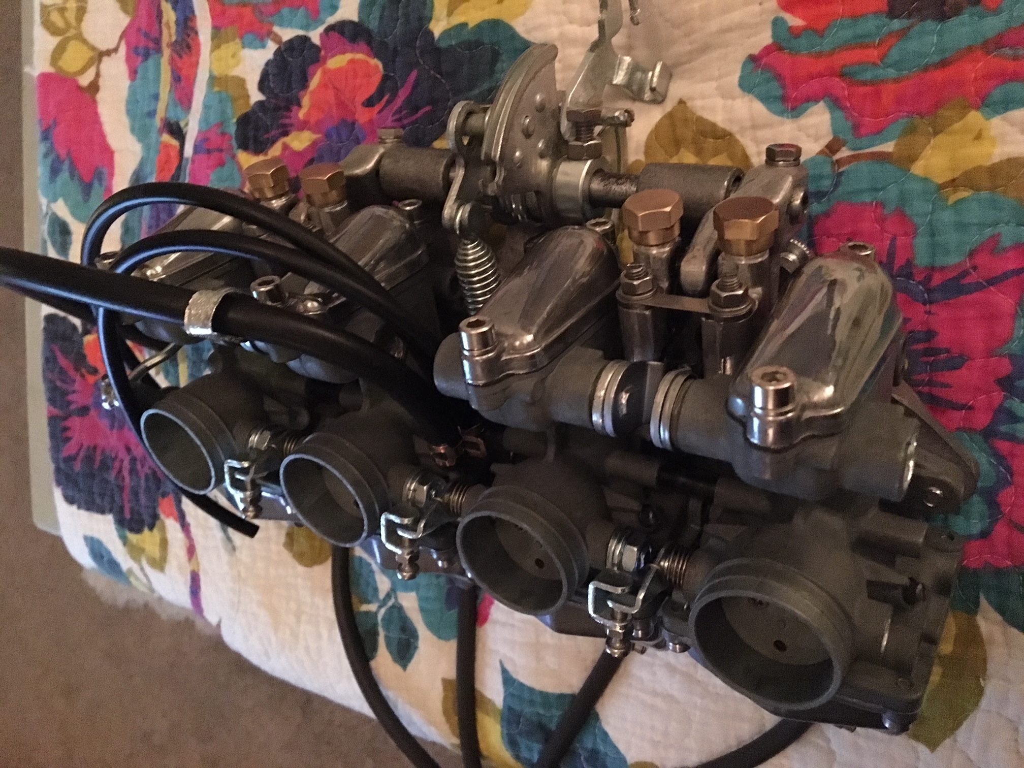

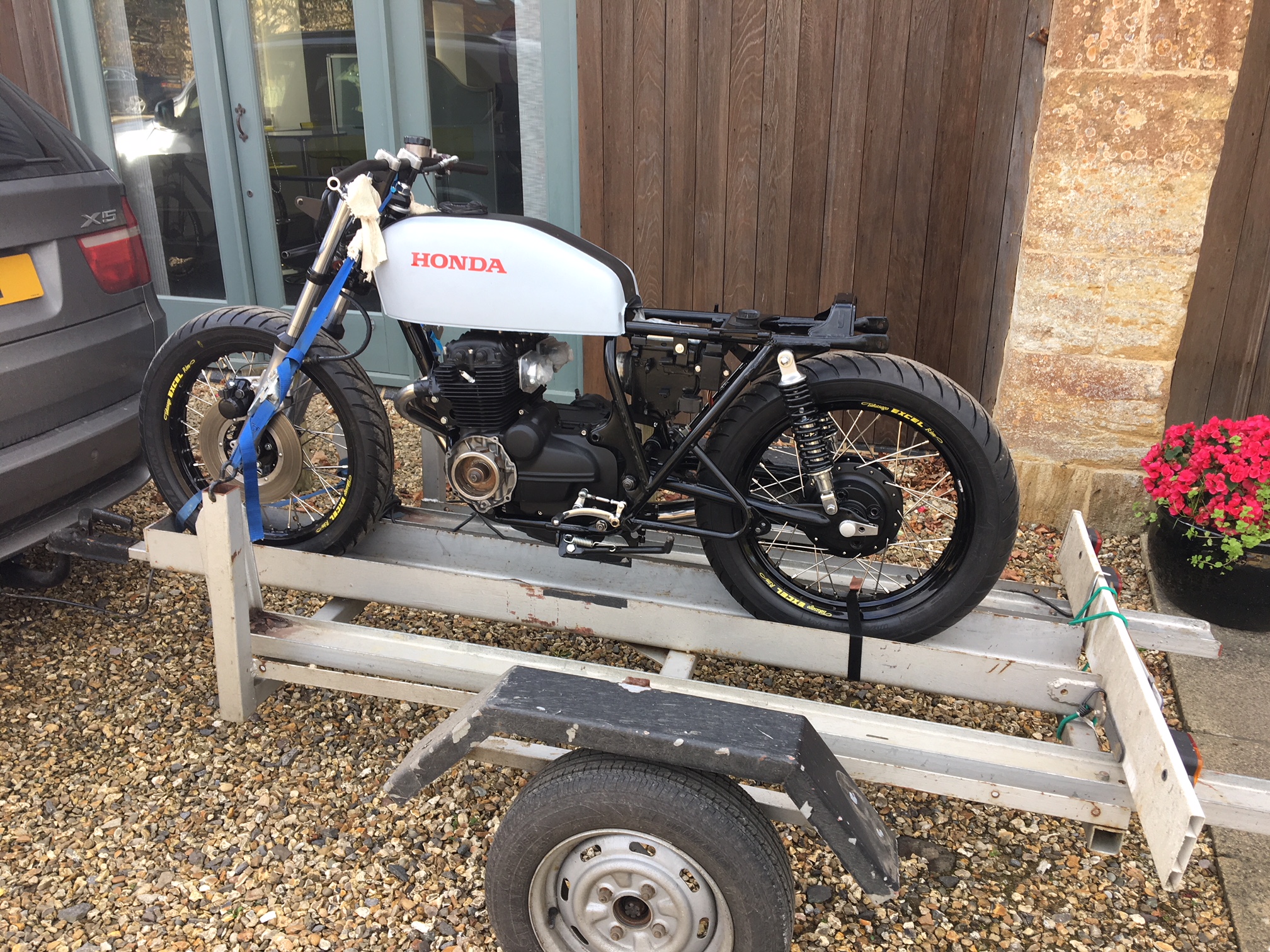

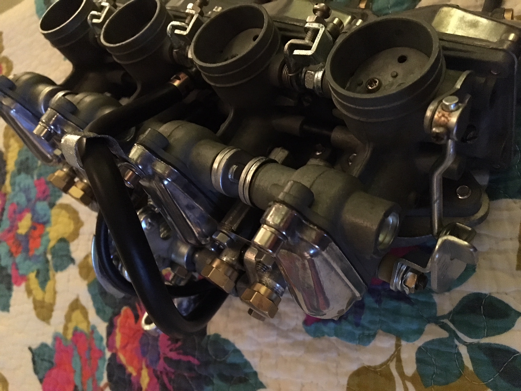

Well a quick update on the build... like all projects.. I've now gone back two steps.. the engine paint isnt fuel proof it seems, so its back out again and 4 bolts in the head need helicoils. Also the front mudguard bracket is causing me trouble... as lowering it by taking a section out simply isnt going to work..  The bracket is good so I'm going to leave it for now , it sits a little too high for my liking but we can address later.
On the positive the carbs have turned out amazing and are as good as new internally.
The Delkevic exhaust it seems was designed for a 75 - 77 , they are going to help with the issue or I'll make a bracket of some sort. I've now shorted the seat base.. which has turned out well... CB400f owners will curse me.. but the std seat is sooo long!
It was good to get the bike out in daylight.. still unsure on tank color.. so it can stay as is until I decide. Next job, modify the airbox to hold the new regulator. Once the engine is back from paint we can get cracking and back together at start to make progress as most of the work is now done, but run out of funds till next month now so electronic ignition will have to wait.. I can at least get the wiring loom in place.

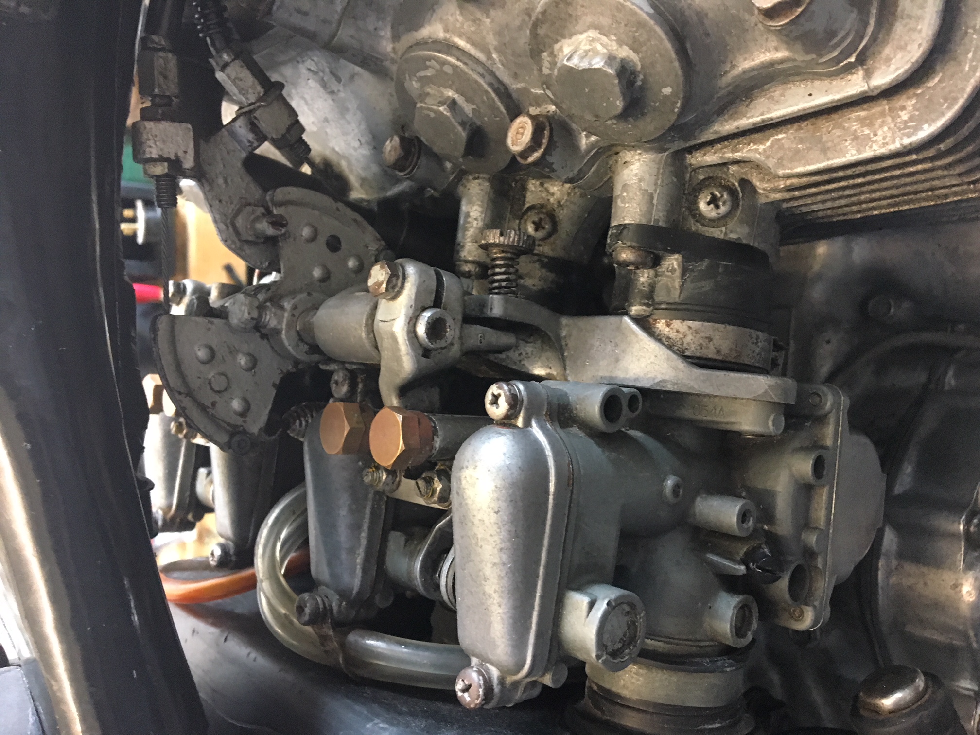

Just when I was getting a bit demotivated at the cost and time of this build I found this old picture of the carbs and engine at strip down and realised how far we've come..!
